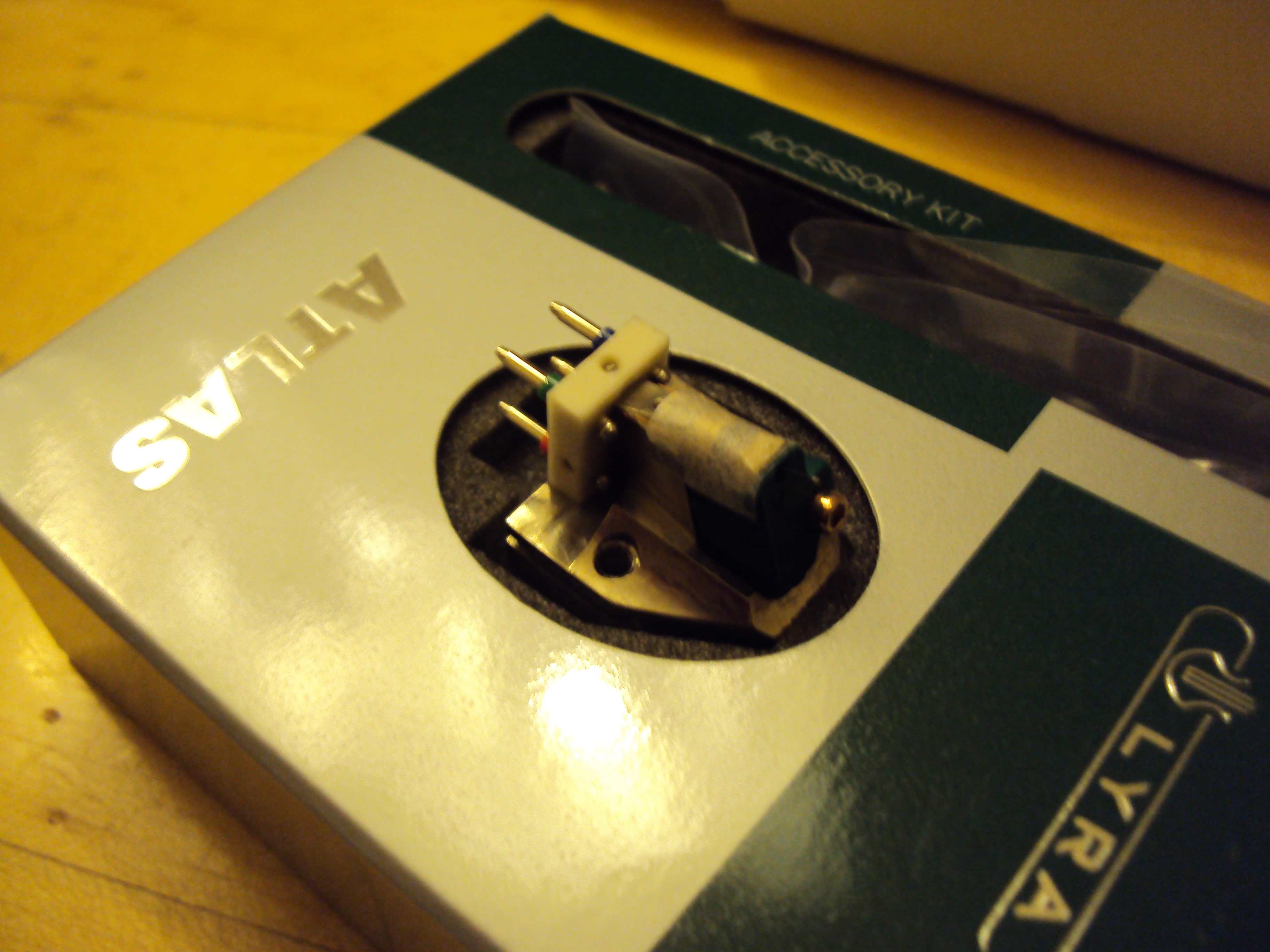

I have a new toy, a Lyra Atlas.
I have heard this piece of art in many systems and have used it on shows but this is the first time i have it at home.
I will mount it tonight and i am very excited.
