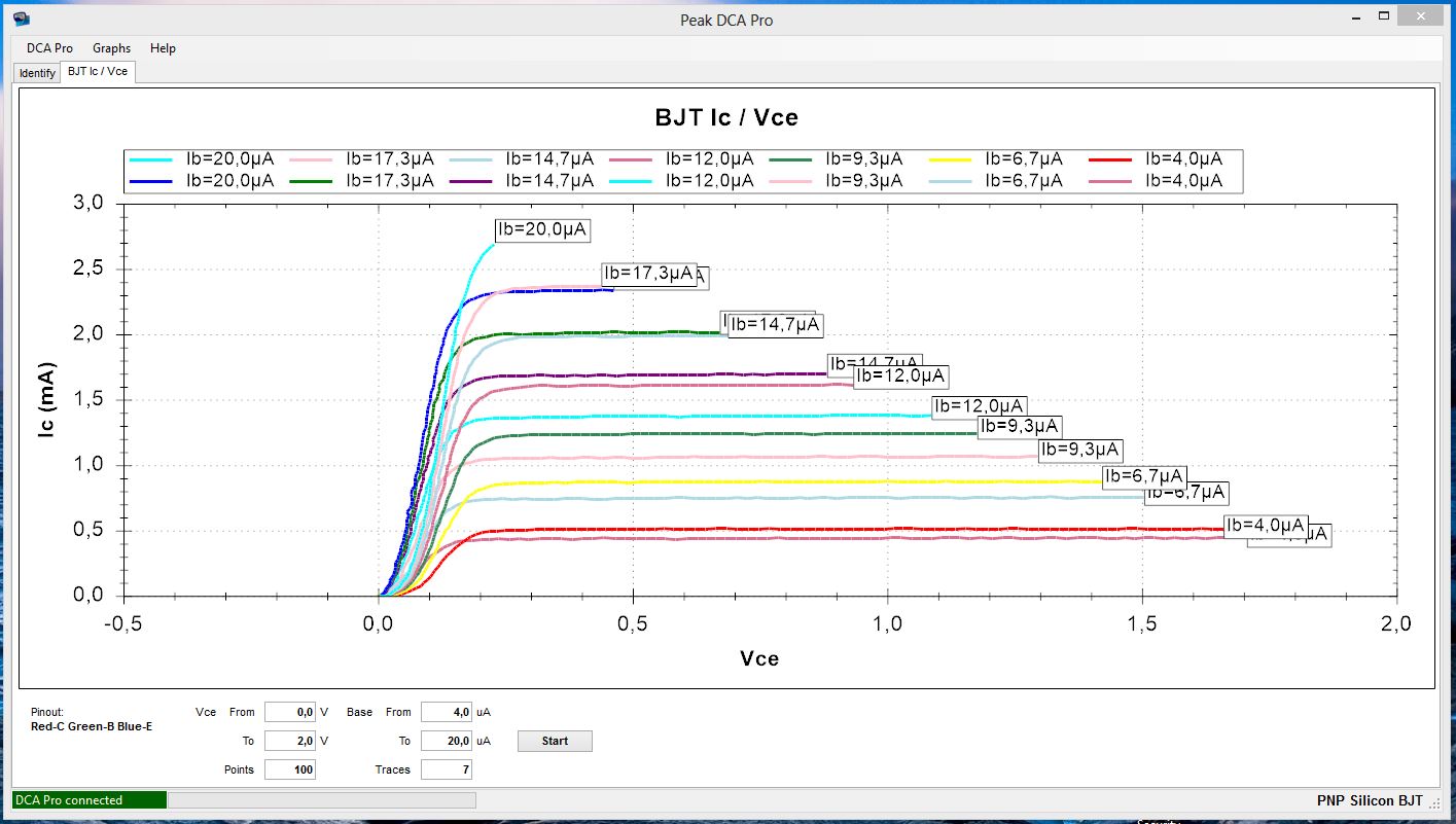

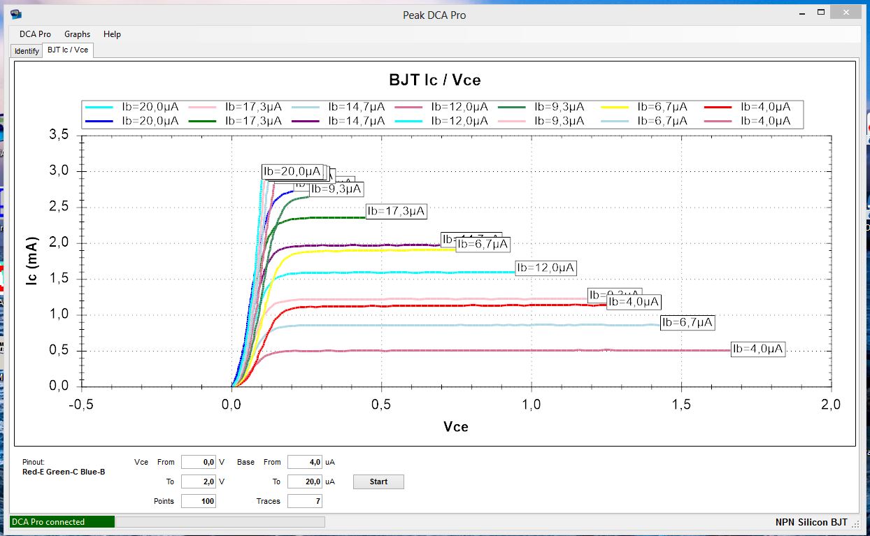

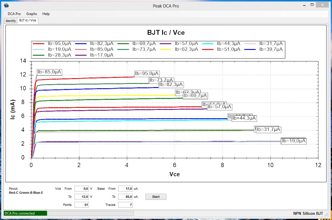

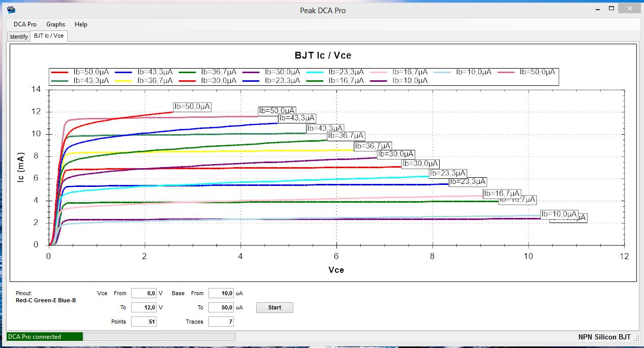

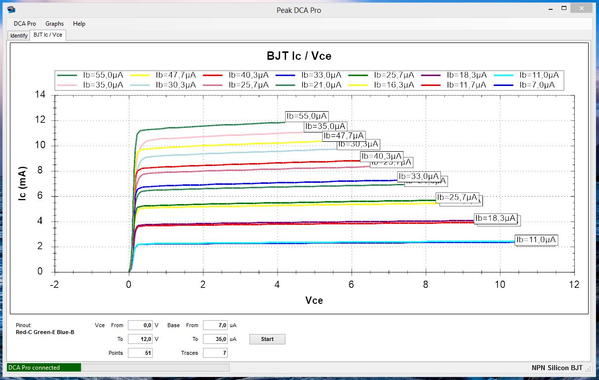

Here is one more measurement with the DCA75.
This is the MJE15030, 15031 pair.
This trannies have very low Rbb`of around 10 Ohm and would be a nice pair up to 10mA if there whould not be a big Hfe diffence of more then double. Here the PNPs are much stronger with Hfe over 300 in 25 pairs i measured. The NPNs hover at under Hfe 150.
Also as predicted by Kean they do not match well in the saturation area, so they are not that good for current mirrors, something they have in common with other higher voltage BJTs.
