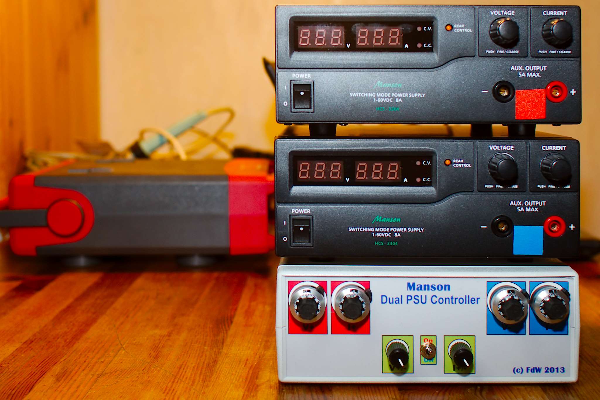

I did get me a pair of these HCS 3304 - Programmable DC power supply 1-60V, 0-8A at reichelt elektronik last week, so the investment budget is gone (for now) 🙂

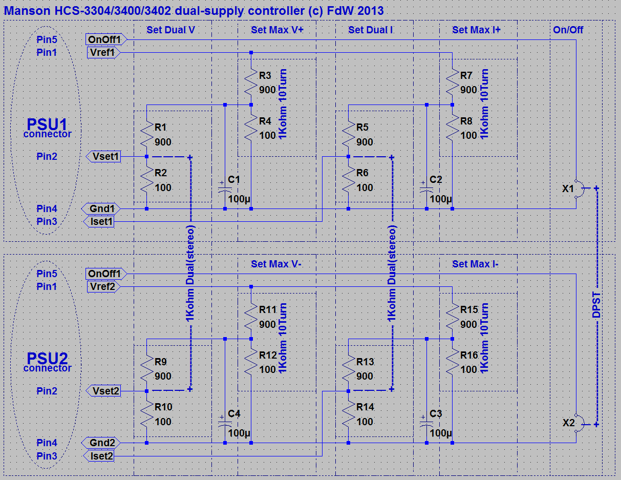

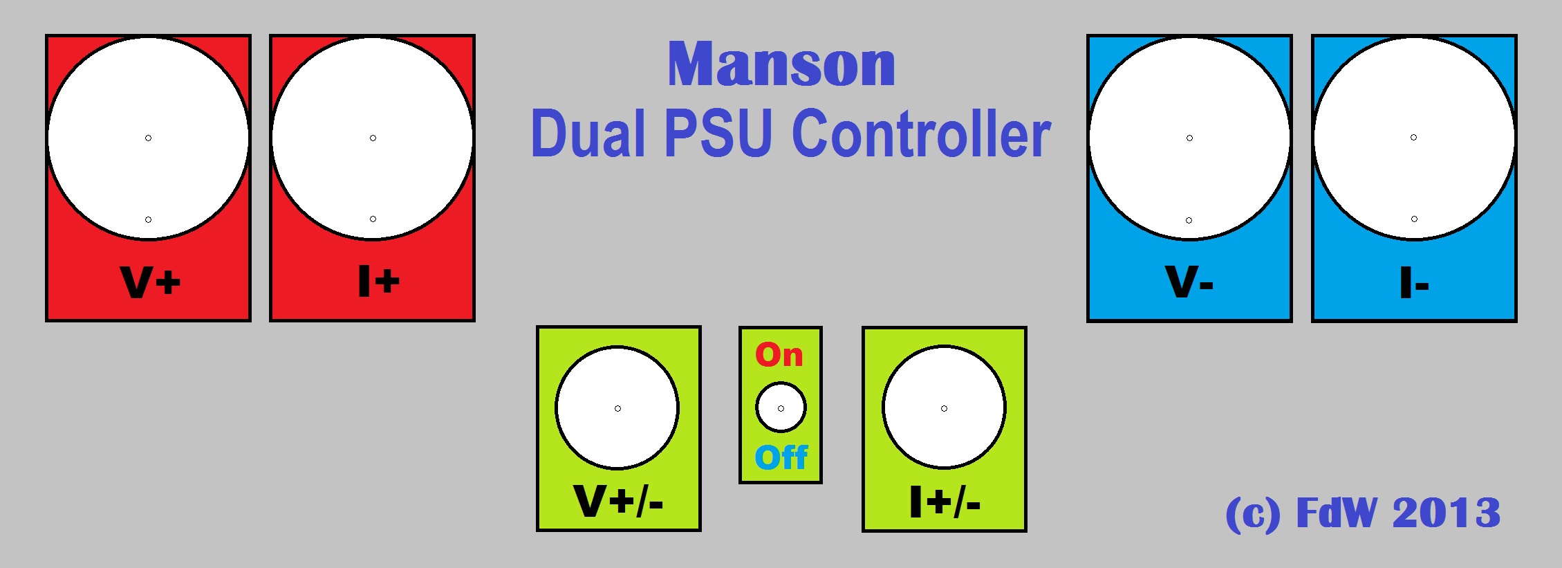

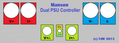

About 3 weeks ago I got me a few new lab supply's to test amplifiers, both 60V 8A. For this I needed to build a controller, to be able to control both (at the same time 🙂). So here it is (if you wanted to know, otherwise please ignore my post).
He, he, nice. Although they should have been self equipped already. Show it at Dave Jones's.
Why not just get a good variac..???
Why not 🙂, I just thought that this would be more universal, and I can control max current better. And I think that a good variac will be more expensive.
Who is Dave Jones's (except for the Pirate) and where to find hime (besides on his ship 🙂).
