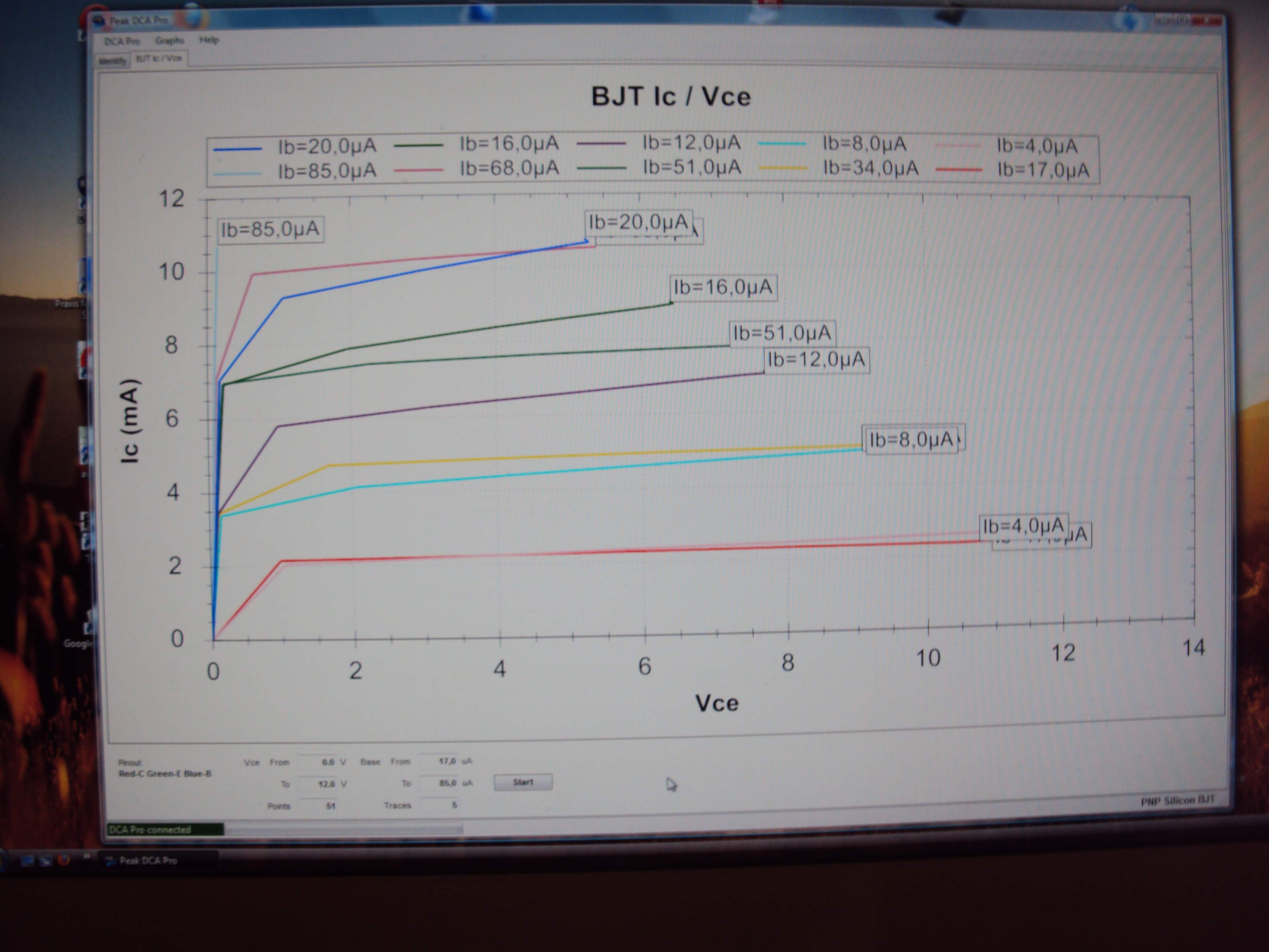

Here you see what we call in German " Kennlinienfeld".
It shows that the Vce curve against idle gets flatter when the idle goes down.
My BC550C and BC560C samples did even better.

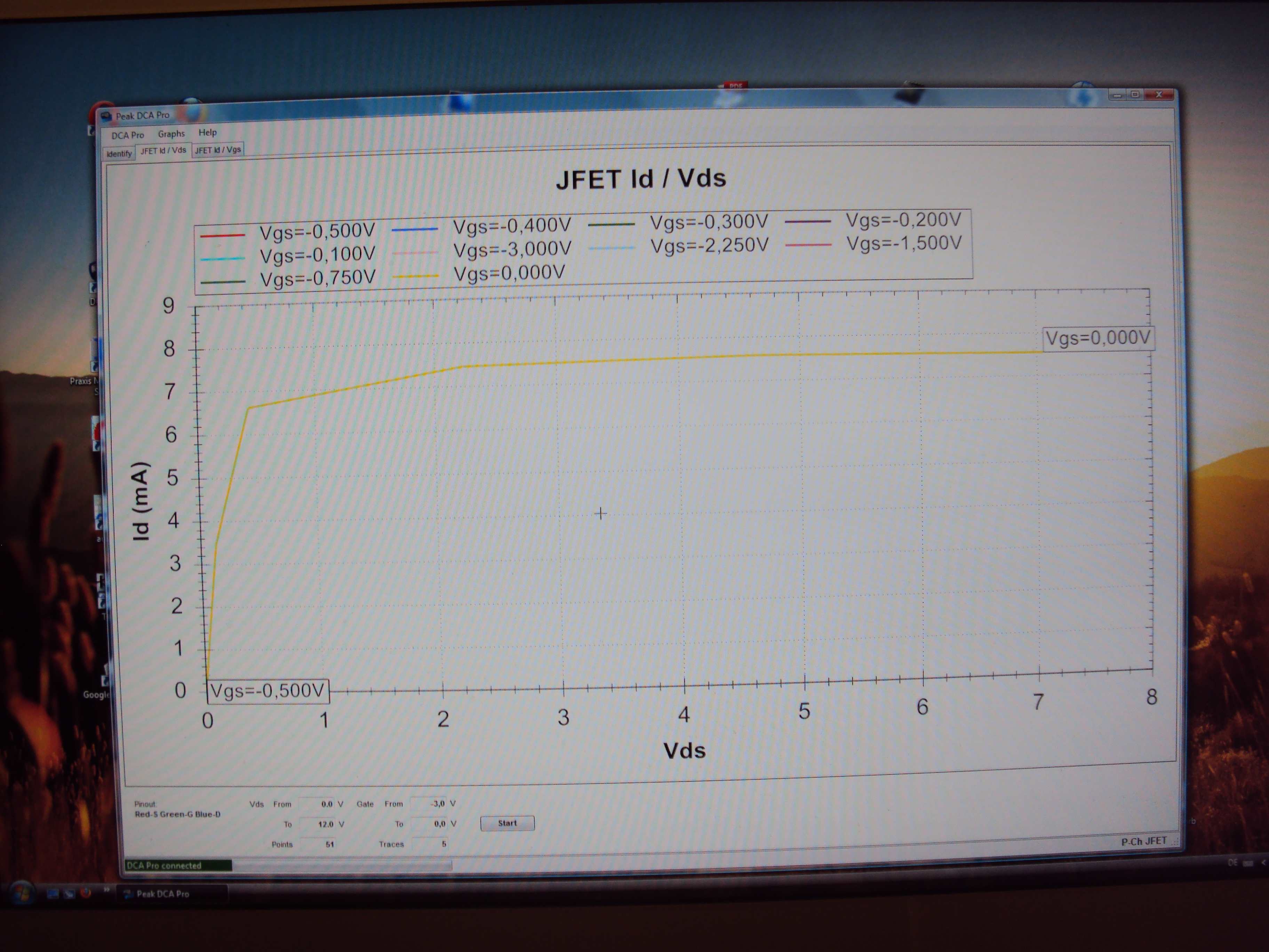

I noticed the same behaviour in fets... looking at k170 data, http://www.datasheetcatalog.org/datasheet/toshiba/1027.pdf , Id - Vds curve shows a flatter line for lower Id, but that means a lower Vgs (-0.4v) and looking at the Id - Vgs curve, we need higher Vgs (near -0.1v) to reach the most linear region.
IMO, in this case the solution is to compromise, use a Vds higher than 8 volts and a higher Vgs (-0.15v)

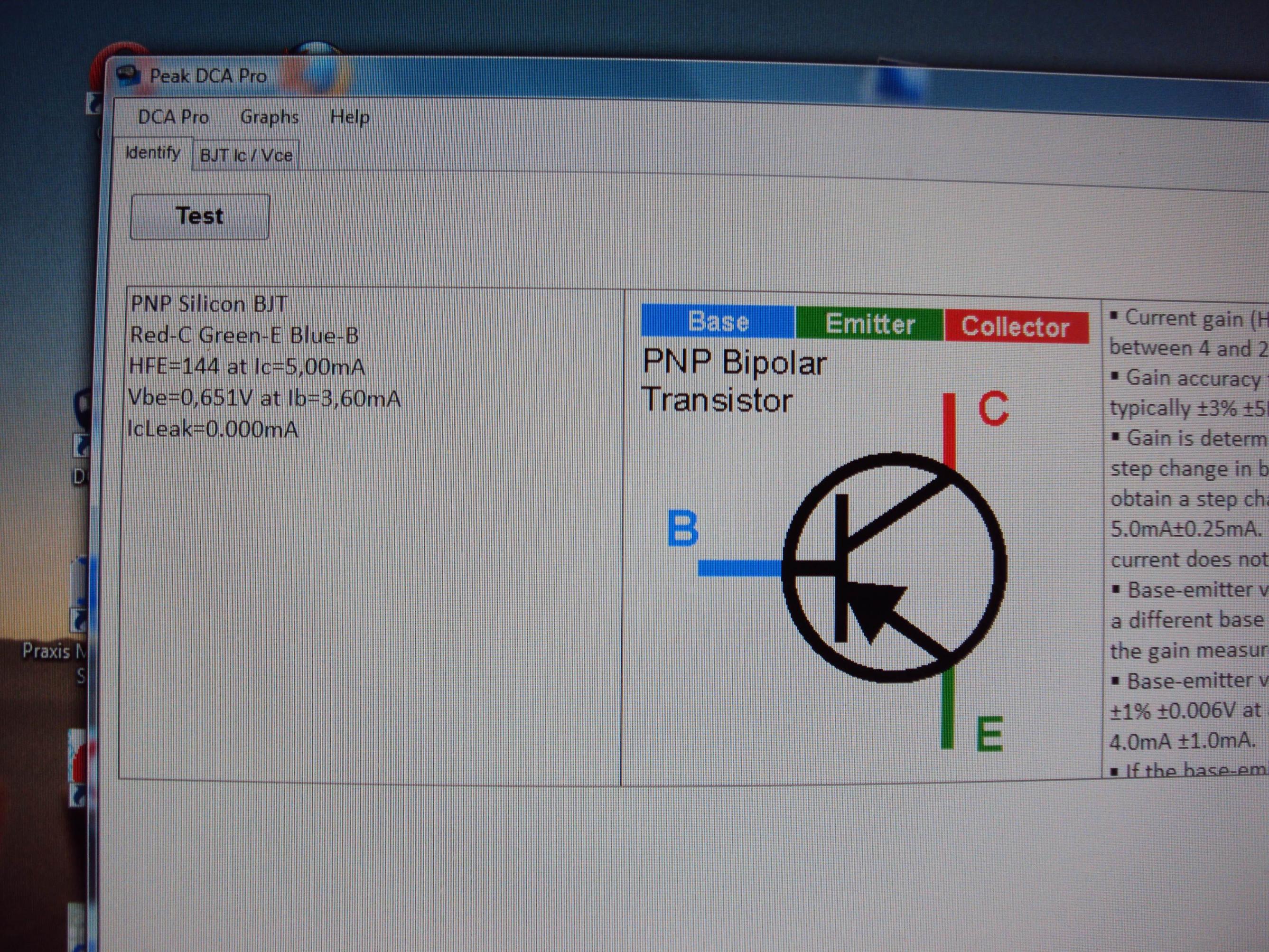

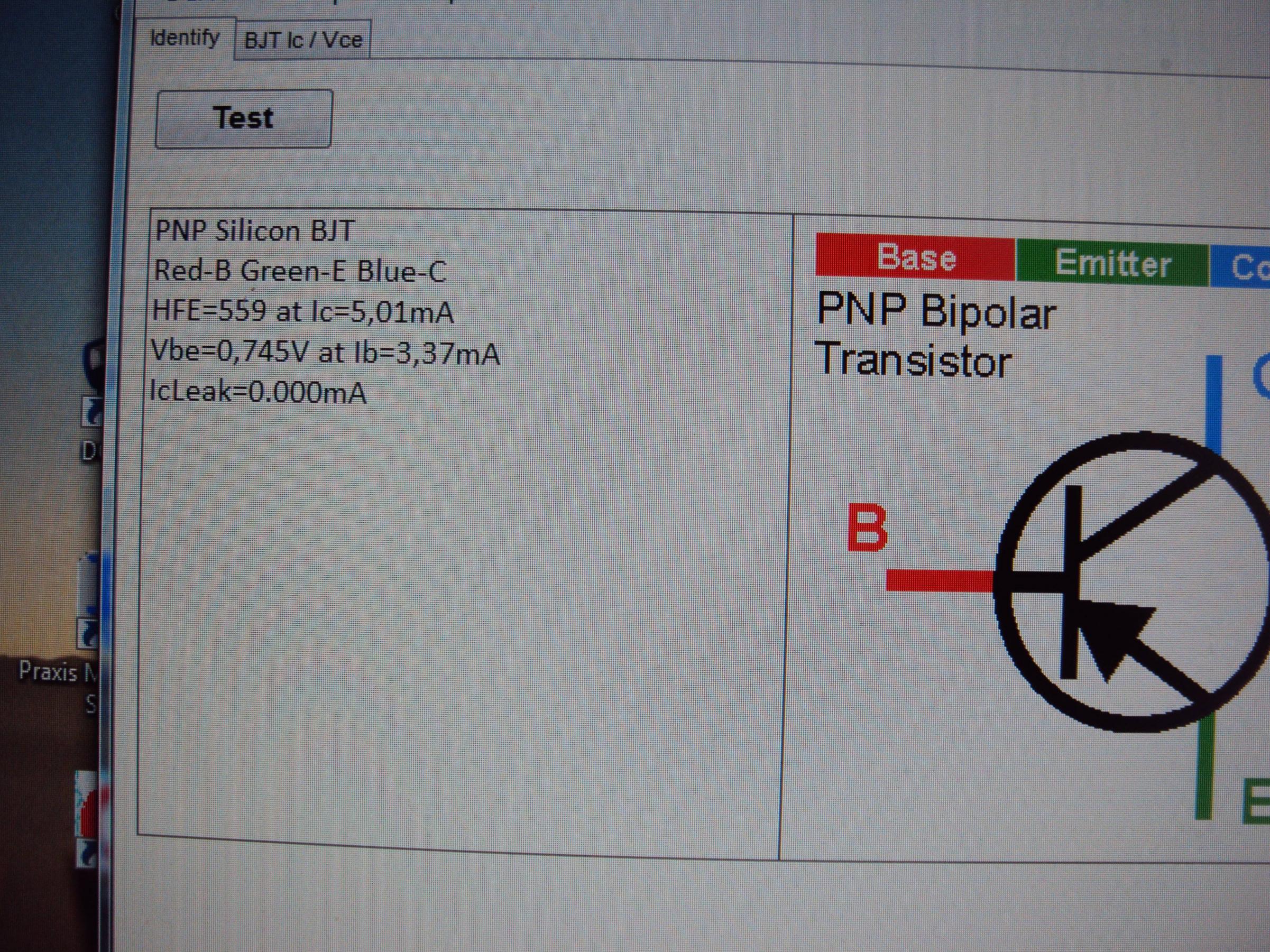

Here are some screen shots of the curve traces. The last graph shows the BC550C, 560C pair. Up to 2.5mA the curves are congruent.
Few small high Hfe BJTs are going to prove great for symmetric without plenty of noisy degeneration or extensive paralleling with a Cob penalty I am afraid.

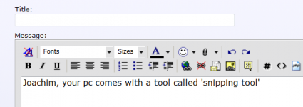

I am running this program on Bootcamp on my MAC so the Windows version is very basic.
I will look up if i find that tool nevertheless.
I have now measured BC327-40, 337-40 and also 1N4401, 4403.
The 337 is much faster then the PNP. The curves group only well under 2.5mA so the chosen idle for the Paradise is just about right. One advantgae of that trannies is the high Hfe giving relatively small base current. That helps with DC coupling of a common emitter stage like in the Paradise.
The 1N4401, 4403 combo is actually very good up to 4mA. The disadvantage i can see is less Hfe at a bit under 200.
Out of curiosity i measured BD139-16, 140-16 and they do very well up to 5mA.

The best pair i measured so far are the Sanyo 2SC3503, 2SA1381.
Very good up to 12mA, my measurement limit. They are also know for low Rbb`of under 20 Ohm. Sanyo are not making them any more but the Fairchild KSC replacements are reported to be as good. These are also great VAS driver and buffer trannis. Hfe is useful at a bit over 200.
I also tried the 2SC3601, 2SA1407 combo. They are famous for extremely low Rbb`of ca. 2 Ohm. Unfortunately they are not very complimentary. My pair had also low Hfe of around 80.
I also measured MJE15030, 15031. Early voltage is pretty high but all pairs i tested had a huge Hfe difference of a factor of about 2.
They have low Rbb`of around 10 Ohm though so i do not condemn them totally at the moment. Maybe i can buy some that are better matched Hfe wise.

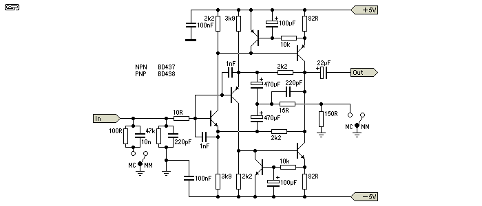

I measured BD437, 438, the ones that JLH uses in his parallel symmetric MC head.
The main advantage of this ones is Hfe over 200, quite good for a medium power device.
JLH chose them because of this to minimize base current.
Not very complimentary over 2mA, not very satisfying for a medium power device.
The Sanyos have Hfe as high and match much better up to high idle.

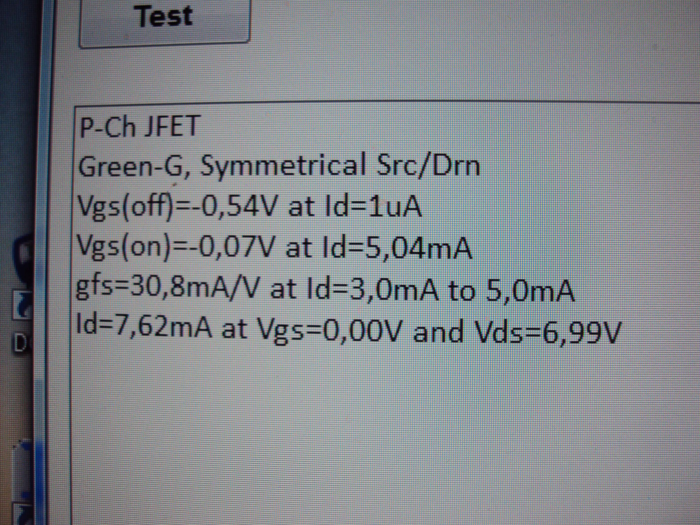

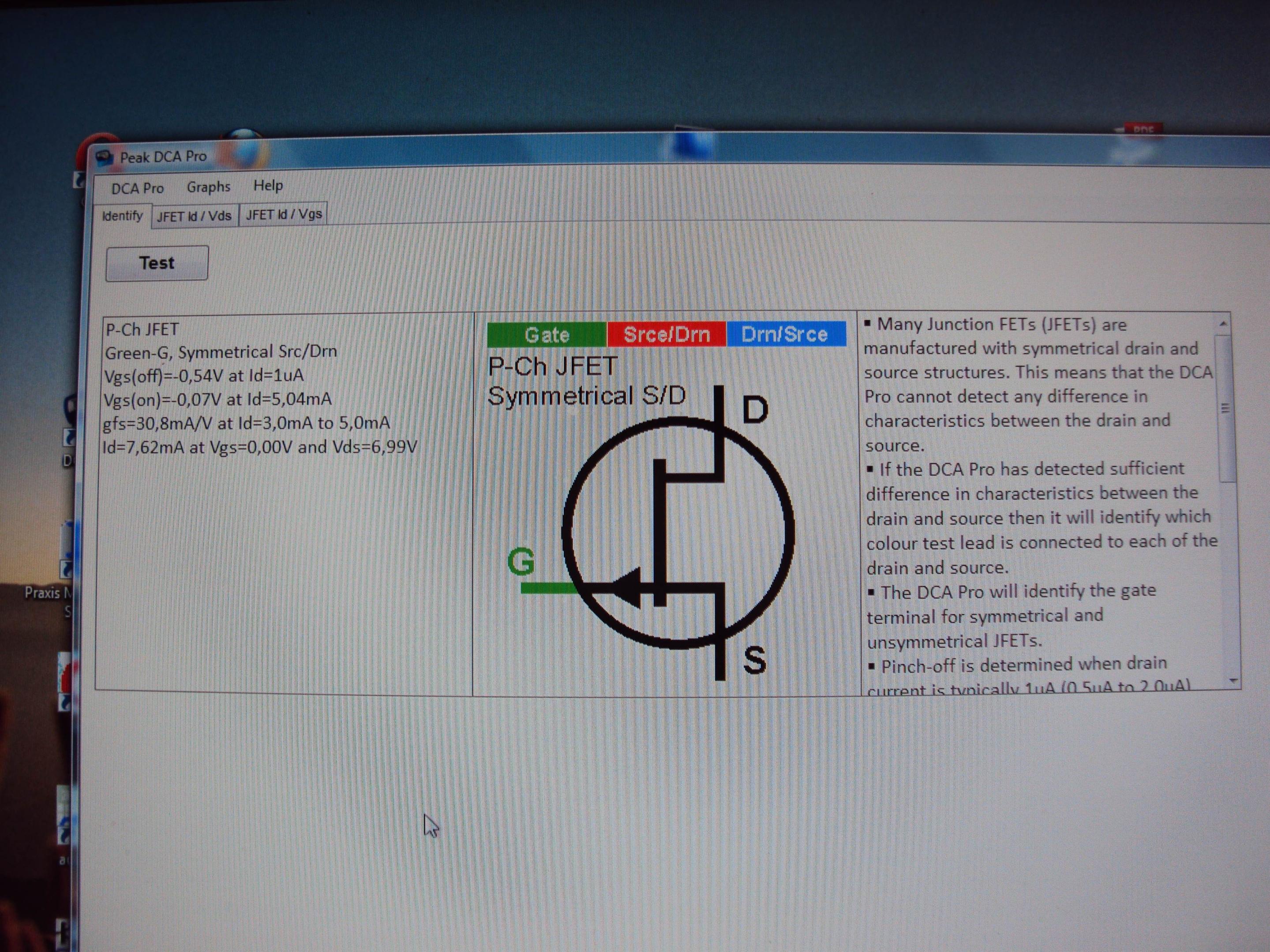

Would you please plot a k170BL at different Vgs for me ?
Sure, i also will compare a 2SJ74BL.
