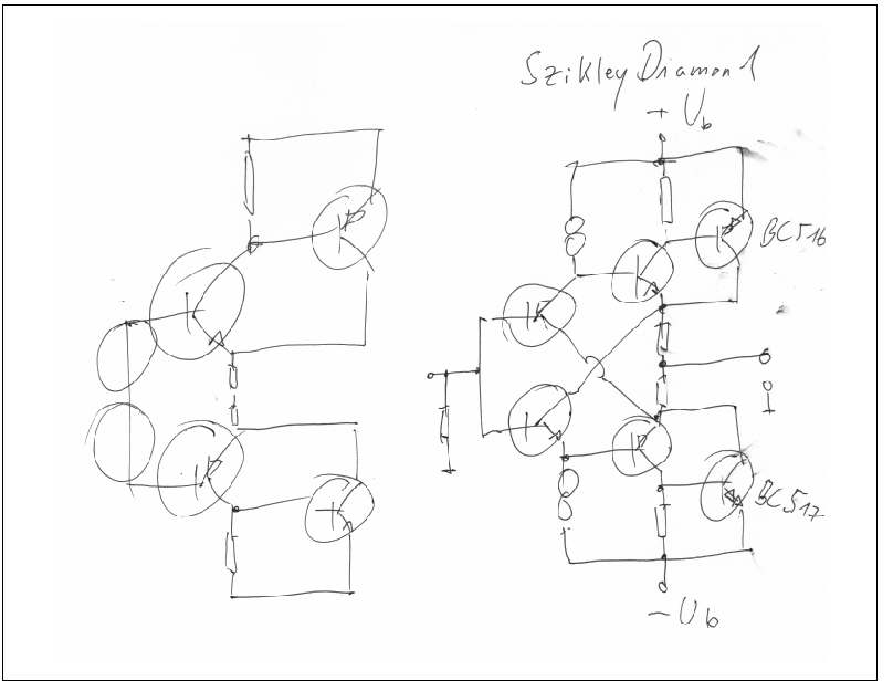

MiiB, i made a new BJT buffer, just in case we would like to try something different then the current Paradise J-Fet buffer. I call it a Szikley Diamond. Circuit comes soon.
I like the buffer...... wonder what input impedance is... could have influence on the RiAA circuit.
We can mirror in the current for the input . This way we have a good injection possibility for the servo
That depends on how high the idle current is in the input stage. Other then that the input BJTs are bootstrapped on CCSs so input impedance should be high.
Here is the buffer...
Something like this 🙂 just exercising some idea's 🙂
