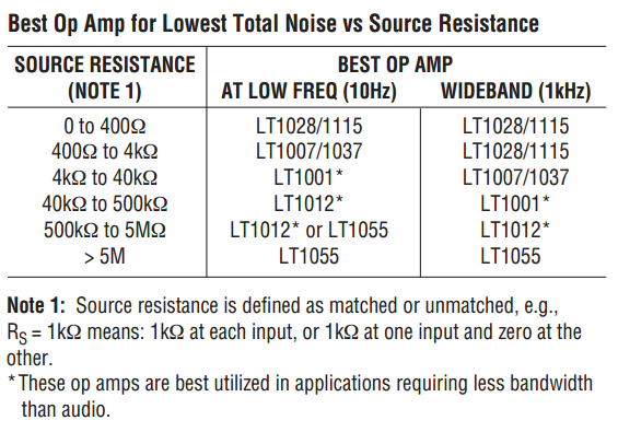

There is a ton of good information in the http://cds.linear.com/docs/Datasheet/lt1115fa.pdf datasheet.

Yes there is, but several local DIYers here have asked me for help for the reason that a phono preamp built according to the datasheet was oscillating. LT1115 may behave tricky, especially with additional buffer in the loop. So is AD797.

No, I was referring to the datasheet that FDW has linked here, i.e.
There is a schematic of phono preamp with LT1115 and I was referring to that.
Regarding paradise, I have a feedback of one local DIYer here and yes, he says it is oscillating. But it is just one piece, no statistics available to me regarding paradise.
For servos, I use OP07, OP177 and OPA134.
Yes, the LT1115 can be a bit tricky.
