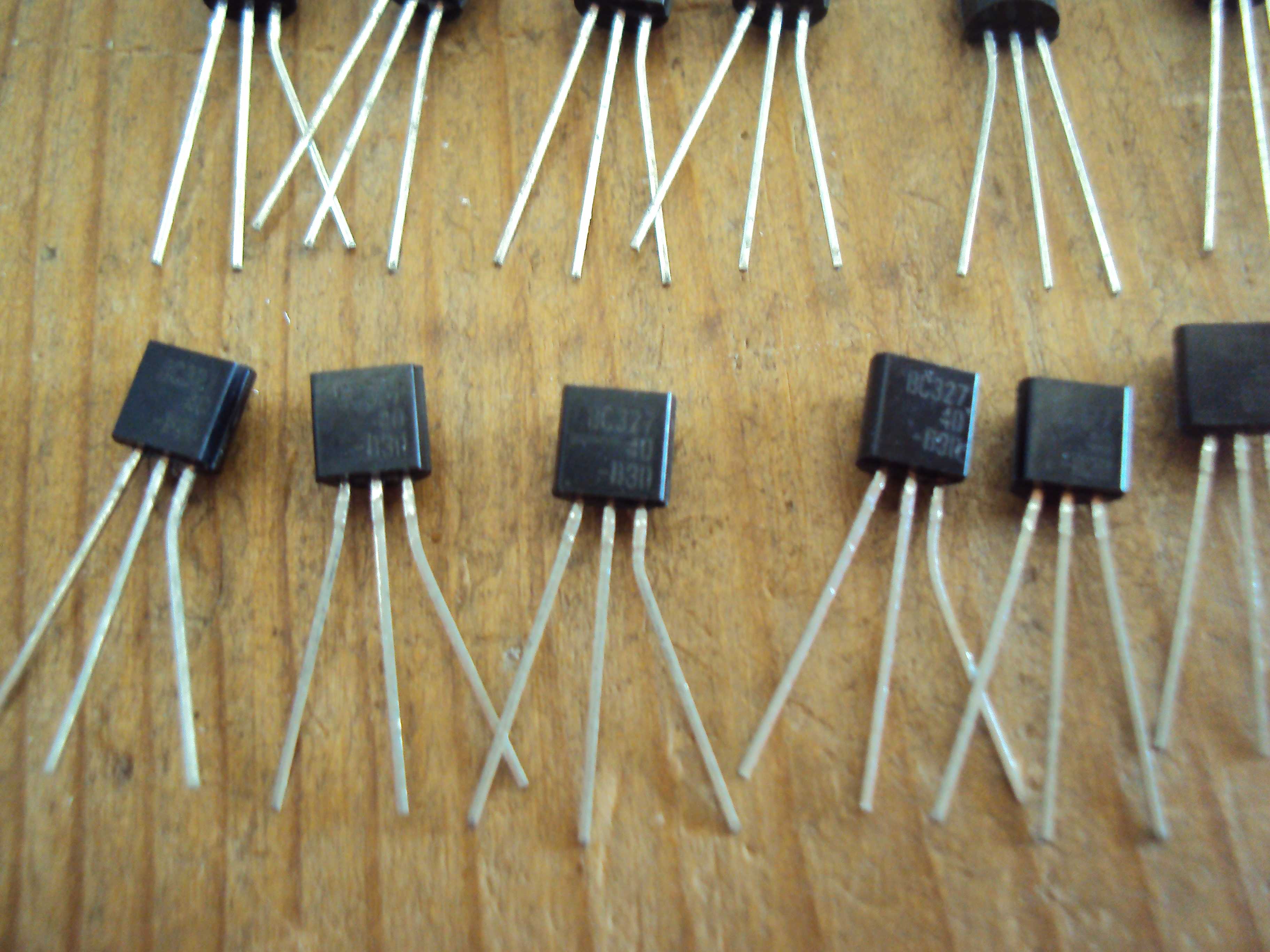

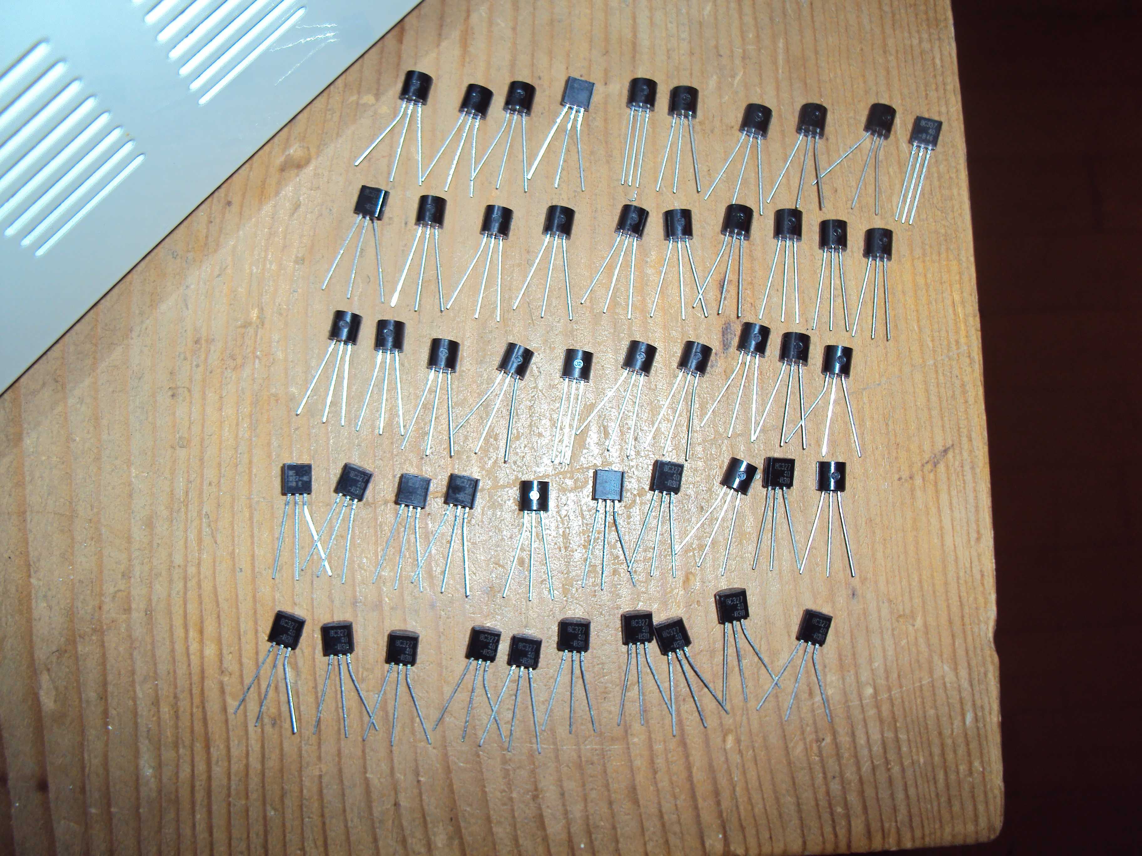

pdul, i have measured some of your trannies and they are around 550 so our measurements are consistent. I have now a lot of good pairs. One was faulty so i can only repeat : measure each end every transistor and do not swap NPN and PNP. It happened to me and i have a lot of experience. I will also finish to select the PNP´s for you today.
I already have 50 good ones.
Sounds good, and sorry for the dead one😱 It is easy for me to keep them apart, since only the npns have cowboy legs and the pnps are strait🙂
cowboy legs, lol.
Yep, the ammo tape ones, they are called cowboys sometimes. Another good one is when we twist leg positions in different pin order equivalents: Irish dancers.😀
Joachim. What brand are those trannies you have? It is rare to see so clear text on them nowadays🙂
I bought them from different places. Mostly Diotec and Fairchild. I mixed brands in my Paradise without problems. When you want exact pairs from the same maker you can sort them by marking. Usually the same batch has an additional number printed on.
I remeasured the "faulty" transistor from yesterday and it works. I may have had a contact problem.
What i meant is that most components have that allmost invisible lasermarking, those in your picture are easy to read.
