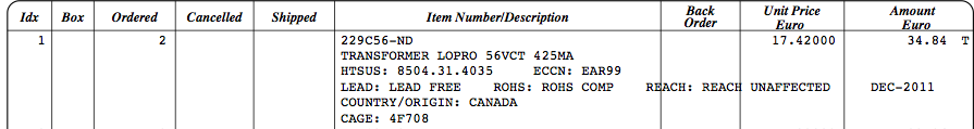

Thanks Frans, yes, that trafo is a good choice.
The transformers are delayed until december, sorry.
I will use Block transformers for the prototype so that i can cary on.
Later the Hammonds can be fitted and i will listen if they make any difference.
