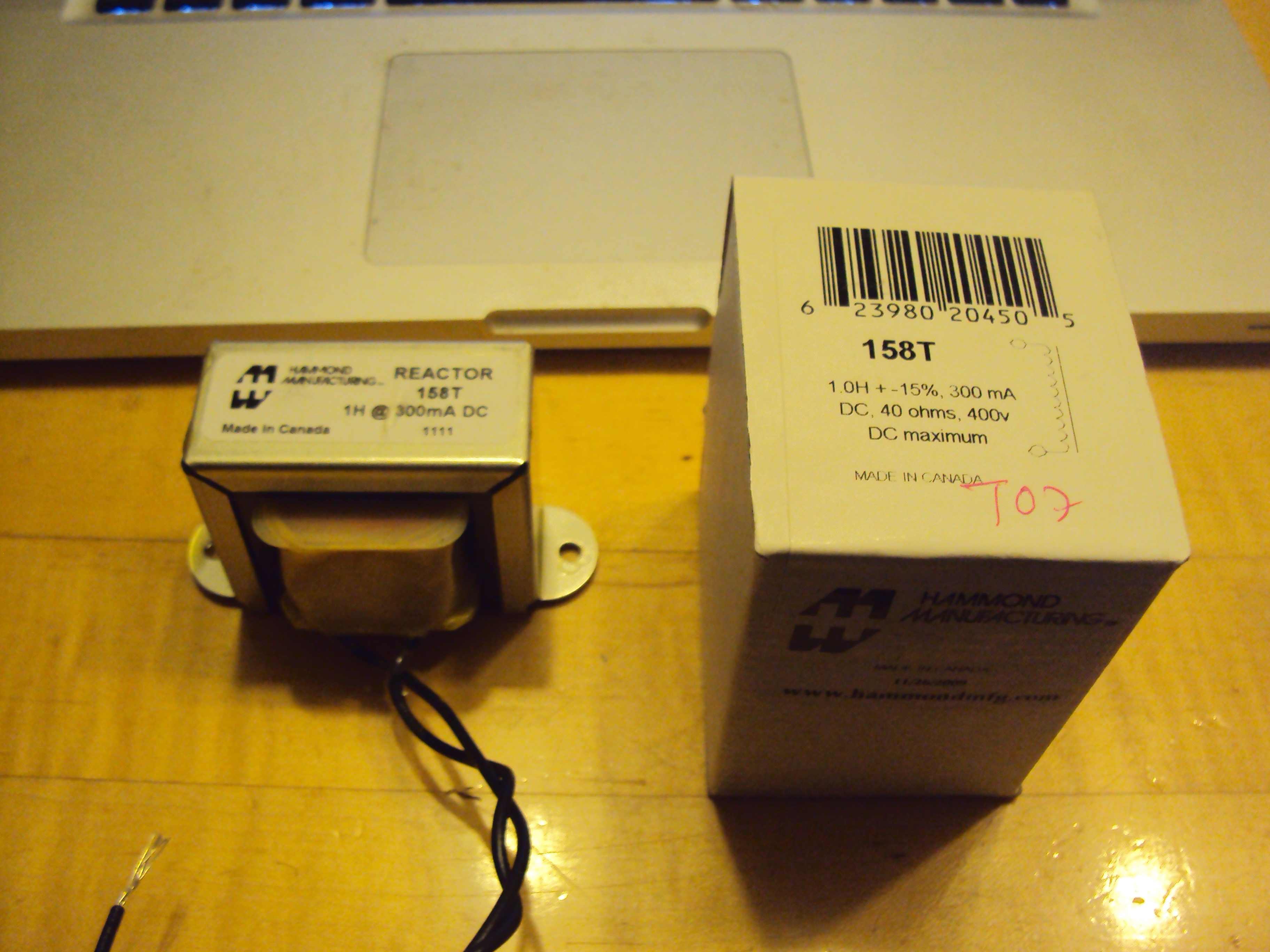

Joachim. I just recieved the trannies, so time to pair some Adams and Eves, for the paradise😀
Thx Frans. Never heard of that one.

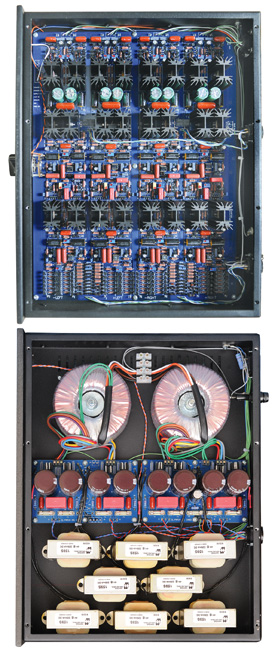

Interesting detail:
Interesting detail:
You will have to be a little careful with the volume control 😀.MM gain 60dB
