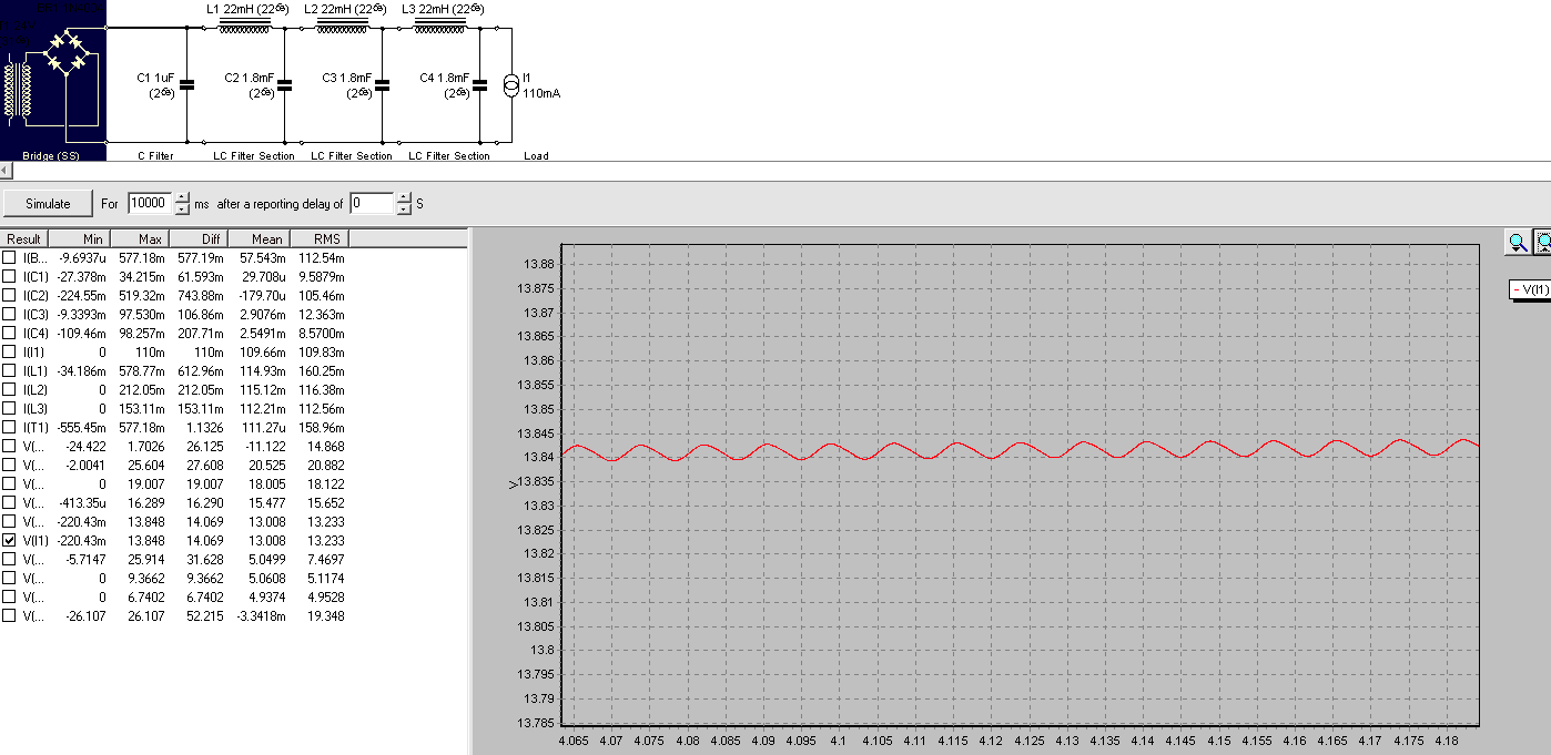

For this job I would select inductors with a nice big iron core, like these Power inductors - Mouser Using one of these with 2 capacitors should be good enough (more is always better 🙂)

Off course if one really wants to get the most out of this Paradise one can choose to build a heavy filtering prereg with loads of coils and caps, but it costs and it is not so simple to design correctly.

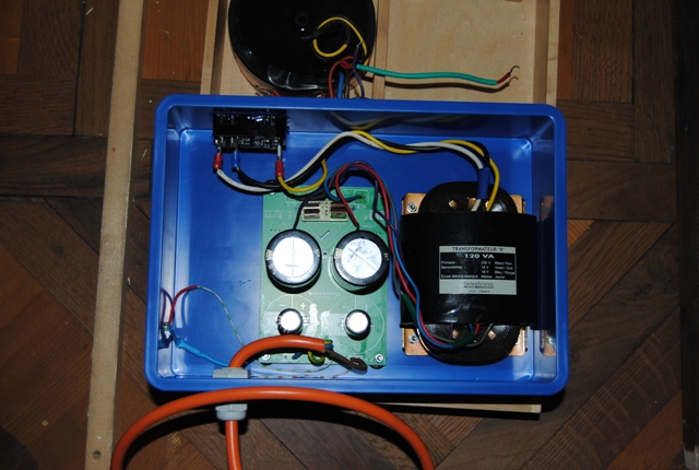

I have a very nice Italian cabinet i want to use, so my plan is to build a cabinet within the cabinet for the powersupply🙂
My plan is to build a small cabinet for the powersupply inside the main cabinet, maybe some cu plate will do, so i guess distance wise everything is close, but fully separated shielding wise🙂

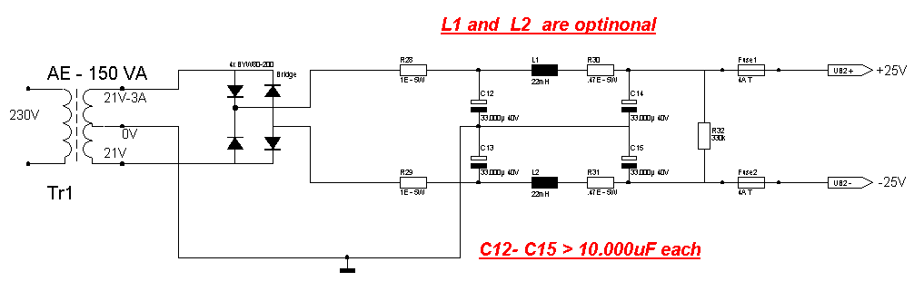

As I am a not so advanced in electronics, I was wondering, if I could use this as a PSU - found that on DDDAC.DE / other projects/TUMOS
It uses simple ferrite coils for loudspeakers and delivers round +/- 30 volts DC when using a 21 Volts transformer
