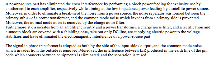

I am searching for the Onkyo patent. So far i only found a funny translation. Now even i are getting confused.....
