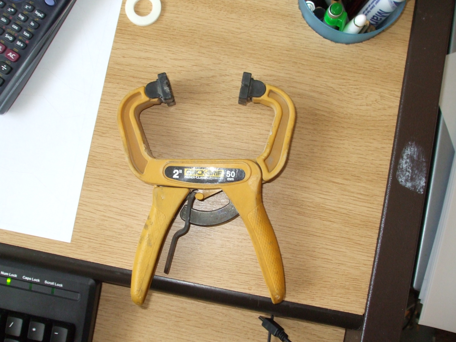

For the big ones on cooler
I first fitted the transistors to cooler before welding
One may start form sides or middle fit first one nice and square twiddle in place position the second one take out and clamp repeat till lot is in and then weld
Or, found it after, weld in place transistors and then use magic tool like in picture to clamp
IMO this is the most difficult part of build so take your time as clamps are a pain to get off.
I prefer to lay the power trannies on the heatsink, then fix them with the springs, then point them into the holes, fix the heatsink and finally solder everything in place.
