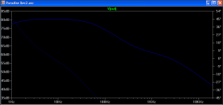

For my previous post VLF wondering I run AC analysis on rev2 sim posted here some time ago. Ooops, if the TT and arm are not much controlled everything will pass. No VLF roll off to speak of. Will probably differentiate a lot in various systems regarding TT, loudspeakers control capabilities, electronics roll off and/or headroom.

I wonder, maybe the paradise makes path very low near to DC without rumble roll off and it chokes smaller speakers with vinyl eccentricity? Much VLF can mask staging. Did not run an AC analysis in the sim.

Salas, the simplest way to give the Paradise some rolloff in the bass would be an output cap. When the input impedance of the line stage is 47kOhm i would try 0.47u to 1u.
Yes, i think it could be the capacitive coupling in the Simplistic that could give it an advantage if the record is not totally flat or the arm-cartridge combination has a peak in the subsonic region. I hope all here have a good enough turntable so that it does not ruble in itself.
How did you do this sim ?
