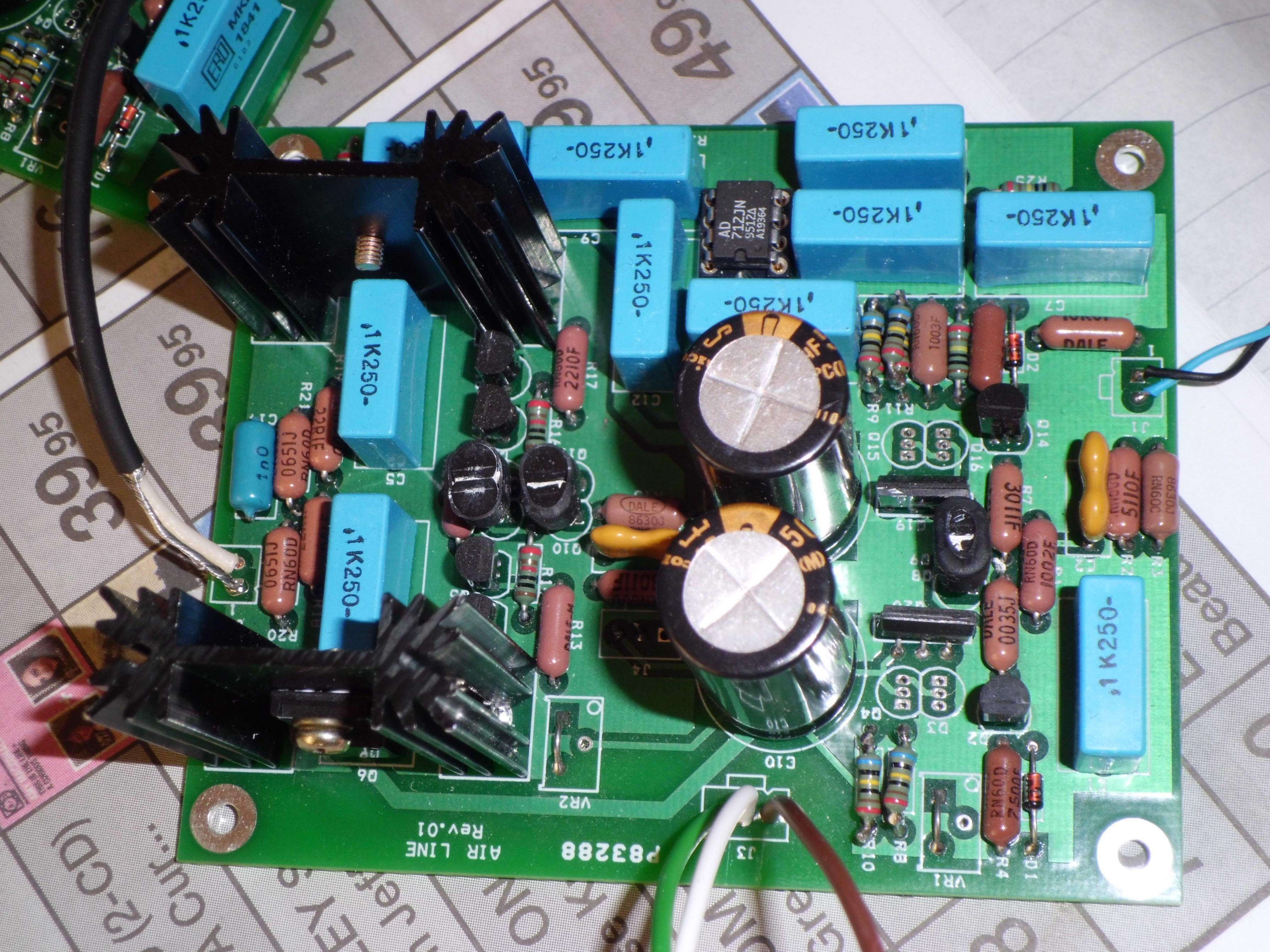

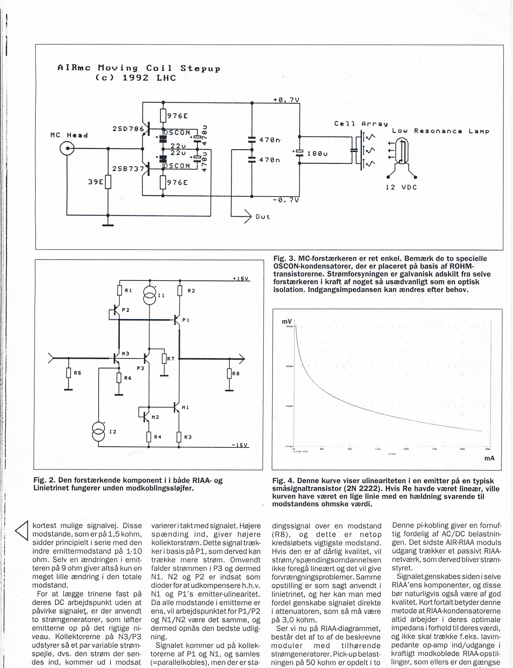

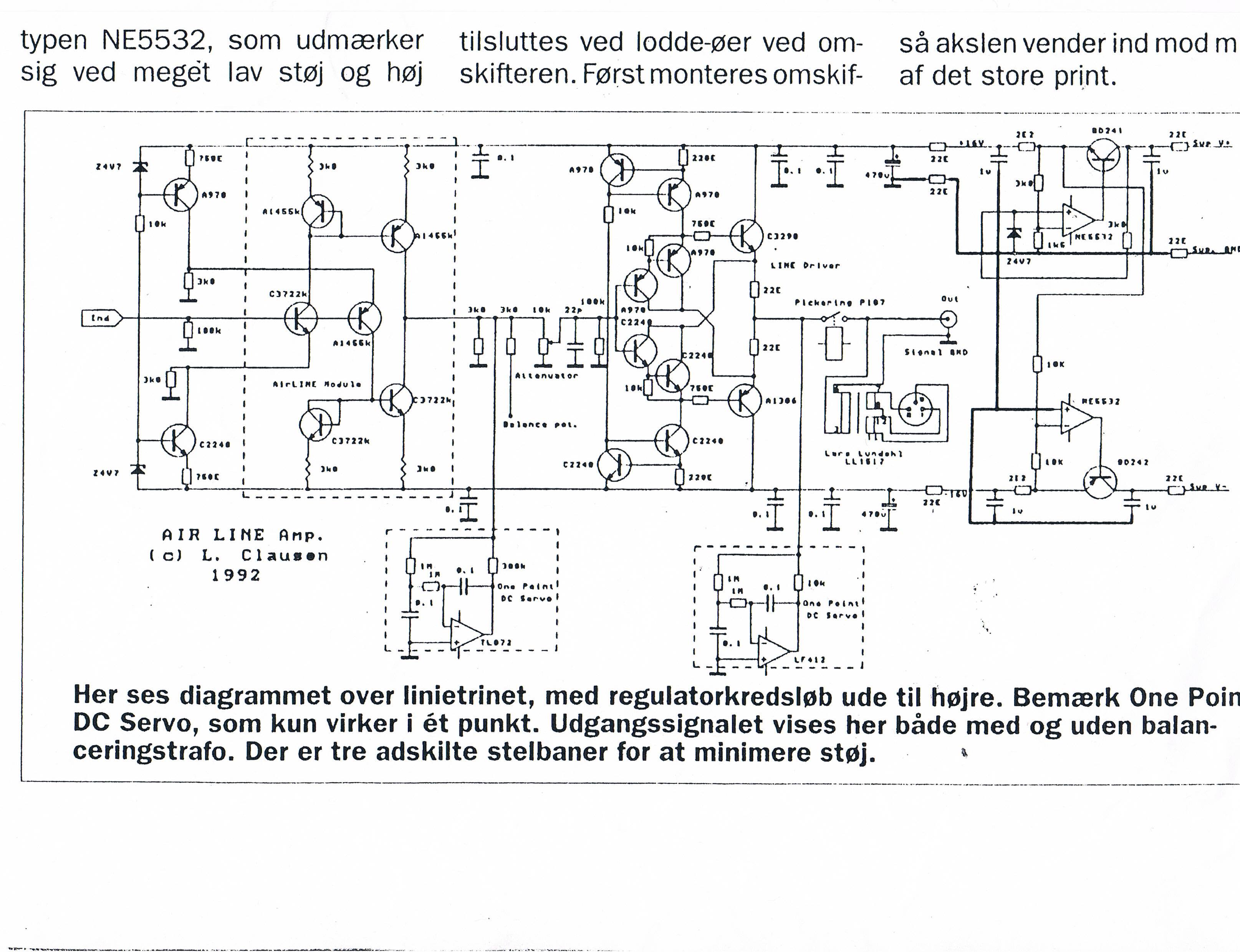

This is my old transimpedance riia. It is diy from the Danish former magazine High fidelity in 92, and has served me well for many years, very transparant, but lately the pcb has started to deteriorate (lousy quality to begin with) so i can`t wait for the paradise boards to arrive
This is a good circuit. Good luck. It is also based on current feedback and transimpedance.
The input stage is very similar to what is know as Satri in Korea. The output stage is a refined diamond buffer. This is a very fast circuit that should give good dynamics and resolution. Thanks for posting it. Dimitri does good work.
