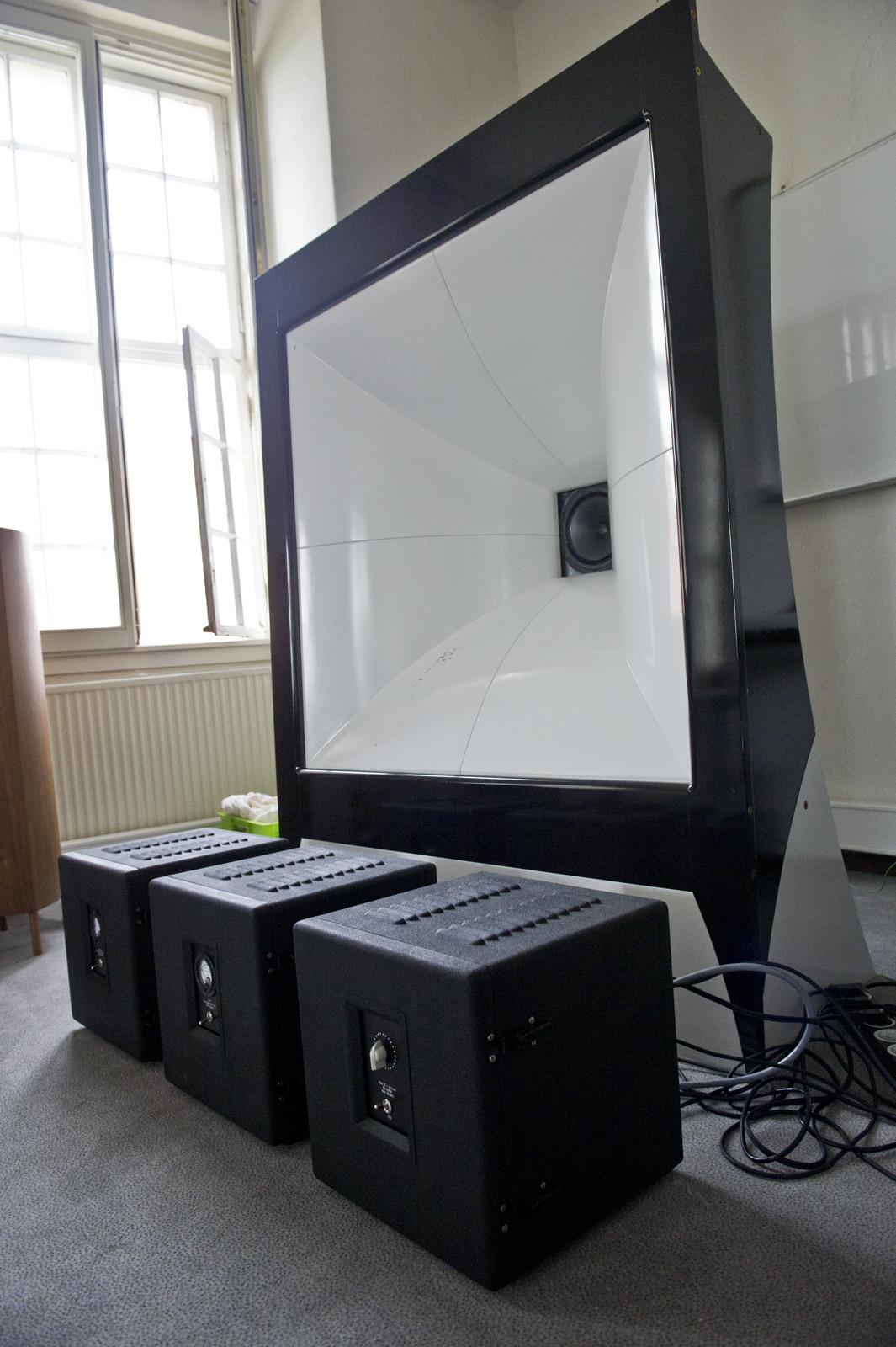

This will be the speakers, a so far non commercial experiment by Andres.
The driver is a Visaton B200. I am currently working on a wideband driver that shall compete with the Visaton.
