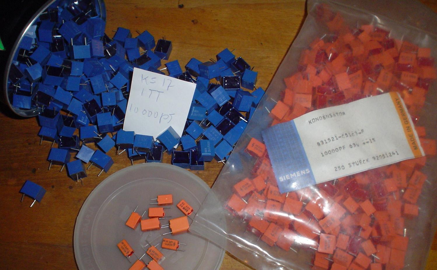

which capacitor values are you guys combining to reach 33,3nf and 11nf in the riia?
It seems to be a bit of a puzzle to get there and at the same time use a sensible quality capacitors😕😀
I will start with amtrans poly caps
Ex: 8200p + 2700p + 100p for 11nF ....feel free to experiment... there is provision for an outboard riaa circuit in the main board.
As usual, i'll have a hard time picking between Blue and Orange.
Slightly boring to repeat the message, but these caps go for less than a dollar each on the web, likely cheaper than same value polypropylene from regular sources.
KS (Polystyrenes) juicy stuff but I can only find them in ebay right ?
Not really.
There are still lots of shops that sell NOS parts as e.g. KS capacitors, examples are Pollin and Oppermann in your current backyard.
Easier than handing you a bunch of adressess for me is giving suggestions of parts to purchase.
For another example Philips KS443, similar boxed 1%/63V polystyrene, but yellow instead.
16x NOS PHILIPS KS443 10000pF 10nF 63V 1% STYROFLEX HI-END POLYSTYRENE CAPS! | eBay
Beauty of the trip to Paradise boards is that they're already laid out for boxed KS caps.
