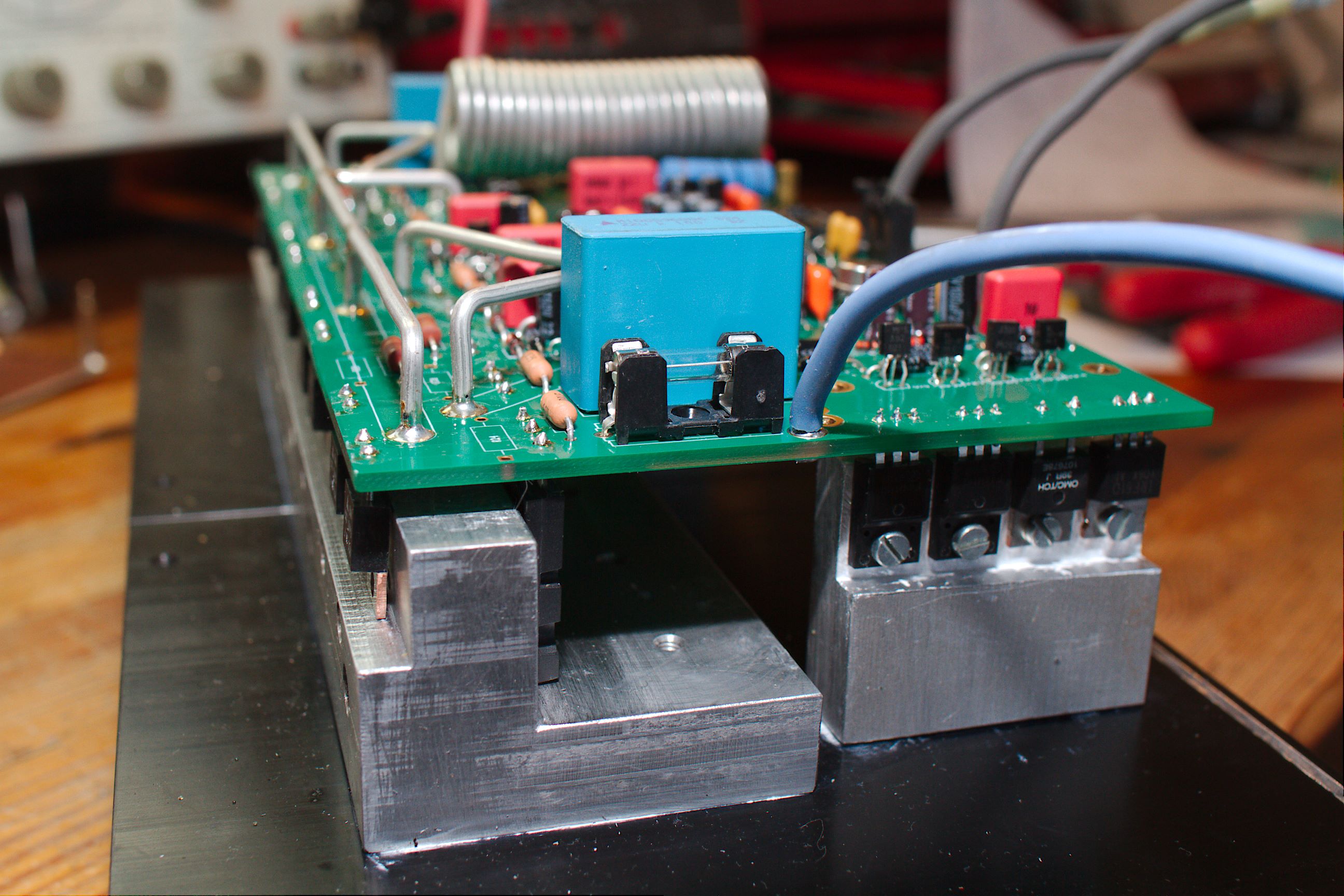

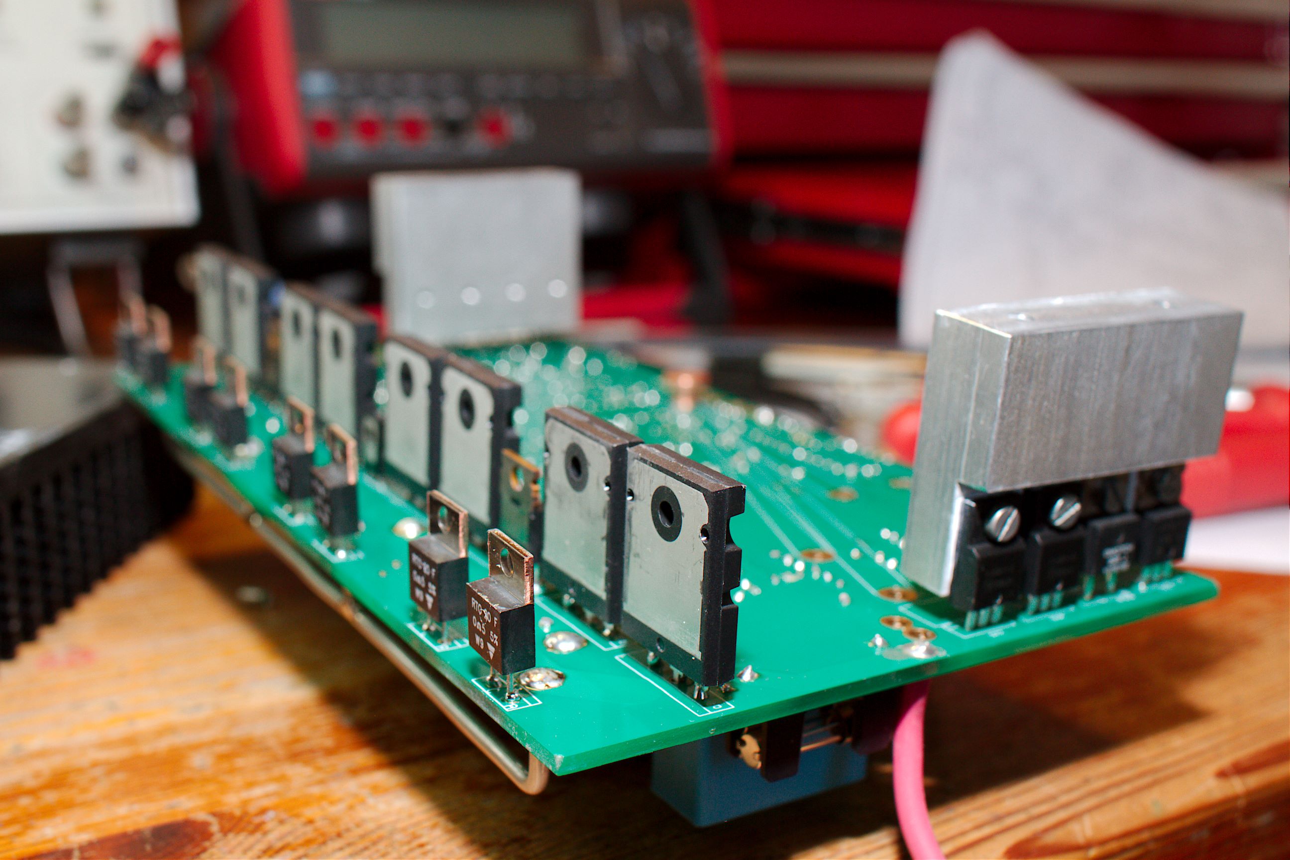

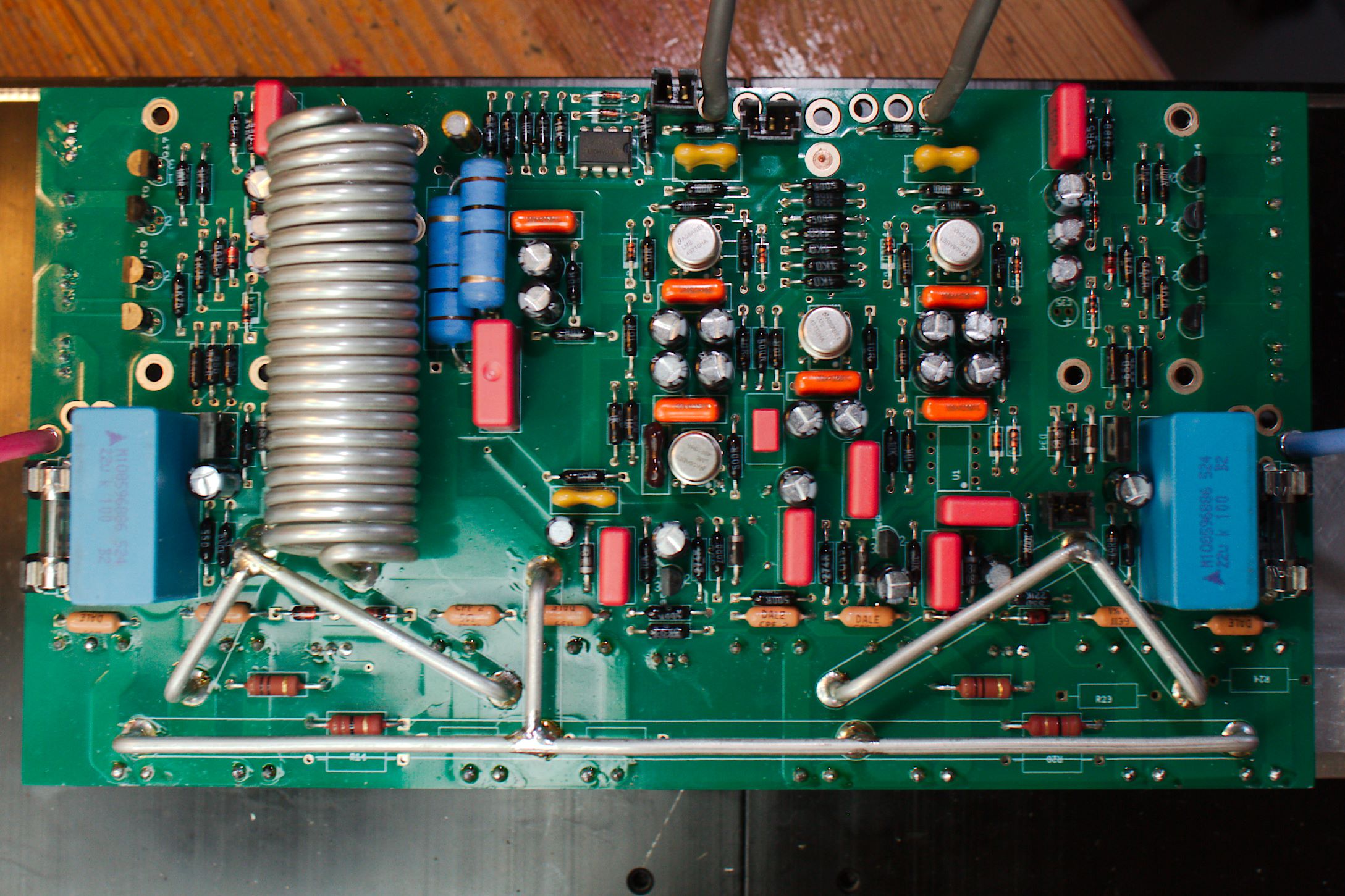

Quick update on my amp
Everything is placed on the board, tonight I will try to fire it up 🙂
And the heatsink and mounting brackets
And yes it is massive 🙂 good for 330W in 2 Ohm (660W in 4 Ohm when bridged) (better then 90db at 1st harmonic in the simulator, real life ... w'l see 🙂)
