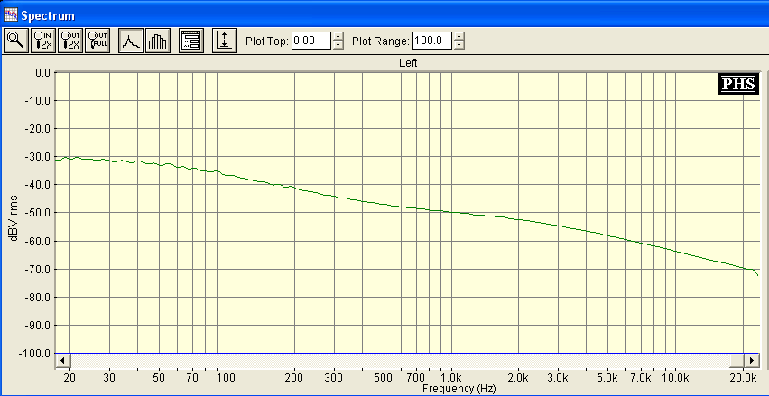

With a scope that has two channels and a mathematics function it is quite easy to check if the channels are similar-
Scope usually has a vertical accuracy of 5%.
What I have is a precision 5 1/2 digit Fluke meter and created a reference file with the RIAA using top level HP Meter I had access to for a couple of months.
Then I play the file and measure the output with my Fluke and record the variation and plot it vs. Frequency.
That as proven to be accurate to 0.05dB.
When I get the board I will be able to make reference measurements for all the community here and I will share the results with all of you.

I meant the reference file I have created has an accuracy under 0.05%.
I created with the topo of the line Agilent meter.
I play the file at a level that will set a good spot for the meter thus allowing it to go down to 0.1% or better.
I got the idea of creating the reference file after going through a lot of pain in trying to measure the RIAA for another project I was developing and I was using an excel spreadsheet with a lot of formula to calculate the accuracy.
The process was really elaborate and I had to come out with a better and faster way but yet precise and that is when I got this idea.
Obviously playing the file also works if you have a flat soundcard to play with and my EMU 0204 is very good for this purpose and that is why I specifically choose this model sa it has a very flat frequency response.
I would recommend this method, it will be very straightforward to plot the frequency response.

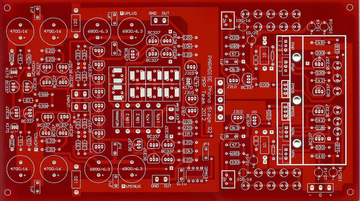

Salas...The impedance of the mirrors here is primarily set by the impedance of the current source driving them, there are two things to say about the mirrors, one is impedance, the other is current gain. The latter determines the offset, the first has influence on the RIAA network. The impedance ha also great influence on the distortion spectra of the RIAA. The current gain balance is set by the two resistors. the better matched they are, the smaller the offset and the less the servo has to work.
Talking the 120R ones? Face to face bonding of mirror BJTs non critical?
