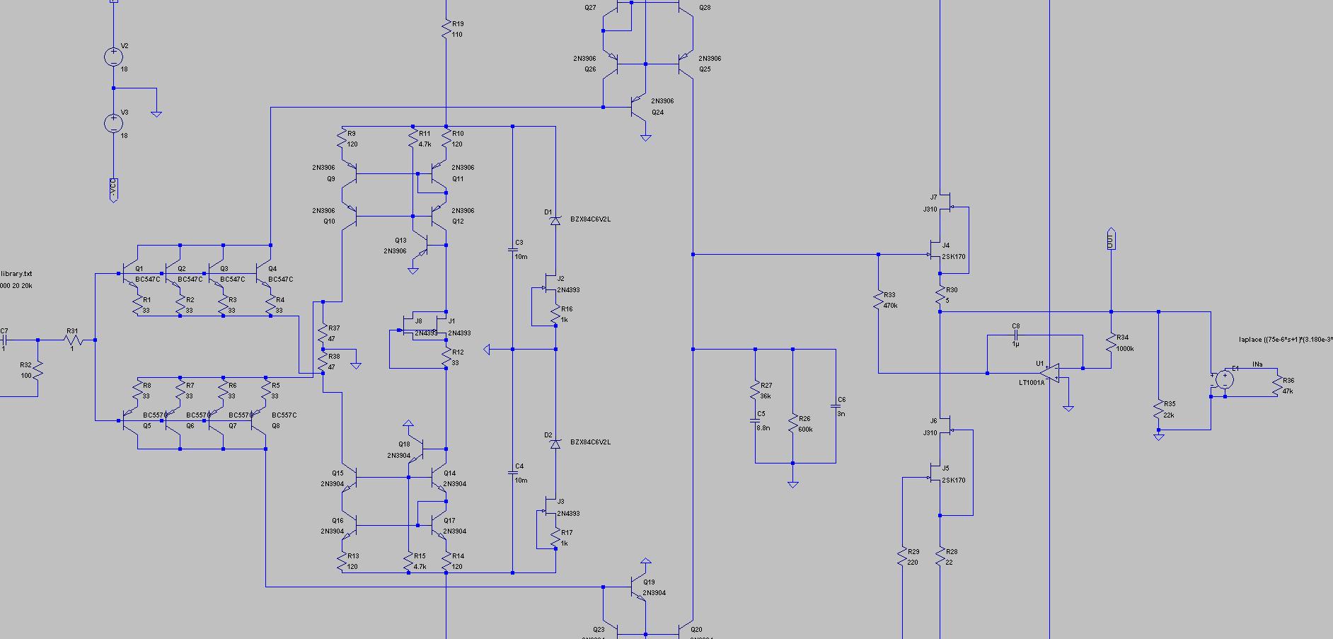

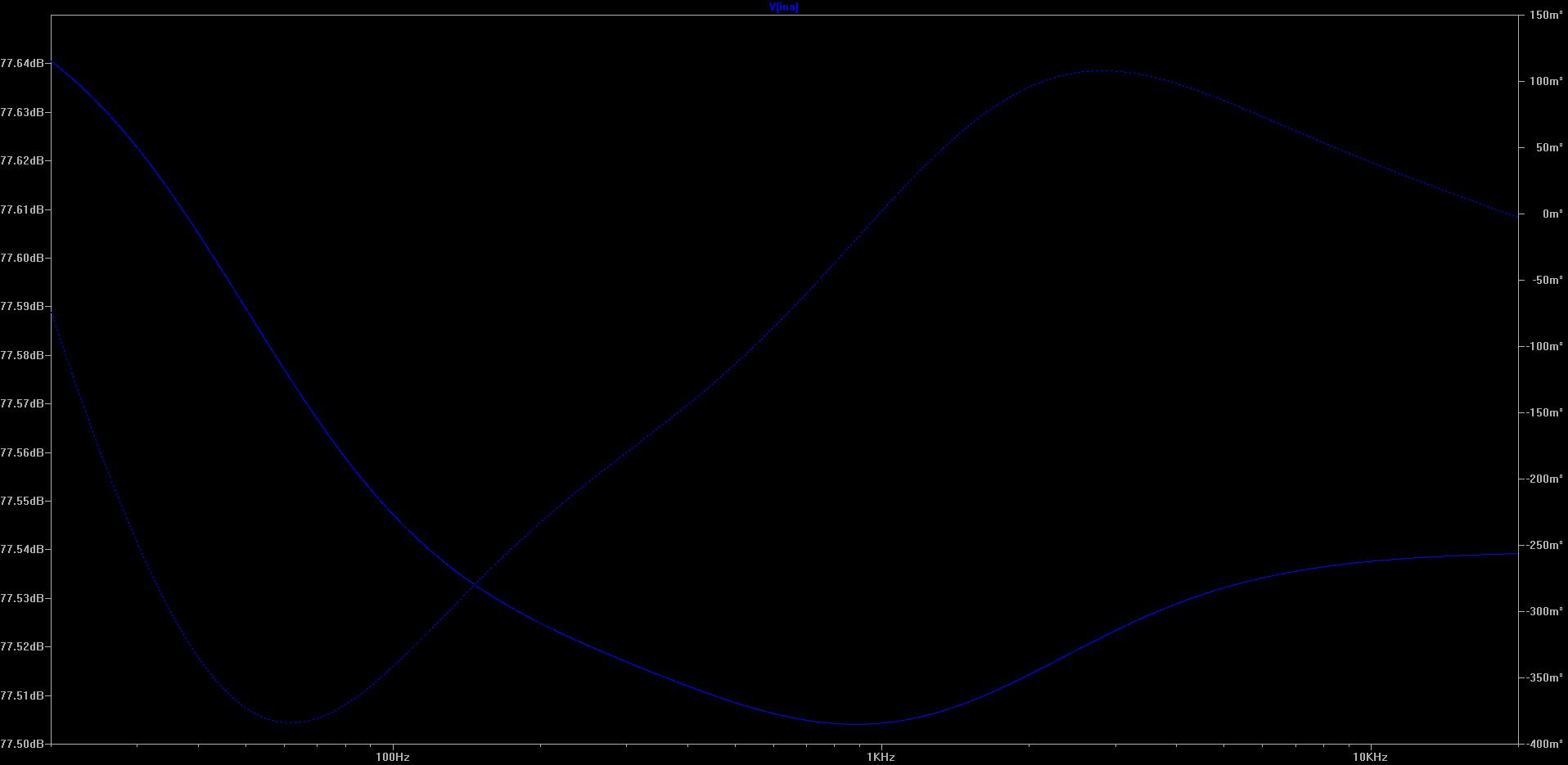

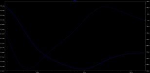

Just for reference: one of the time constants I typed in on the laplace was wrong.
Fixed that, RIAA back on track.
I just see a little bumby behaviour at low frequency that could easily be tweaked.
I was wondering if the 2 13.6mF caps on the signal (the high-pass filter that lowers DC gain) can be replaced with a resistor and if that could still work.
I have simulated it and tweak RIAA values and got the results below.
The only thing is that it looks like I can't push the gain any further up and I obtained 57dB at 1KHz.
Also I don't know if this arrangement can cause problem with DC offset/drift and I am wondering if the Servo can adjust some extra DC drift.
Below the circuit, I wonder if you guys could comment it and let me know what you think.

Thanks a lot Stefanoo, that matches much better with my hearing results ;-))))
I am glad that the simulation helped a little bit.
My question is though, why would we want to have a non-flat response on the bass?
This configuration might offer an unwanted warm sound presentation.
What do you think?
In fact, the bass I am hearing is very precise and see-through, it does not have warmth to it in my opinion - it is more like a muscular athlete.... this was comparing it to the Paradise R1 (which arguably is just a touch flatter), and the FPS (same thing there), both have just a small tendency of being warmer in the bass, not much though. I was using headphones to compare (K701) so the room played no role in this.
have you tried and increased C8 (in the servo), to see if that changes anything? I also see you are simulating the "old" servo circuit which MiiB calls "funny"... please check the latest schematic (R3) over in the group buy section for how this is done now.
maybe you just want to build and try, eventually measure it (now where is that anti-RIAA again....), and I will try to measure it next week when I am back (currently traveling...)

For a more precise replacement of the BC327/337 use the BC807/817-40 that come with LTspice.
The strange servo works in parallel with the RIAA into a low impedance point, the very reason why the gain is to low, and it impacts the RIAA curve as well. That's the reason I changed it back. Also I believe the servo is less intrusive when i works as an adjustment though the household, compared to when it works in the signal path.

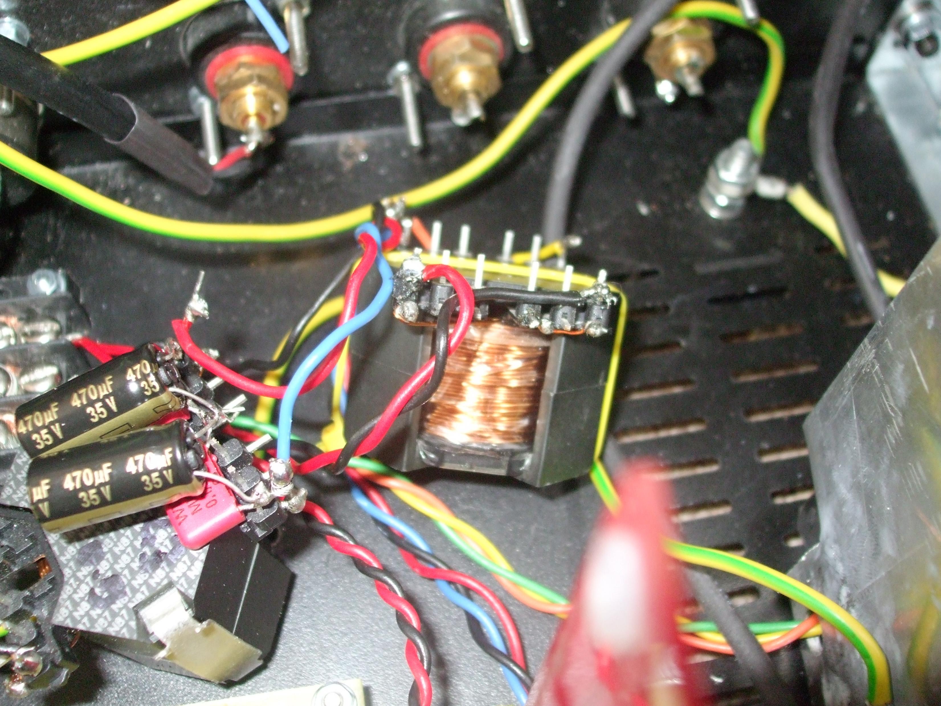

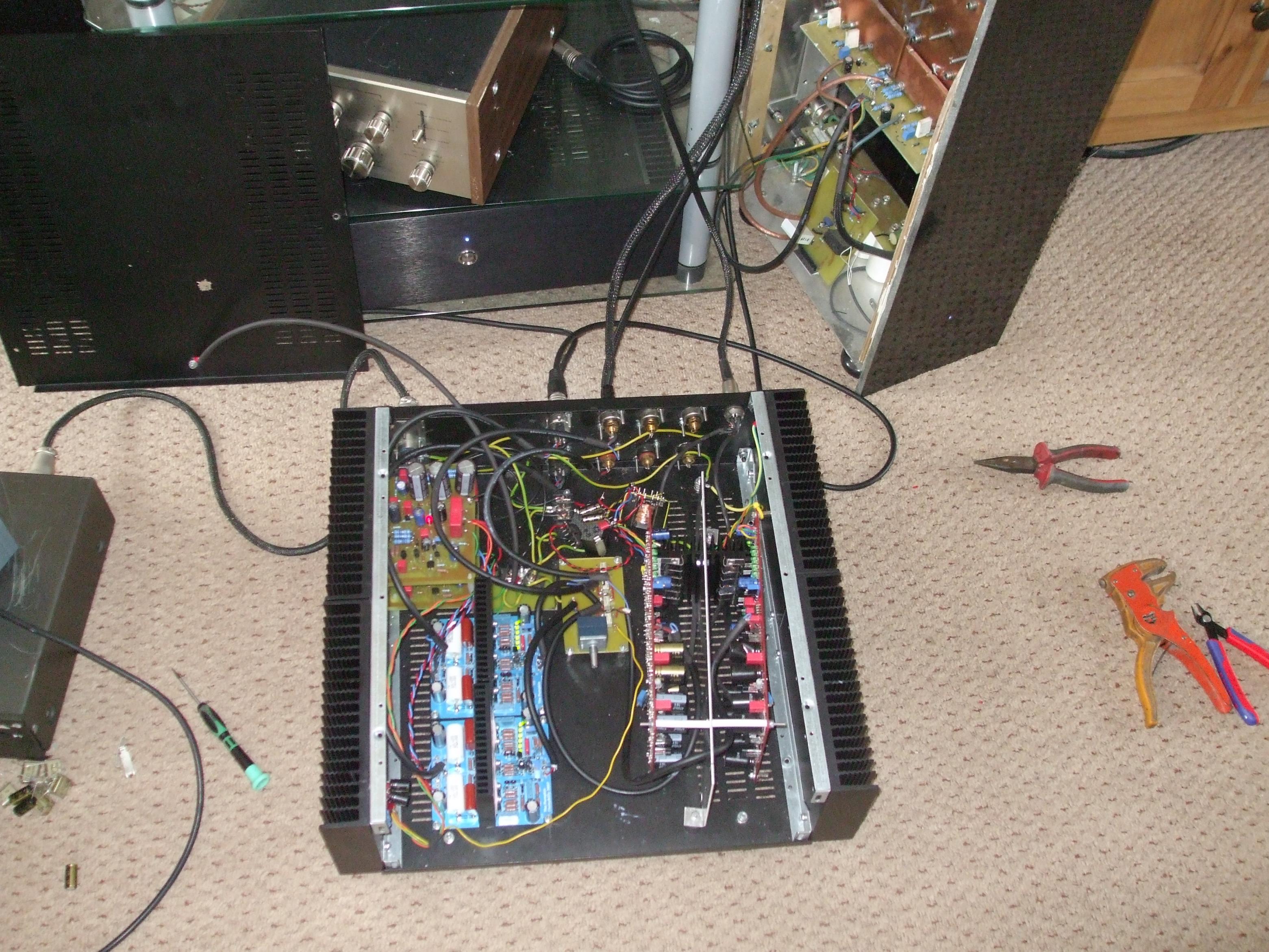

As a temporary mesure I have aded a common mode choke to each of the channel after the single pre-regulator board.
Considering the big change this made I am going to trow a lot on next V3 build, 2 better trafos better and 2 off pre-regulators is going to be just the start.
If you are going to build this split the suply and consider this Garbage in Garbage out.
