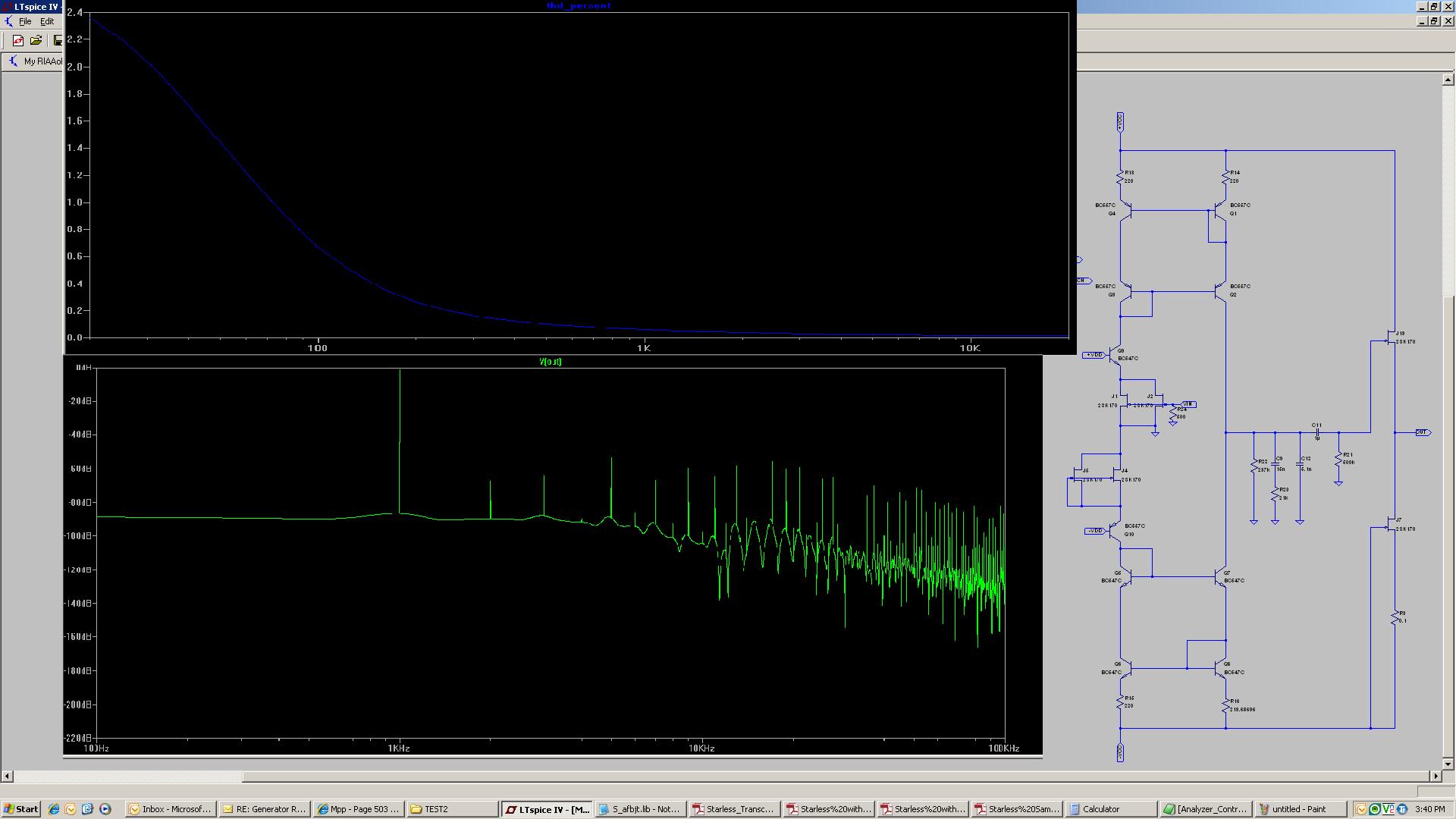

I tried to simulate the starless circuit using LTSpice.
In attachment my simlation results with THD Vs. Frequency and FFT 1mV at 1KHz input.
It looks to me like something is not right with my results at least.
I will try to breadboard the circuit shortly and make measurements on it.
Meanwhile if anybody here has some tips as for why my simulation looks odd please let me know.
Thanks.

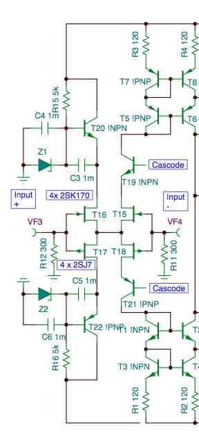

OK, this is the circuit with the negative side as constant current source. We decided not to use it because only one side is amplifying.
What we could do is a Paradise R2 but with JFets at the input arranged symmetric.
An input like this is balanced symmetric at the input and transforms to unbalanced.
I would build the mirror, RIAA and buffer the same as in the Paradise R2. That has proven to work best and is unproblematic. I would cascode the J-Fets for lower distortion and lower input capacitance. Maybe MiiB has another opinion and we do not cascode the Fets.
Then it is really a Paradise R2 with balanced JFet input. We could even use the existing PCBs with some modification.

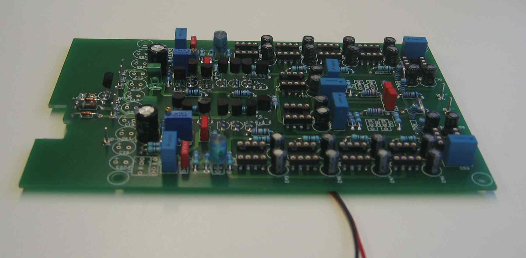

At the moment I am working on my little design 3 stages passive RIAA No Global Feedback,battery powered with shunt regulators and sub-regulators trying to get output noise to an acceptable level.
I have been struggling a little bit with that due to the compleity of the board (I had to design a 4 layer board to optimize the ground plane but maybe that was an overkill).

Stefano, a balanced input can make sense with a phono stage. You are right : a cartridge is not balanced but what i call floating. Balanced would mean that the cartridge had two windings per channel out of phase and the middle referenced to ground.
So why can balanced have an advantage ? It is hum pickup. In a well build table this is not a problem. Even with an unbalanced input hum can be very low. On the other hand there are turntables where the arm is not shielded for example, or where is noise ingress from the motor. Under this conditions a balanced input can help to suppress the hum. One disadvantage though is that a balanced stage has 3dB more noise when the same amount of input devices are used. Say we use 4 x 2SK170 plus 4 x 2SJ74.
The unbalanced stage will have 0.3nV/qHz noise and the balanced will have 0.45nV/qHz noise. That is still 6dB better then an AD797 but using Fets there is some 1/F noise under 1kHz.

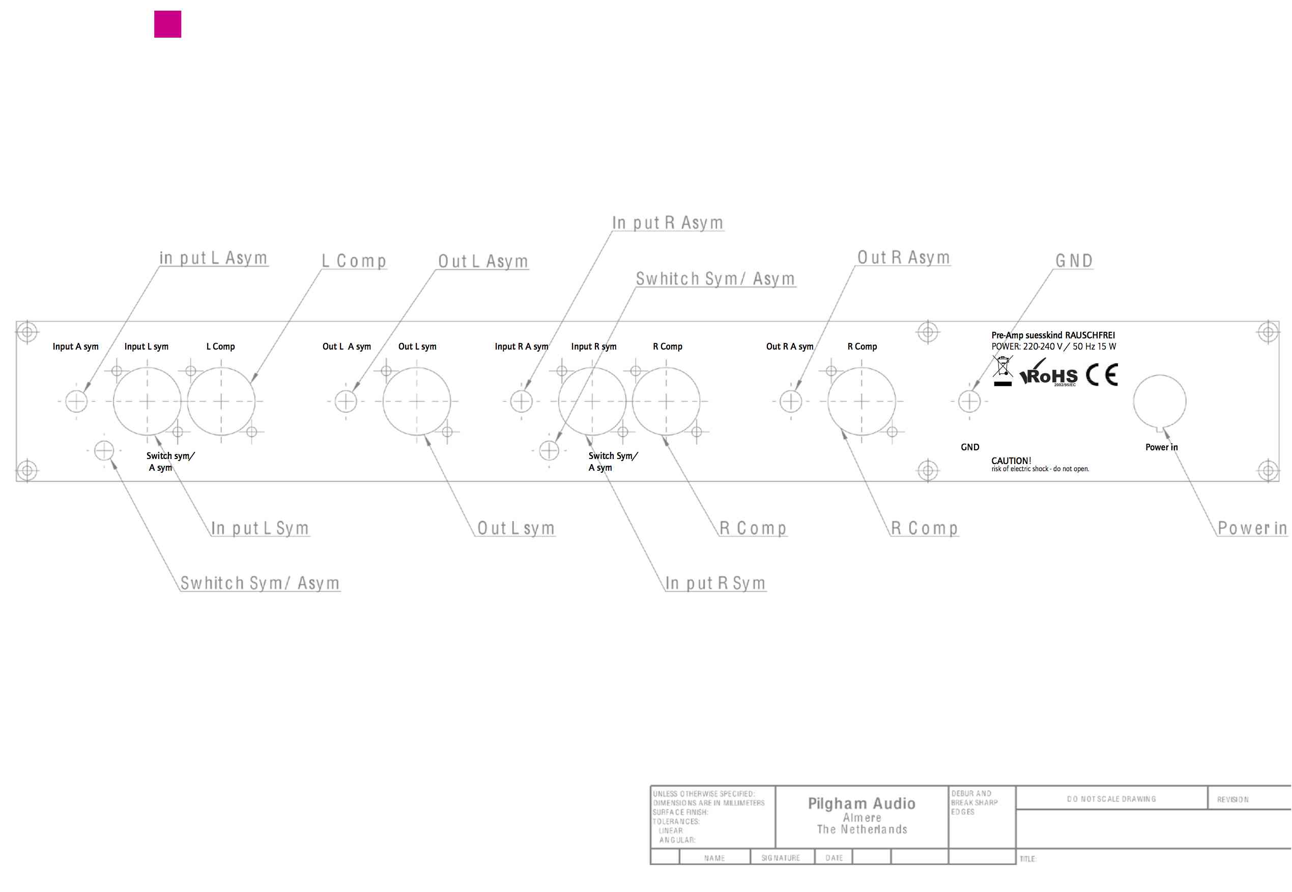

I make a commercial stage, the Suesskind Rauschfrei, that is totally balanced, in to out.
It also has unbal in - unbal out, bal in - unbal - out and unbal in - bal out.
It has a lot of discrete components in the input ( Jfets and BJts), and the PSU plus 32 opamps, 2 fully balanced opamps, two bal-unbal converters and 8 !!! servos.
AHH yes, there are two opamps in the PSU too.
I can really not imagine that this can be build DIY unless you are a professional.

Unfortunately 4 Layers is more expensive and most of all, if you want to have a special dielectric like Teflon it is very hard to obtain.
