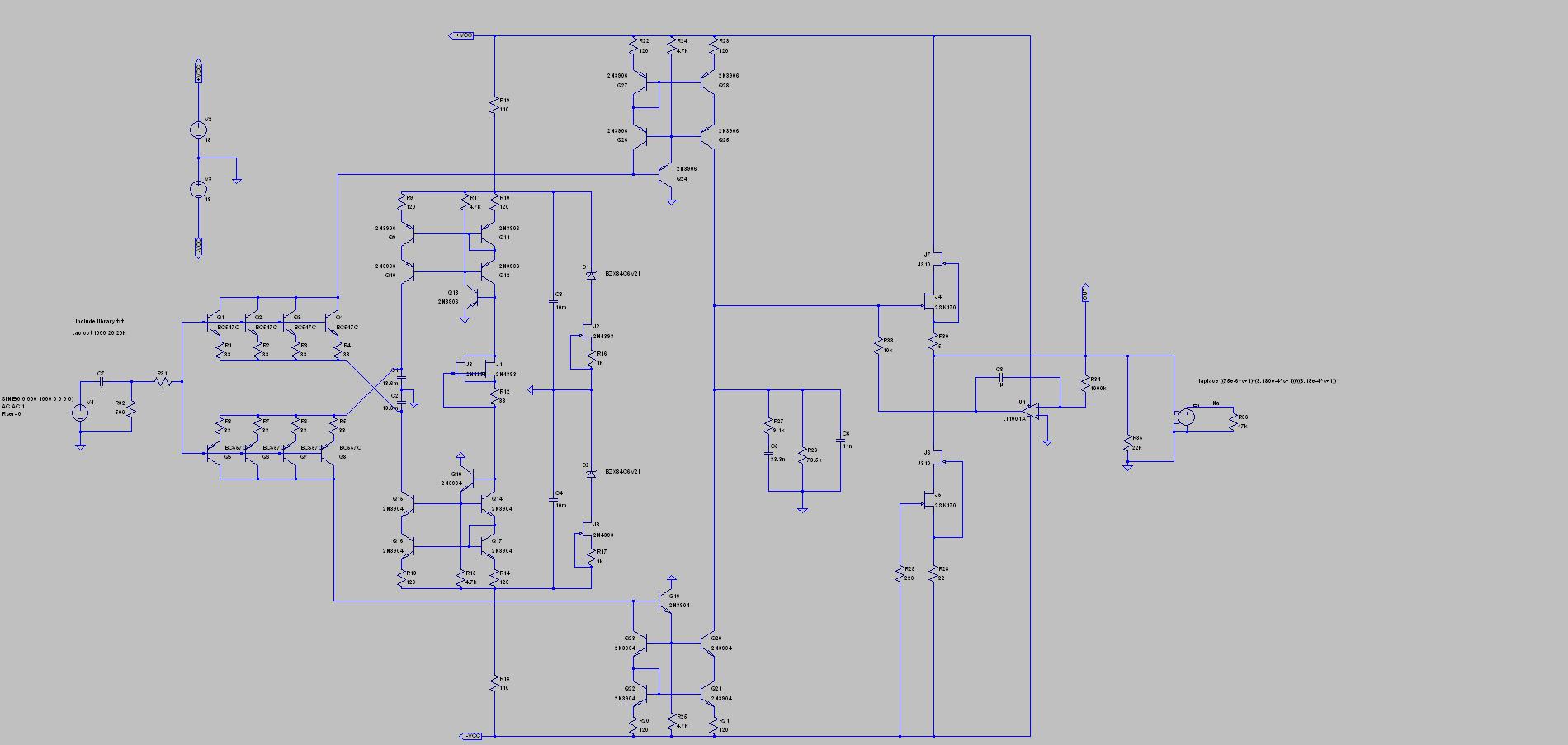

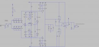

Reading this thread I have seen you posted several designs for buffer and said that your favourite one is the one copied here.
I wanted to ask you if after all this time is passed since you posted that, are you still with the same opinion?
Also, I am trying to design the servo around the buffer to use to correct the DC offset of the gain sage before that.
Unfortunately I wasn't able to make it work on the simulator.
Could you please give me some advice on this?
Thank you very much.

Yes, that is my favorite BJT buffer still. It really sounds amazing. In the Paradise R2 we went to the simpler floating cascode J-Fet buffer because we thought that the BJT buffer could be responsible for the oscillation we found at 40 MHZ. At the end we found that it was the layout, especially the decouplig of the mirrors so the BJT buffer is not suspicious any more. In fact i use this buffer in a commercial product for L`Art du Son called Buffalo Bill without any problems.
I see that you earthed the connection between R11 and R14. How should the servo then work when you shunt the output to ground ?

One way is simply trimming the offset. You can use 3.5kOhm for R11, R14 and put a 1kOhm trimmer in between, wiper to ground.
Thanks. I got that. It was just for the sake of the simulation.
On LTSpice I tried to connect the output of the servo to the wiper of the "virtual" trimmer (which is the connection to GND) of course removing the connection to GND.
Nevertheless it doesn't work that way.
I wanted to put a servo there to correct DC fluctuation of the gainstage before that.

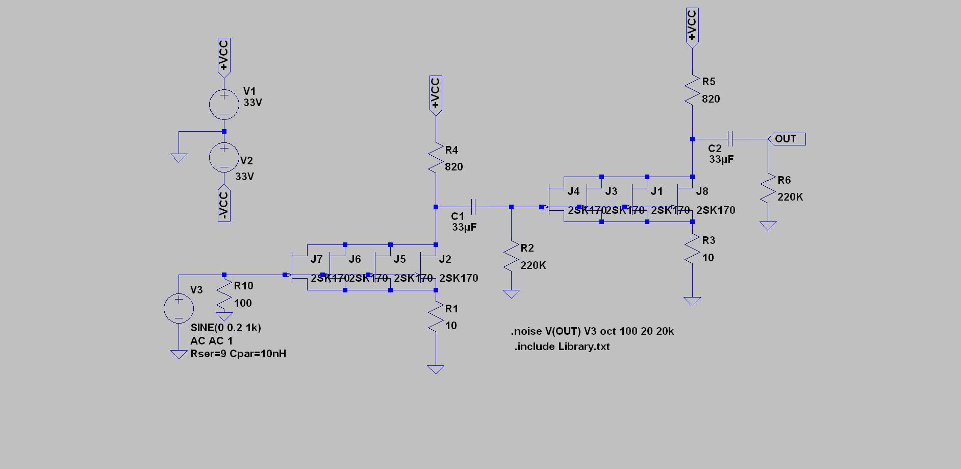

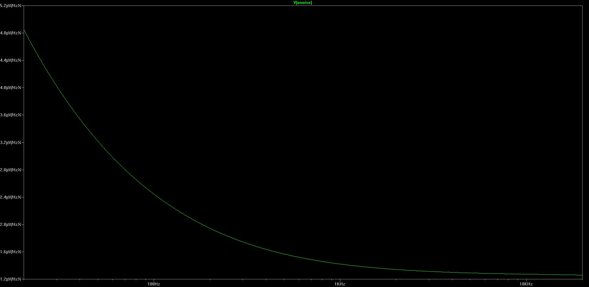

Lately I have been questioning my batch of K170/J74.
I have been trying to prototype the high gain circuit for the phono and everything seems to have a lot of popcorn noise, which is not possible for this kind of device.
So I decided to run a test tonight on the 2SK170 to see if there is something wrong with it.
In attachment the circuit I indend to run and relative noise simulation.
I would expect from it a nice wideband noise.
Please feel free to comment if you had any similar experience or to comment the circuit.
Thanks.

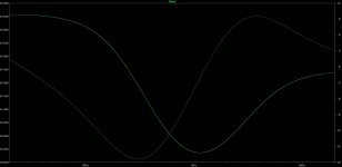

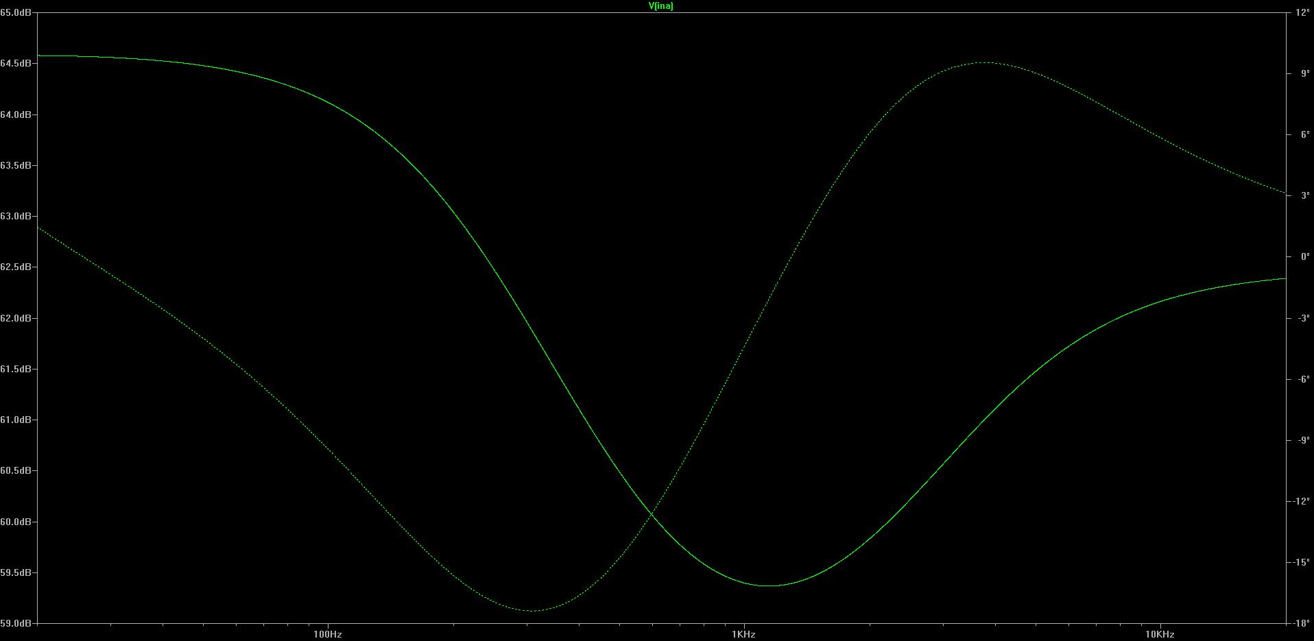

All,
I have simulated the paradise rev 2 and attached is the schematic and the RIAA error.
It shows a significant displacement from the ideal curve.
I am sure I am doing something wrong because I remember this was checked several time; if this is the case, can anybody point out where the flaw is?
Thanks.
