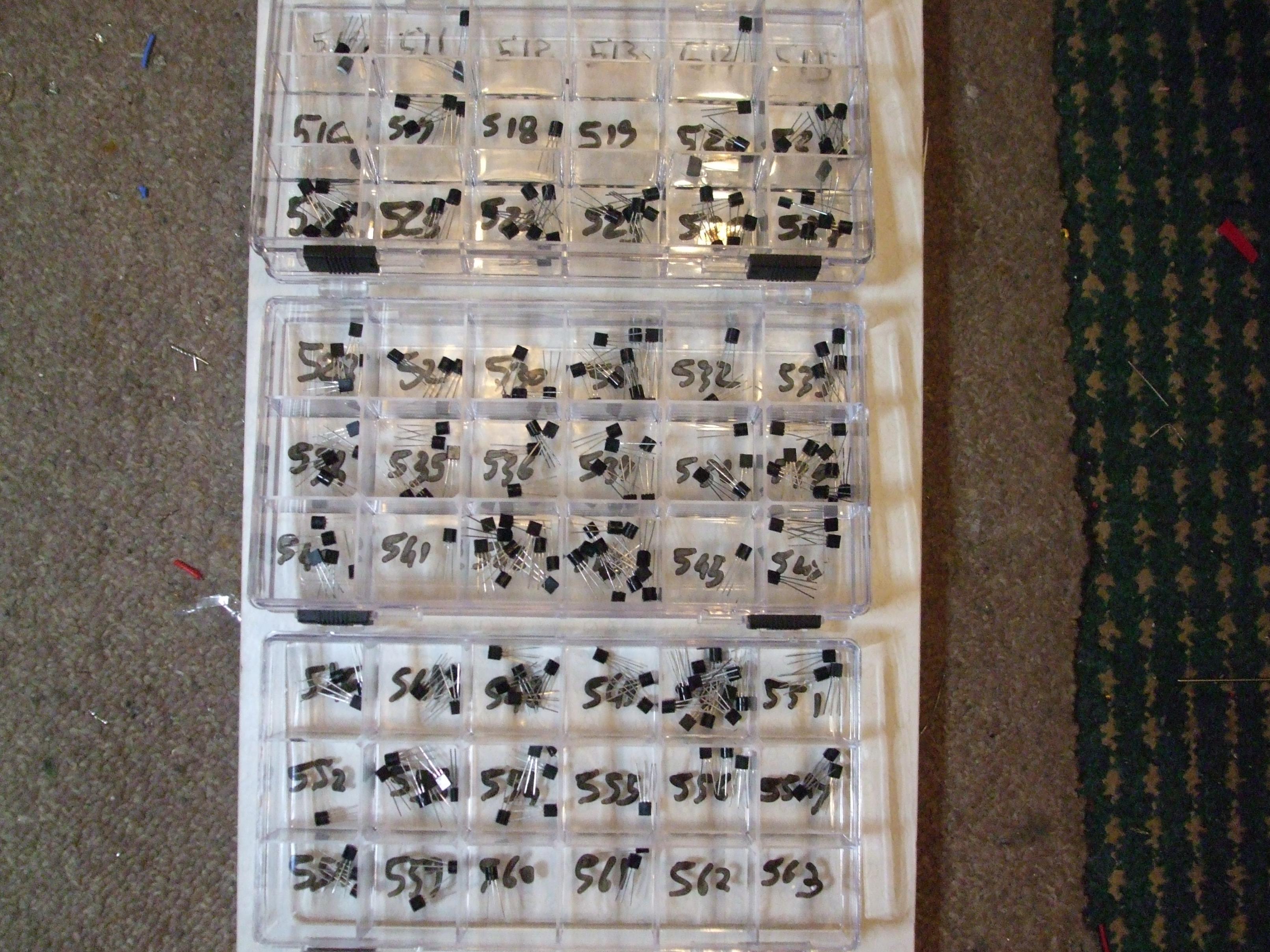

Prety nice tool, although time consuming. The shape of the curves looks very similar, so simple Hfe matching whould work too, at least for this batch of Fairchilds.
I am surprised how high the Hfe is anyway. BC550C and BC560C are not better in that sense.
Dat sheet for BC33740 show HFE from 250 to 680
from the first bunch of 50 tested I shuld be able to get quite a few sets of 18 with hfe matched in the + - 5 range
I will use the closest match possible for same part of circuit hfe + - 2
Range of Hfe for 337 is 100 to 250 for type 16
160 to 400 25
250 to 630 40

Bksabath, the original Paradise could show signs of oscillation if Hfe went too high.
Unfortunately me and others thought it is better to use as high Hfe as possible and that was one of the reasons we got in trouble. That was solved by local ground and generous decoupling.
The New Pardise is much less sensitive so you can use high Hfe if you wish.
Hfe of 400 should be on the other hand be enough to let it work well.

Got sore thumbs ploughing in the first 250 BC33740
The bulk of the batch seems to be between Hfe of 520 and 560
Once the bins are full I can start to fine sort again
I will populate boards with same (as close as possible) Hfe and select similar values between the left and right channels.
For now I am going to give it a rest and listen to a few tracks.

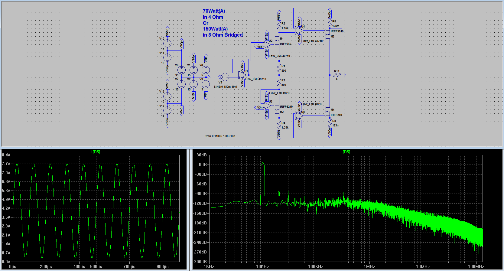

This is what I came up with (I do not want to start a new thread on this, but still I want to show the 'thing', so here it is), I guess I am spending to much time at the ATL 🙂
What about this, I can do 70 Watt class A in 4 Ohm (or 150 Watt class A in 8 Ohm bridged). The amplifier has 14 components (and that includes the loudspeaker). The simulation FFT shows first harmonic at -100 dB or better (that is at clipping and at 10 Khz). There is no global feedback. There are no capacitors in the circuit.
So that is what I get when I cannot sleep. Maybe now I get some sleep ... 🙂
