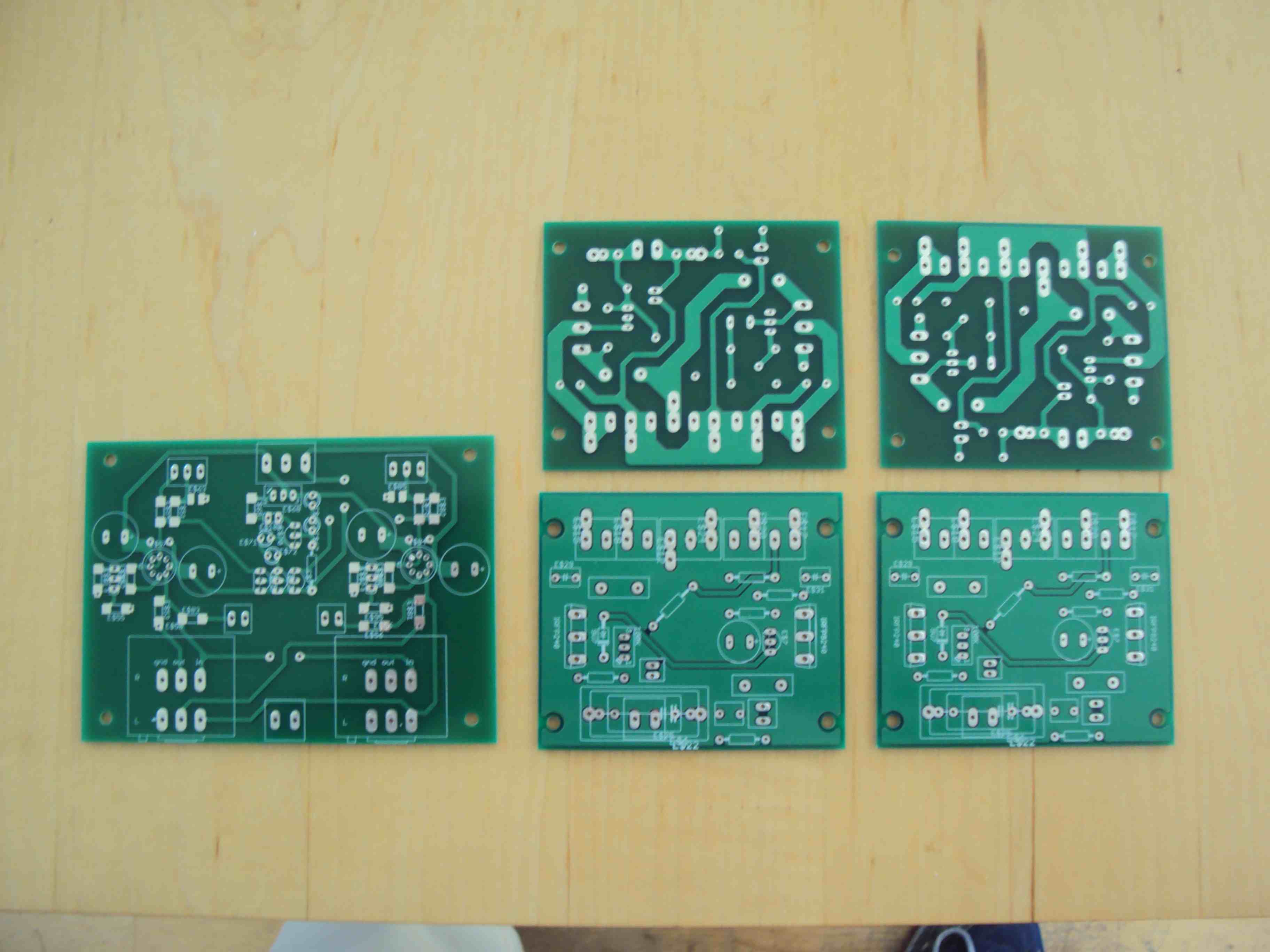

I got PCBs from Marcin.
The High Speed Preamp in the metal can version and 4 Power Buffers because i would like to try balanced.
I think they came out nice with ground plane on one side.
Looks very good, now I want to hear all this... 🙂
Me too. I am almost done with stuffing the preamp - I just suck with my parts housekeeping so while I was sure I have all capacitors....now I need to order them and wait another 48hrs.

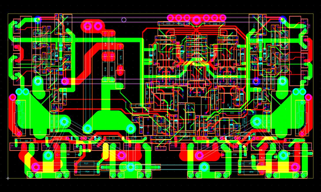

All,
This one is done, the design program has no complaints all connections are accounted for and it is ready for the press. This being my first major Amplifier design, are there any people here with some pointers, hints and 'plain old' good advice 🙂
