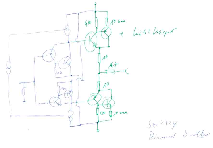

You know that i like to play with buffers. We need them for our kind of phono stages and they are useful for line stages, active filters and driving headphones to mention only a few duties. You may think : why another buffer ? The driven cascode buffer in the original Pardise proved to work, the oscillation problem came from decoupling issues in the mirrors. Also the floating J-Fet buffer in the new Paradise works just fine. It is one of the most " not there " circuit i ever NOT heard.
What can happen on the other hand that we need more juice then the J-Fet buffer can supply, for example for low impedance headphones, or there are no J-Fets in the house.
In that case the circuit i will show could be a solution. Here i simply substituted the BJTs in a Current Mirrored Diamond Buffer with CFB ( also called Szikley ) pairs. A Szikley pair has very high current gain like a Darlington, 100% local feedback and only one Ube drop in the signal chain. I found an older hand drawing i had made with a Szikley output stage and just added the input stage today. Funny, that this arrangement did not occur to me in the first place. The circuit is only a concept so values of the resistors may change.
Actually the guy that invented it is called "Sziklei".
Sziklai pair - Wikipedia, the free encyclopedia
Here is some good information how to design a Sziklei Class AB current amp :http://www.tedpavlic.com/teaching/osu/ece327/lab7_proj/lab7_proj_procedure.pdf

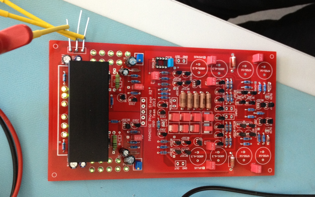

On the new paradise, power supply worked at first turn-on, take a look! No external load resistor needed, the shunt is enough load in itself. The heatsink doesnt get very warm (I had +/-30V at the input, current was 120mA each).
Hope to have good news on the amplifier section soon.......

What i do not 100% understand : I see 3 x J310 in the buffer and only one 2SK170.
There should be 2 x J310 and 2 x 2SK170. I also can not see the output DC offset trimmer.
