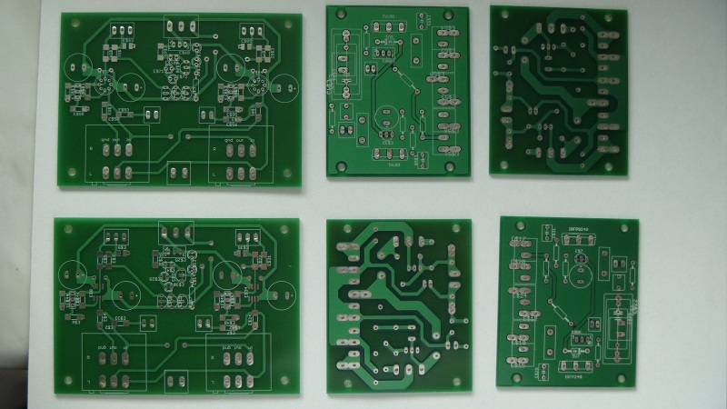

Today I picked up the boards for power buffer and high speed preamp.
I will start assembly a.s.a.p. - but not before monday. The gerbers need correction as the layer I've been using so far for silkscreen was not printed by this PCB manufacturer so to avoid problems for others (gerbers will be available for others) I will manage it with other layer. The photo shows prototypes - on top left to-99 version for preamp, below is smt version. Power buffer boards x4 on right, top/bottom side.

Hi mad_z
Your boards look very good... would you post a schematic ?
The power buffer and the high speed preamp was posted as simple hand drawings. We will of cause post the schematics in better readable form. The "policy" at the moment is simply that we first build and test and when it works without trouble we publish the schematic. I would like to avoid the delay we had with the original Paradise.
