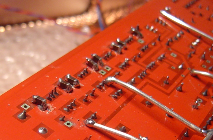

Here is how I implemented the emitter caps in the paradise R1. Not my most beautiful soldering work, but does the job...
How to do it: Scratch away the solder-stop from the ground plane, put solder there, put the caps in (touching the resistor wires), soldered on the GND side first then on the other side. So the caps are effectively from VPLUS or VMINUS to GND.

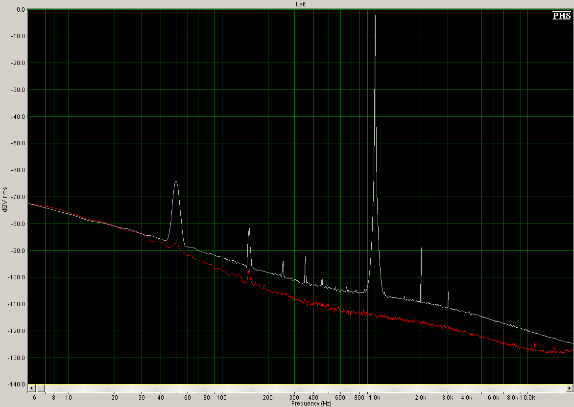

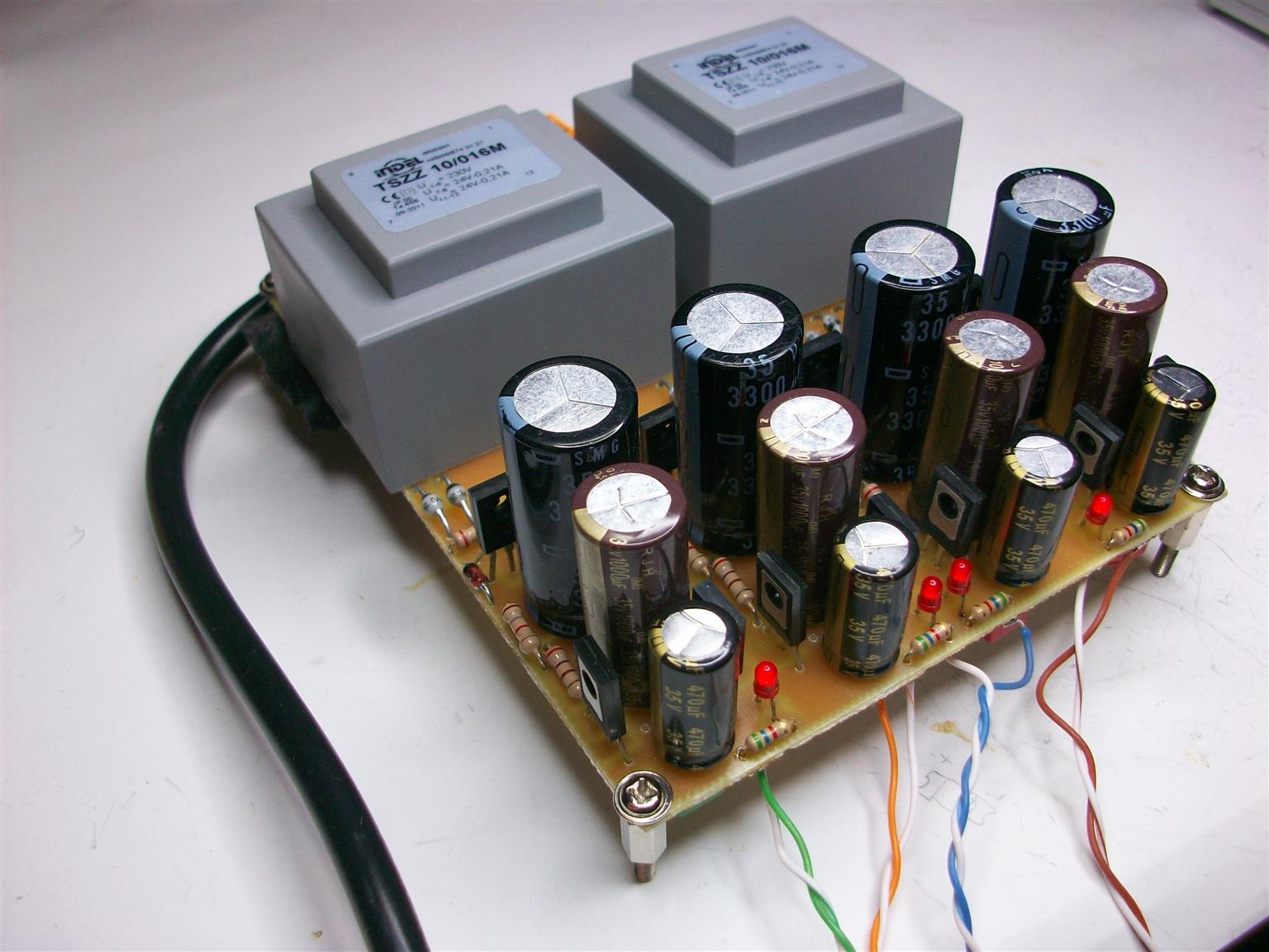

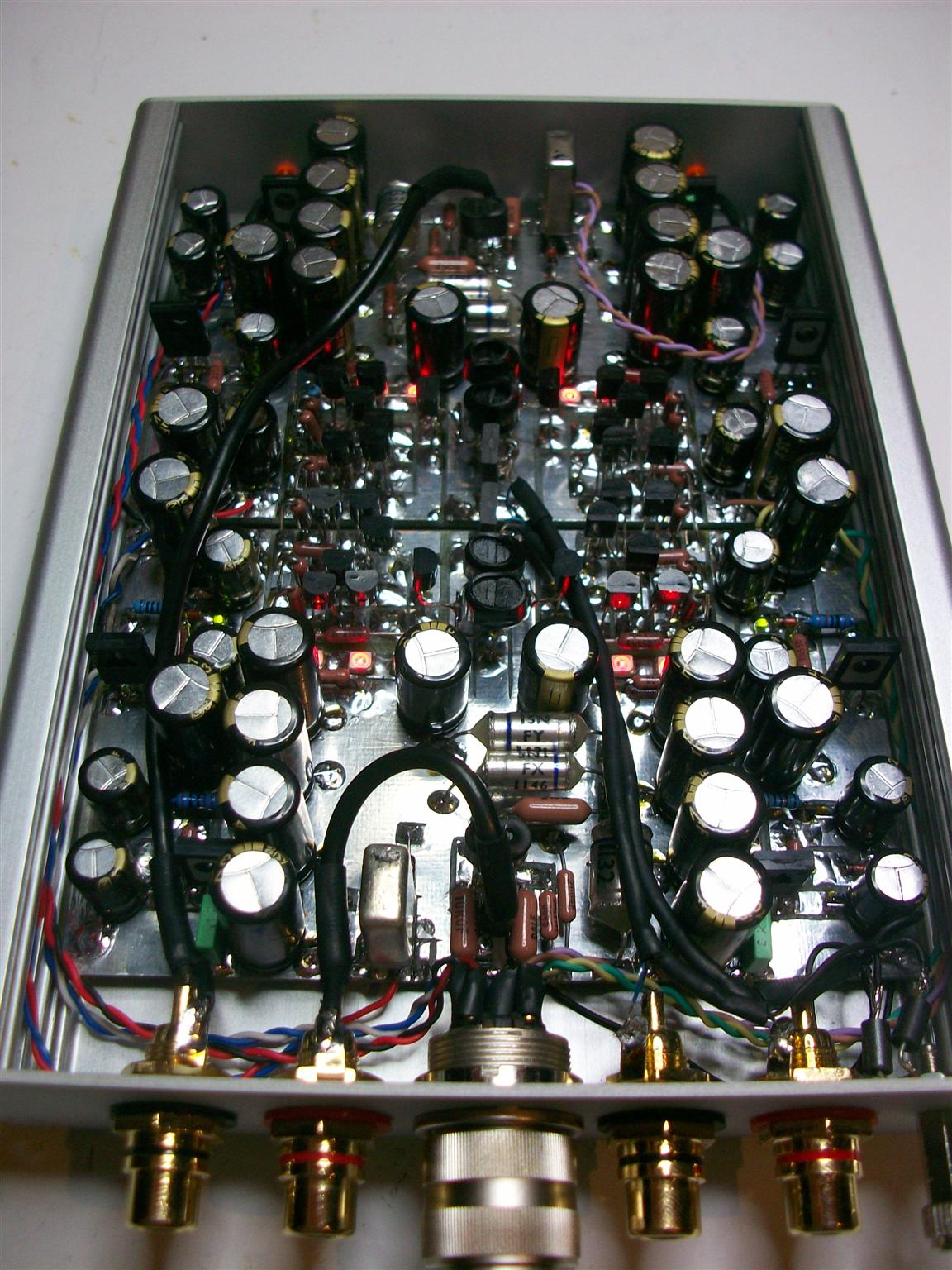

I dropped by to post my final build of Joachims naked truth. Attached is a couple of pic's which should be self explanatory. I decided on coupling cap vs. servo on this one based only on my own subjective listening preference, so maybe just a couple comment's on psu are in place here. I made quite a few shunt regs (salas variations, walt jung etc.) with very good looking measurements, near ideal step responses, low and ultra low output dependences, good noise specs and so on... but nothing had beaten simple cap multiplier + pana FC for my own listening experience. They are (shunts) excellent in simple se aplications like salas ar srpp, where you get big boost on whole audio range, but for this pp stage I felt that sound was just too unnatural. Next there was big disappointment when I went from battery psu to simple transformer psu. Now matter how much I tried to improve regulation, ripple rejection or other parameters there was "something not right". So I got on usual suspects - namely ground loops. I'm quite paranoid about this subject but luckily all my other audio chain is designed by me and I just couldn't find anything wrong with it. So after some puzzling I was left with only one suspect - transformer inter winding capacitance which could theoretically mess things up a little bit. So I convinced my self for n'th time in my life "there is no such a thing as a ground" (thanks to my old prof. of electronics at uni. for this one) and both incoming and returning currents should be treated as equally important. This led to some research on balanced or common mode regulators which brought me to a great thread by ecdesigns which I haven t' followed for couple of years now. PSU that you see in attached schematics is based on his approach with couple of my own brushes (input voltage/peek current limiter). And what a surprise, it's as close to batteries as I could get ! Massive impedance seen by transformer really helps and you could say that ground is "born" right there were it matters - on a stage's ground plain. So this concept is worth investigating IMO. All at all I'm listening to this stage right now in my system and I'm more then happy with it's sound 🙂
