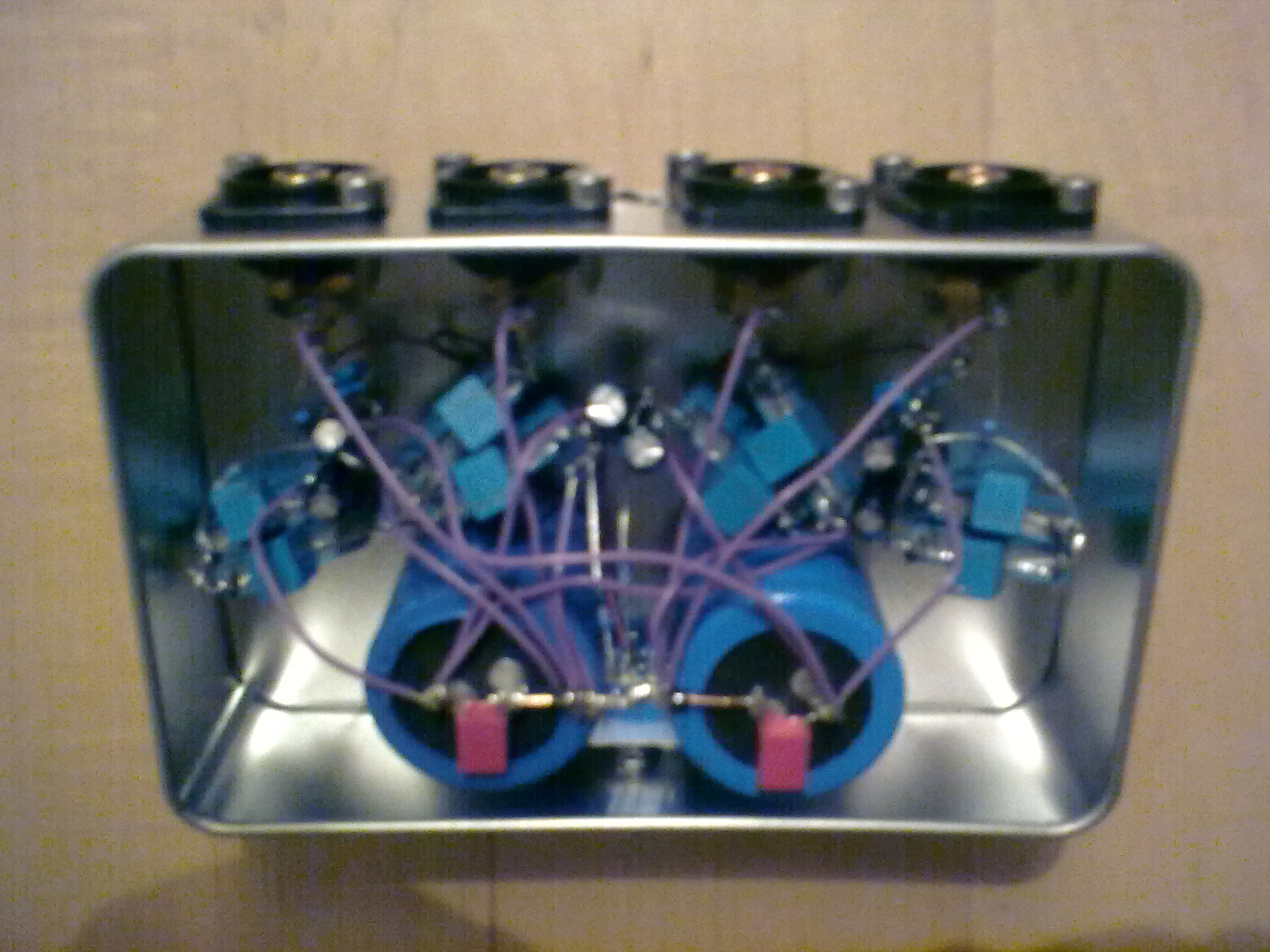

Today i build the time domain subsonic filter or TDSF how i will call it. This time without fancy opamps because i had to use what i have at home. i took the workhorse OPA2134 for the input buffer and the old chestnut NE5534 as output buffer. I thought with the benefit of 100% feedback they whould do the job quite well. No dual mono power supply ether this time. Only two 9V alkaline blocks into 5600 uF Sprague elcaps, bypassed with 1uF Wima MKT and lokally bypassed with 100uF elcaps on each chip. I did not scimp on construction and did a 100% star earth grounding the way i learned from Dennis Morecroft. I used my favourte caps though: 0.1uF 630V Rifa PHE450 in parallel with 0.1uF 160V Röderstein/Vishey MKP. Resistors were standart 1% metalfilm.
I used the TDSF between the RIAA stage and the preamp and first checked for noise. Inserting the circuit i could hear no rise in hum or hiss, ear at speakers, high volume. I also installed a bypass switch.
Listening and using the circuit was quite fascinating. It did surprisingly little damage on the signal and it even improved certain aspects of the sound, the higher the playback volume was. What it lost was a certain siruppy and liquid, honey like tone in the bass and fundamental tone aerea and some feeling of depth (not in imaging but in size). It was replaced with a tighter, faster and more precise redition. Cone movement was not zerro, mind you, at high volume but the low frequency back and forth movement was gone. What i liked too was more precise focus and higher dynamic range. When the unfiltered signal could go on the nervs at extrem volume the filtered version could be played much louder without fatique. impact on imaging was little except the improved focus and slightly reduced size. Micro detail was intact so i can now safely recommend standart high feedback opamps at that voltage level. I am still not convinced if high NFB is a good choice for the first stage of a phonoamp or an I/U stage of a DA converter but here it did no harm even on tiny signals like acoustic information and micro noise. I wonder now how i could have lived without the benefit of a good subsonic filter for 35 years but the ones i tryed so far did not work. Most of the time they took away bass slam without the benefit of much reduced cone movement. I had to design one my selve to resolve the issue. This circuit may not work it´s magic i any system but i think a lot of people have a medium stiff cartridge in a medium to high mass arm. Highly recommended ! I will play that stage in Vegas after hours and i am eager to hear other opinions,

Yes, it´s after the phonostage and you can bypass it. The idea is also to compensate for the rising trend under 20Hz due to the resonance of cartridge and arm. In fact if you send me the response of your system for example measured with the Doc Feikert software i could calculate a matching filter. I will also design a kind of equaliser that will be able to follow other equalisations then RIIA AFTER the normal phonostage and also has the ability to compensate for room (notch filter) and programm deficiencies. Kind of modern version of the Cello Palette. Martina Schöner really bugged me for years on an universal equalizer ( she likes opera from the fist halve of the last century) but i never liked the concept of switching IN the phonostage, so that idea came up. My fortee is filters, i am a speaker guy from profession.
I do not use feedback in the TDSF so source buffers can be substituted for the opamps.

Rüdiger, sorry if i have confused you. You will see the circuit i used tonight in the attachement. I think i have not published it in full here. see the 25mH coil. That makes the circuit inductive. Between this stage and the preamp i used my new subsonic filter called
TDSF and not TDFS as i wrongly stated. It´s an acronym for Time Domain Subsonic Filter. If you have any questions about the whys and whats of the circuit i can explain in more detail. How does the Instrumentation amp comes about ?
I show the TDSF here implemented with source followers. You can use any kind of buffers here. if you go back on this thread i have shown plenty.

Ok, i am looking forward to it. It´s not an easy circuit i know but i wanted to look into instrumentation amps and symmetric RIAA too. In fact i made a commercial Phonoamp based on Instrumentation priciples that worked well. It had extremey low distortion and was very imune to hum.
Today i talked to Siegfried Linkwitz and he was wondering how i did a 6th order filter with only 4 capacitors. Well, again i simulated the TDSF over a 100dB dynamic range and yes ! he is right. It´s a forth order sub Linkwitz response with constant group delay.
But still it´s -60dB down at 2 Hz and i think it´s efficient. I liked the subjective result so much that i will keep it that way.

Hello Sam ! the parts you choose should work. I tried the 2SC3329 and 2SA1316 in the Rositer and they are as good as the ROHMs. I did not try the 2SC1775 and 2SA872 but any decent low noise low level transistor with a high and straight Hfe curve should work here. The OPA637 are still very good. I use them as a distortion magnifier in my measurement setup.
It was planed to use 900mH coils but after i got the 25mH coils for the RIAA i used them too in the power supply and decided that they are big enough. Implementing them inproved the sound a lot : cleaner and more transparent. You can buy the coils from me. A single coil costs 10,-€ plus shipping. Tolerance is 5%. A pair of coils selected to better then 2% costs 50,- € plus shipping. They need some shielding (Mu Metal) or you can get a low level hum.
I did not use a servo in the TDSF. The offset was quite high with 30mV on both channels due to the poor DC precission of the NE5534 but no problem in my system because i have a cap in front of the poweramp. When you use Fet opamps like OPA134, OPA827 etc. offset should be under 1mV. If you like bipolar more something like the LT1468 gives good DC precission too.
