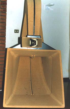

Thanks Salas. I feel honored in that company. My company with Allen Perkins is even called "Sonics" but it is now american owned. And i had to go to Japan to my first listen to a Klangfilm system at one of the Beta Testers of SACD. In fact i heard the first recording they made on DSD. It was a Japaneese violinist recorded in an english studio.
We sat on a long table and i had to turn my head because the Klangfilm horns where mounted sideways ! Very clean sound and surprisingly low colouration i remember. Later we whent out to an Italien restaurant in Tokyo and the Sony person started to teach me about italien food ! That was weird, really.
