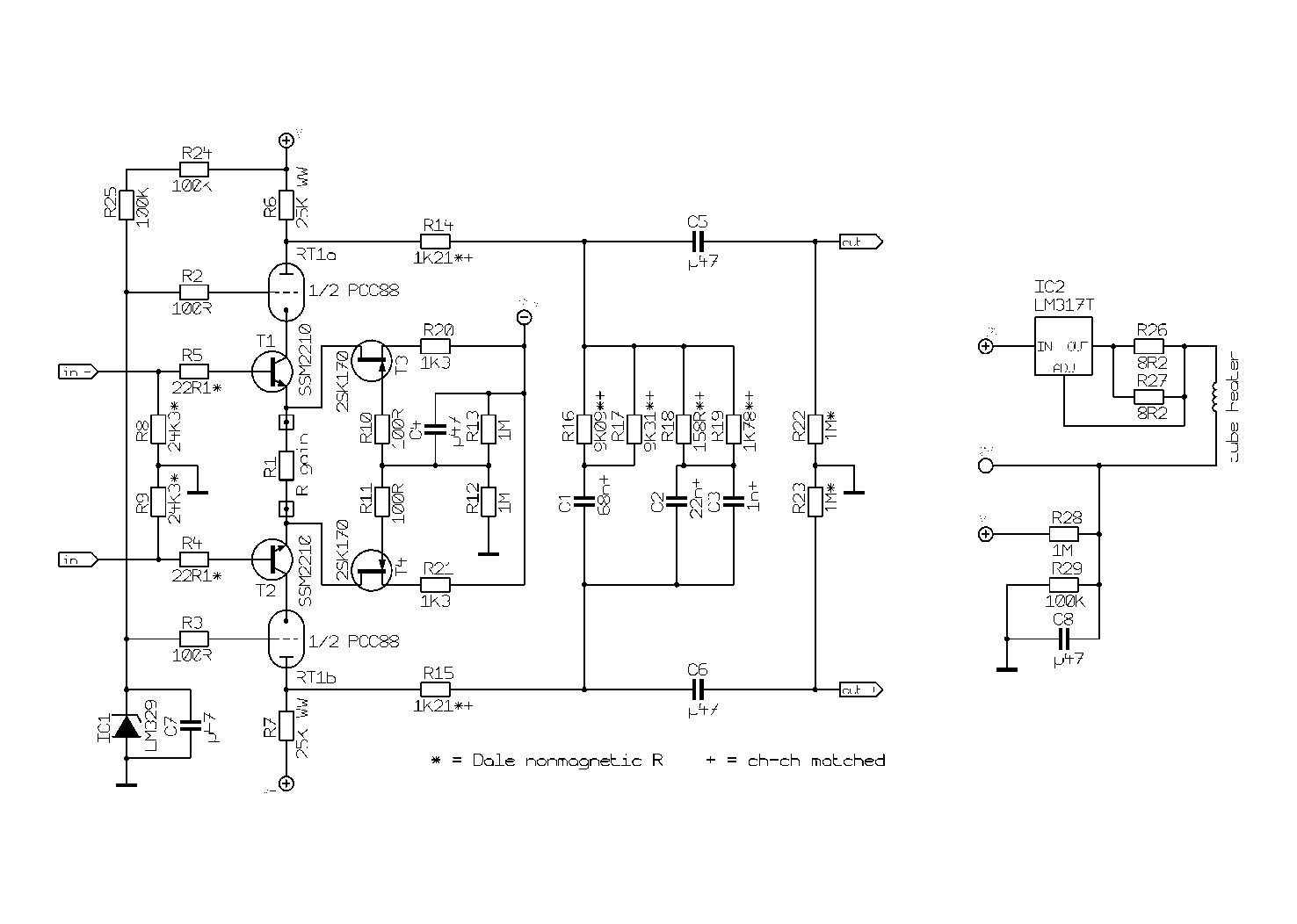

Attached is a schema of the phono section, it feds a balanced selector and attenuator, and a simple/complex line stage.
If you send me your mailing address, I'll send you a Xmas present.
Very interested in your opinions.
Regards, Allen

No pun intended Allen, but I would be really curious what are the advantages (or secret ingredients for performance) in this schematic. That's because by all engineering standards, it has poor performance (noise, input impedance, offset, etc...). I also miss the purpose and advantage of cascoding bipolars with tubes.
Was it designed following "subjective sound" criteria only? That would explain some of the decisions...
syn, you have me scratching my head. Noise is very good (0.8nV/rt Hz), the tubes give very large and linear swing, input impedance well high enough to not bother a cartridge. No output offset, it's cap-coupled. What's the objection?
Stu, I am scratching my head as well. For example, 2x22ohm in parallel with the input makes 11 ohm, or about 0.4nV/rtHz noise by itself. And this is before considering half of the emitter resistor.
I would understand tubes in a gain stage, but what's the advantage of a tube as cascode? A high voltage mosfet will do exactly the same, while the cascode noise doesn't matter anyway.
Using the SSM pairs, what's the current noise of this amp?
And why feeding the RIAA network from a finite impedance, while a (e.g.) folded cascode (like in the Vendetta) will provide a very high impedance?

I haven't looked at the distortion spectra for MOSFETs on top- I have seen Allen's results with FETs on the bottom, tubes on top, and they're quite good.
[QUOTE=syn08;
but I would be really curious what are the advantages (or secret ingredients for performance) in this schematic. That's because by all engineering standards, it has poor performance (noise, input impedance, offset, etc...). <<<
Can you please explain why it has poor noise, poor inpt impedance, poor offset - and why these, other than noise, and to a very small degree, offset, are important in a MC phonostage?
Was it designed following "subjective sound" criteria only? That would explain some of the decisions...<<<
I'm happyto amswer your questions after I'm clear as toyour complaints.
Regards, Allen
Syn, I believe you are focussing on engineering princlpals without regard to anything else, especially practicallitiy and sonic results.
We all have our preferences, you say "Transformers -yuk" and I agree with you. But you suggest a HV MOSFET and i say YUK. You use huge amounts of NFB to get distortions way below anything a human can sense - i personally HATE using NFB and have developed my circuits over 30 years without it.
The 22R input Rs are there to stop the whole mess oscillating at 30MHz or so.
The cascode bipolars/tubes were a R&D development when atube/tube casode was way too noisy for MC, and jfet/tube didn't have the 72dB gain in one stage (before RIAA eq) I needed. The MAT02 does the job and is VERY quiet in practice, Maybe not as quiet a 10 of them in parallel but more than enough for all cartridges I own, including a 100uV IKEDA.
The people who own this preamp love it, and most have owned serious commercial units before. It's going up against Joachim's best, how about sending one of yours over and there can be a real shootout?
I'm game!
Regards, Allen
