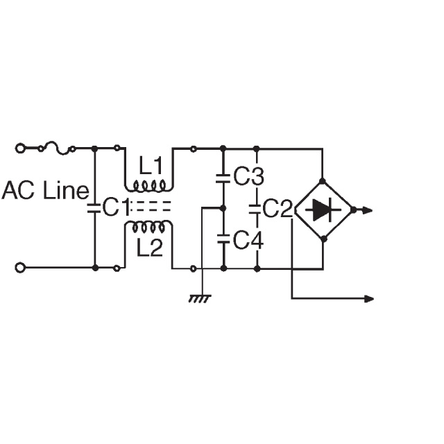

I think a 18VA is more then enough. Yes, that is a common mode choke. I would like to put some before the bridges. Like this .....

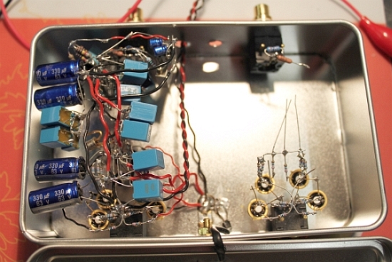

I made a first sketch of your proposal (input stage only)
Results are not encouraging so far. I used a pair of 2sk389/2sj109 and a quad of sa1360/sc3424, resistive base bias and drain resistors. Output has wandering offset between a few tens of mV, and between the sources I got a constant 200mV over 40R. Poor cart, had there been one....
Next try is with matched small-signal transistors.

This are the common mode chokes i use. They are inexpensive and good. As i already mentioned, some criticized the use of a ferrite ring. See my Nobrainer thread for the alternatives from Panasonic ( Digikey ).
CAF 0,6-100 - Stromkompensierte Drossel, 100mH, 20 - 30mm - Stromkompensierte Drosseln bei reichelt elektronik
