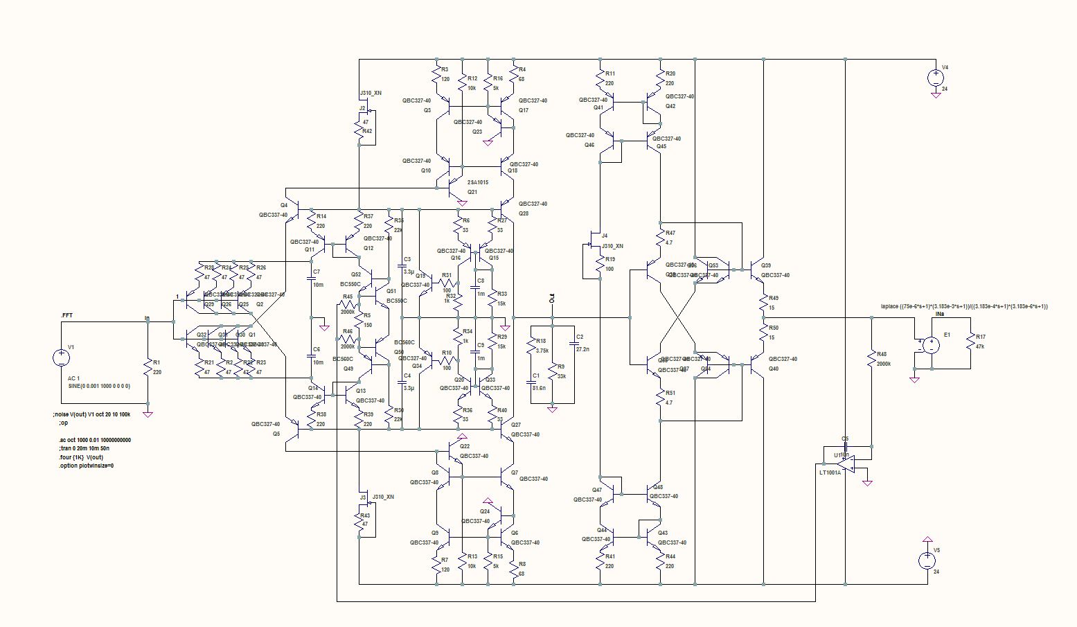

Michael, in a minute i post the BJT buffer that sound best so far. I get absolutely stunning results after the Forsell. I have an idea how to improve the output stage and i hope that the input impedance is high and linear enough to higher frequencies. Otherwise we need Darlingtons or Sziklais at the input.

Here we go....
I have found out that i can substitute P1 with a fixed resistor without reference to ground
when the output has a ballast resistor. I think i took 30kOhm, the input resistor is missing,

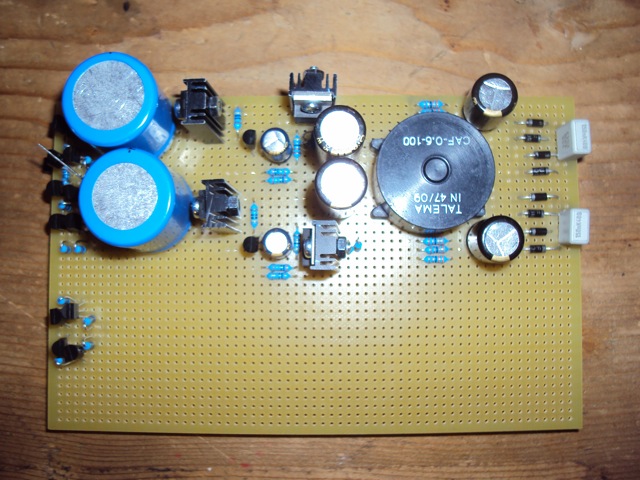

this is where the RIIA comes in. What i would like to try is to supply the collectors of the output transistors from the emitter resistors of the current mirror. I have drawn that up and posted it here but i have not tried it.
Have you already simulated that whole schebang ?
I think Frans is our PSU man and he has drawn up something before.
Please Frans, jump in if you like when your read this.
Somehow I knew the direction you were heading.....
18 uV offset out...and the current from the servo pulls the input cascodes in balance...
think its the right place to place it...

I see mirrors... mirrors everywhere ! 😀 This could freak out some potential builders, but actually signal path is not so complex. I like it. Had a look to my bc337 bag, they are phillips made from who knows what age. I hope they didn't switched to new process. Anyway, it's good general purpose bjt, I use it everywhere, so no need to throw them out if noise is not up to expectation.

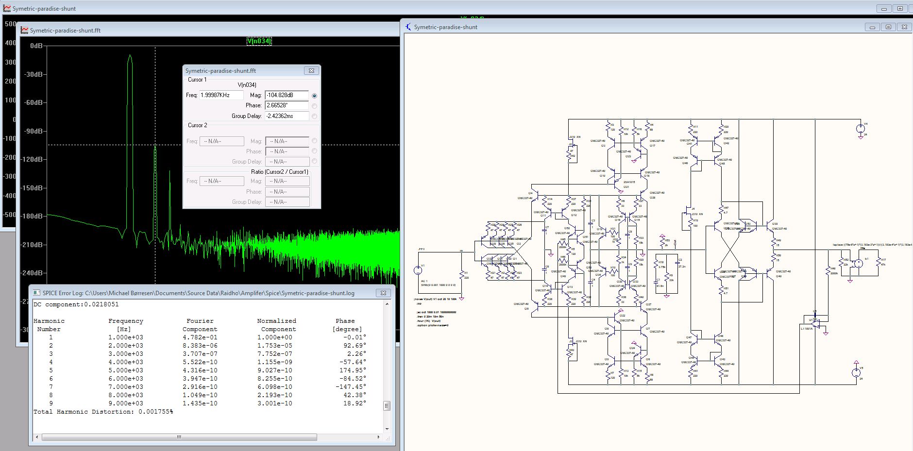

My best BJT amp the Opus Magnum simulates with -100dB distortion at 1V so we are close.
That input stage is much more complicated although the biasing here is out of this world.
