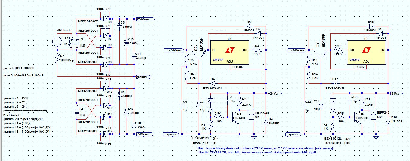

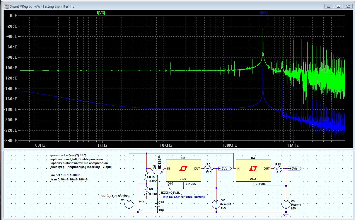

Finding the question (I could read it like that :)) of someone looking into cascaded usage of the LM317 (as Jung) I thought to give it a go. The schema and FFT (as attached) gives the result of my try (research).
The cascade version shows a 75dB improvement over the non-cascoded usage.
For this test I use a 15Vac transformer * sqrt(2) for a nominal voltage of 21Vdc. Added to the supply voltage is an noise signal of 4Vpp sinus. The load is a voltage source with an Rser of 1Ohm.
The voltage across the LM317 (including one Vbe and the current set resistor (12.5Ohm for 100mAmp)) is kept constant by using a zener diode, the circuit functions with a minimum value, for the zener, of 5.6Volt. The sample shows a 6.2Volt zener for some headroom.
Let me know what you think of it, and if improvements should be made, but keep it simple.
Anyway, I hope this input was useful.

That is a huge improvement and it is simple. Good work as far as i can tell. We need of cause a negative version too and the output voltage should be around plus-minus 24V when we take MiiB´s suggestion. The INA217 can take only plus-minus 18V so we need a little local drop for it.

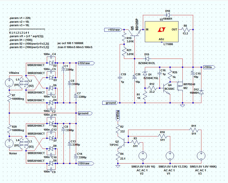

Here it is +/- 24Volt. Currently I am building my SSA IGBT version, and that is going to use a +- 15Volt version of this power supply for the input stage. But it is not build at this moment, so it is a proposal only (to be continued).
As Jung noted, no need for the LM337, the LM317 will do and has a better performance.
P.s. my build will take place during the upcoming seasons holidays. All stuff is sitting here on my desk, and the cabinet is being machined (will be delivered next week).

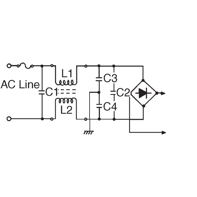

I like it a lot. I assume that the transformer should be plus-minus 18V. I would then add the common mode coils before the bridge like in the little schematic i post. Does your circuit need only a 10uF cap at the output ? That would be really fine. There are small Wima foils with 10uF or does that have too low ESR ?
I will build it and try it out.

The simulator gives (nearly) equal numbers with or without the 10u, so I guess it is not needed at all. Initially I added the 10u to see if adding a capacitive load would destabilize it (it does not). I think I will add a 1u poly in my version (I do have a lot of those).
P.s. I feel honored :)
P.s. Yes the transformer should be 18Volts (the simulated transformer uses sqrt(2) for ac/dc conversion so there is some headroom)
Just did a quick check, the original simulation uses a 24Volt transformer and a sqrt(2) ac/dc conversion (that is what I like to use). Recalculating for a 18Volt transformer and a sqrt(3) ac/dc conversion gives a raw voltage of about 30Volts. The LM317 needs 2Volts, Rset 1.25Volts and the transistor Veb 0.7Volts giving about 4Volts, then add some headroom gives a zener of about 6Volts add another 4Volts for Vce and you need 15Volt + 10Volt is 25Volts of DC from the capacitor bank.
So, yes an 18Volt transformer would do (given sqrt(3) ac/dc conversion) if the transformer and capacitor bank is a bit over dimensioned. Anyway I normally would use and (loaded) ac/dc conversion of sqrt(2), and then you will need a 22/24Volt transformer. I hope that clears thing up :)
P.s. When using an 18Volt transformer then you need to change R5/6/13/14 to around 820Ohm (for 2mA about)
