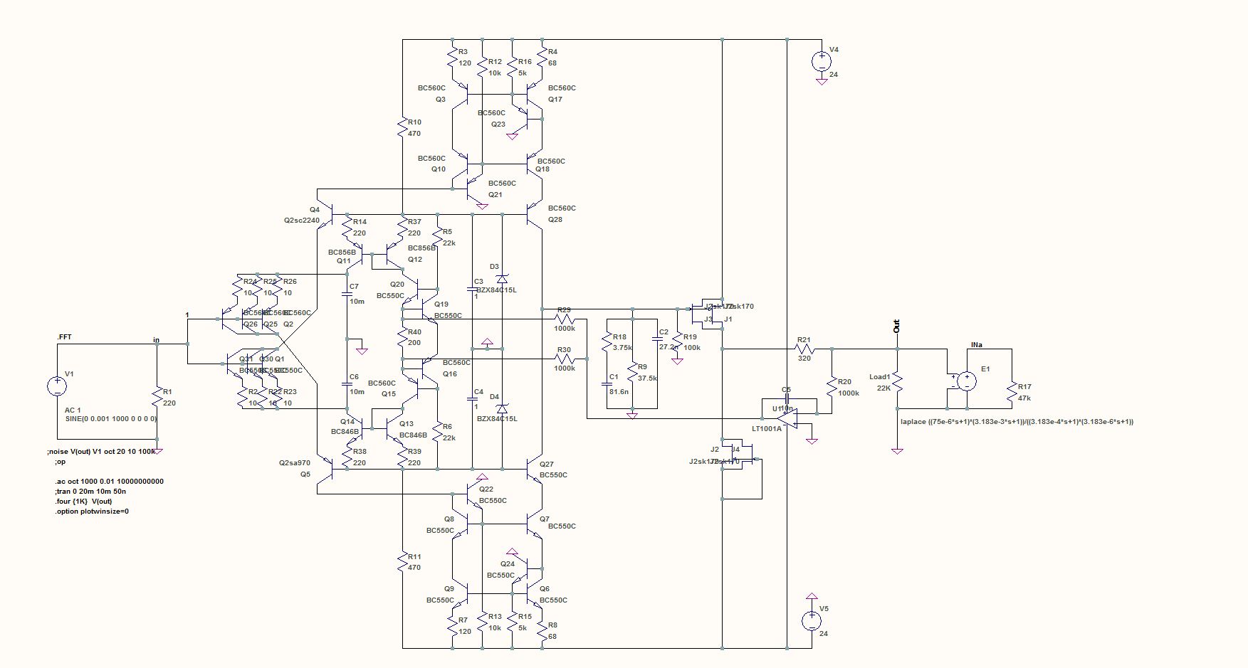

Hi.....took some freedom here....
I changed the current-source to be mirrored inside the cascodes and made it floating so the current s are always the same up an down.. I also used this mirrored current source as the point of entry for the servo, thus really shielding the servo by the impedance of the mirror +500Kohms from the signal-path.
I do believe that a THAT340 could be a very good choice for the input/+ the two basis/emitter drops in the floating current source, this way thermal drifts will be at a minimum. and a second THAT 340 for the additional input transistors. The THAT is ultra low noise at the level of the best fets (Voltage Noise 0.75 nV/ √Hz (PNP)0.8 nV/ √Hz (NPN), and they can be run on low current here 2.5 mA/each, for reduction of thermal/current noise...
http://www.thatcorp.com/datashts/THAT_300-Series_Datasheet.pdf
I have unbalanced the mirror to get more current on the backside for maintaining the Gain
I know I have deviated from the concept of fully balanced, but this was 1. take and can be built into fully balanced as well.

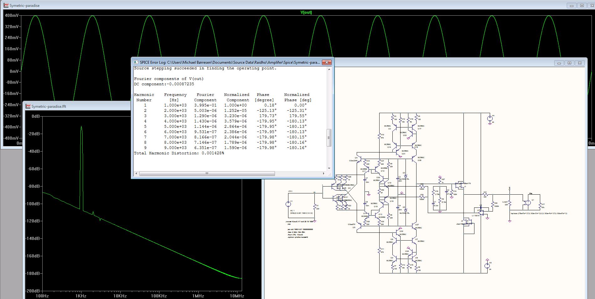

Distortion is very low, and I do think that it looks quite promising...🙂

I have got 5 of those THAT arrays (340P) and the hfe is ~65 for PNP and ~130 for NPN. Very good beta match per pair I have seen, but keep in mind the low numbers for increased Ib issues in arrangements that matters.
MiiB, cool circuit. The distortion profile is amazing. Have you made noise calculations with the BCs ? Lets take that as the unbalanced version. I would prefer a BJT buffer though. Just because there should not be any Fets in there. I have an idea for a diamond buffer with high input impedance. I worry a bit about the quite low and dissimilar Hfe of the Thats chip but honestly i have not tried them so you are the expert there.
How would a balanced version look ?
No here its simulated with the 550/560C transitors, so the gain is high...60 dB...i have not calsulated the possible voltage swing in the base region, may run out of current headroom there...app 20 mA through the backside of the mirror..
quite sure the zeners could be substituted with something better, maybe even an internal shunt supply
Here is where the BJts beat the Fets. They have around 10x more transconductance against Fets at the same bias current. We end up with less distortion. Also they like to be degeneted to aprox. 2/3 gain when they show less distortion. A degenerated Fet will have a complex spectrum though. What do you think about a Tl431 instead of the zener. That would be cheep and simple.
I think it's vital to get the noise down...impedance is not so important as the main focus is to maintain an absolute steady DC at +-15 V,
so we need do increase degeneration and maybe increase the current at the backside, i think that noise will be low, especially if we select some low noise transistors (where is my stash of R-ohm) or could also be the 2240/970 pair, but then we migrate into more costly BOM
I really like this exploration of One-shot no feedback current riaa's..There's now quite a collection, from yours sen/cen inspired over this to my funny-folded.. guess you may be the one with the best overview to the sonic qualities... 🙂 Not only can tha distortion be low, but the way disotrtion envolves over tha frequencies is also unigue....Can't see that there's any stronger concept...

MiiB, do you have an idea for a better voltage stabilizer then a Zener ?
No not really a significant better, could be a string of red leds will be better..., but with the current source and and the fixed rail only attached to the cascodes...I'am not sure how significant it is to get really lower in noise..than the 15V zener+caps
