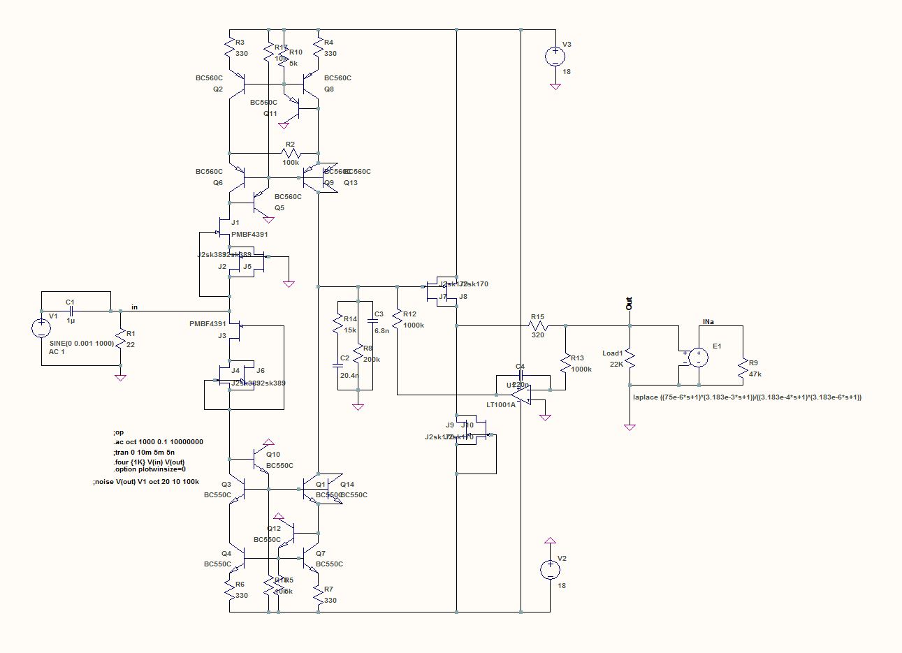

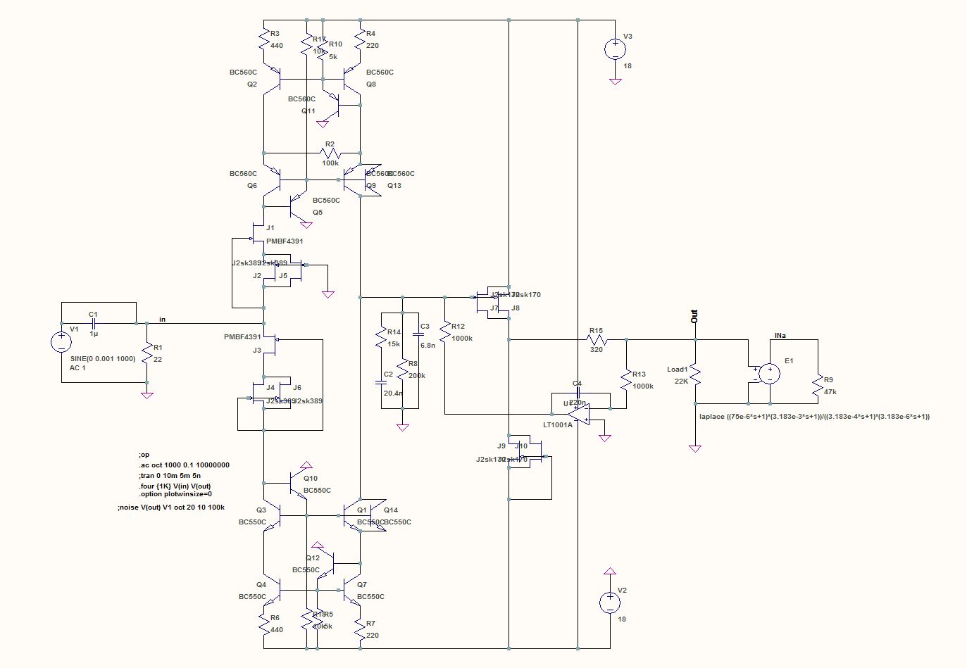

with the PM-BF 4391 the gain drops app 3 dB...could be possible to increase gain by running uneven resistors in the two strings...eg by lowering the backside to 220 ohm the gain increases by 3-4 dB...
If this different current approach is used for more current and gain it could be useful to change mirror transistors to some types like the KSA3503/KSC1381 as the bottom pair sees some 200 mW dissipation
I tried that transistors in a much more complicated Gilbert 2I mirror and they did not work. I never found out why. They have much lower Hfe then BC550C, 560C so at first glance i would assume less output resistance from the mirror. About what backside are you talking about ? I am quite surprised how much attention this little circuit draws. When we put our knowledge together this can turn into something nice and simple i think.
the backside where the current is tapped for the RIAA...if you unbalance the mirror with lower resistors there you increase current and thus the gain... if we increase there we also increase dissipation.. so a pair of TO126 with high HFe may be the right medicine...
Honestly i do not know better then KSA3503/KSC1381 or the Sanyo equivalent. With luck we get Hfe of 200. Interesting idea to unbalance the mirror. That did not come to my mind before.

Here the circuit you suggested or is there a mistake ?
http://www.diodes.com/datasheets/ZXT690BK.pdf
No it's not up and down unbalanced, but left reight so the current is kept low through the input and then the current is upped to the RIAA node. This increases gain.

I have another trick to raise the power that can be burned in the mirror.
Just double the BC550C/ BC50C in the high current position. It works like a treat. I do like that in the Opus Magnum that also burns a lot of current in the mirror. The compound transistor created has now ( Hfe1 + Hfe2) / 2 and double the power capacity.
Thanks Michael. Now i understand. Very clever.
The dissipation is not so much that outer as the inner pair....by doubling the transistor the dissipation is only 100 mW on the lover transistors...could be we need some degeneration for current sharing

MiiB: Nice find with that unbalanced mirrors 😉
Thanks for all contributing here. Michael and Jacco, the BJT doubling works without problem. I match Hfe anyway so there is no need for degeneration unless you want to use non selected BJTs but then you have the job to adjust so it does not safe time to do it that way. Sampler, i know, the higher the output impedance, the harder to adjust DC.

Look at schematic post 3032 for example. They are Q11, Q5, Q10, Q12. They supply the base current for the mirror transistors. This base current always flows in BJT transistors and is responsible for a lot of effects. In this case ( without the helpers ) it limits the output impedance at the collectors of the mirror. You could look at a transimpedance RIAA as a frequency dependent voltage divider. Consequently you loose gain when the output impedance of the mirror goes down provided the values of the RIAA components are hold constant.
Sampler was in post 3035 able to raise the gain to useful values by using the helpers.
He was complaining about too little gain with my original schematic and by suggesting the helpers to him the problem was solved.
