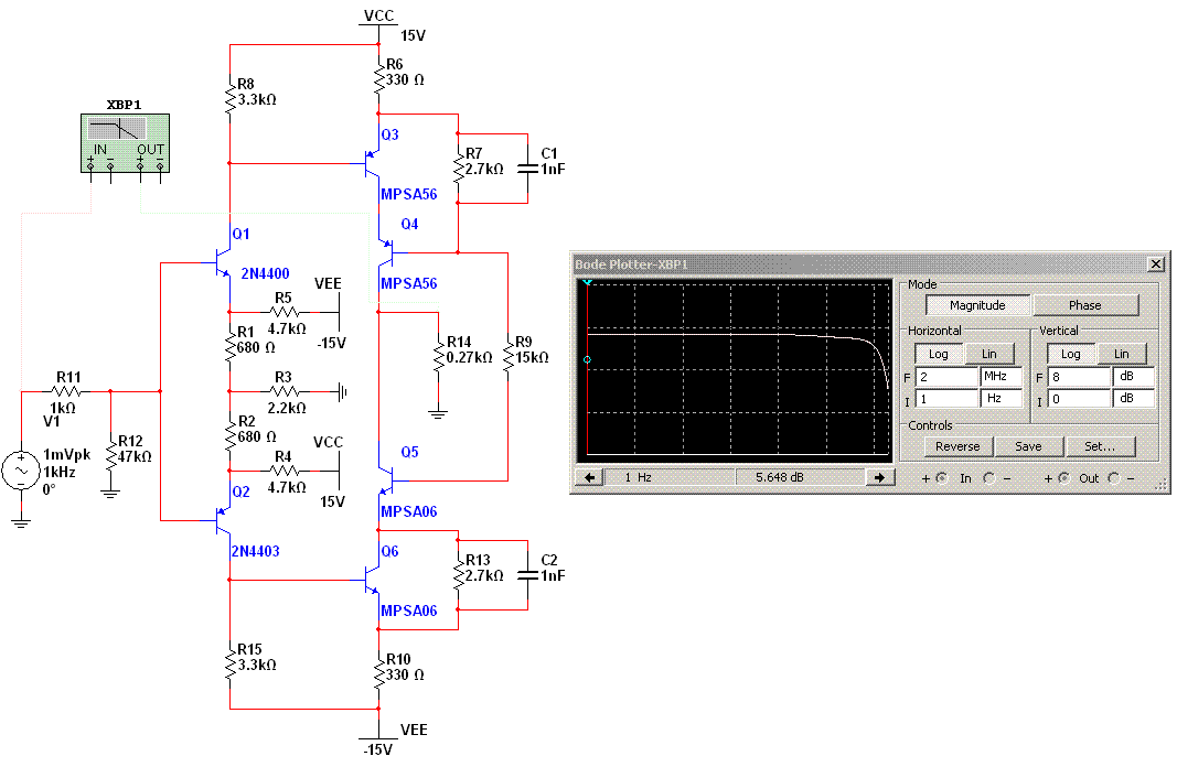

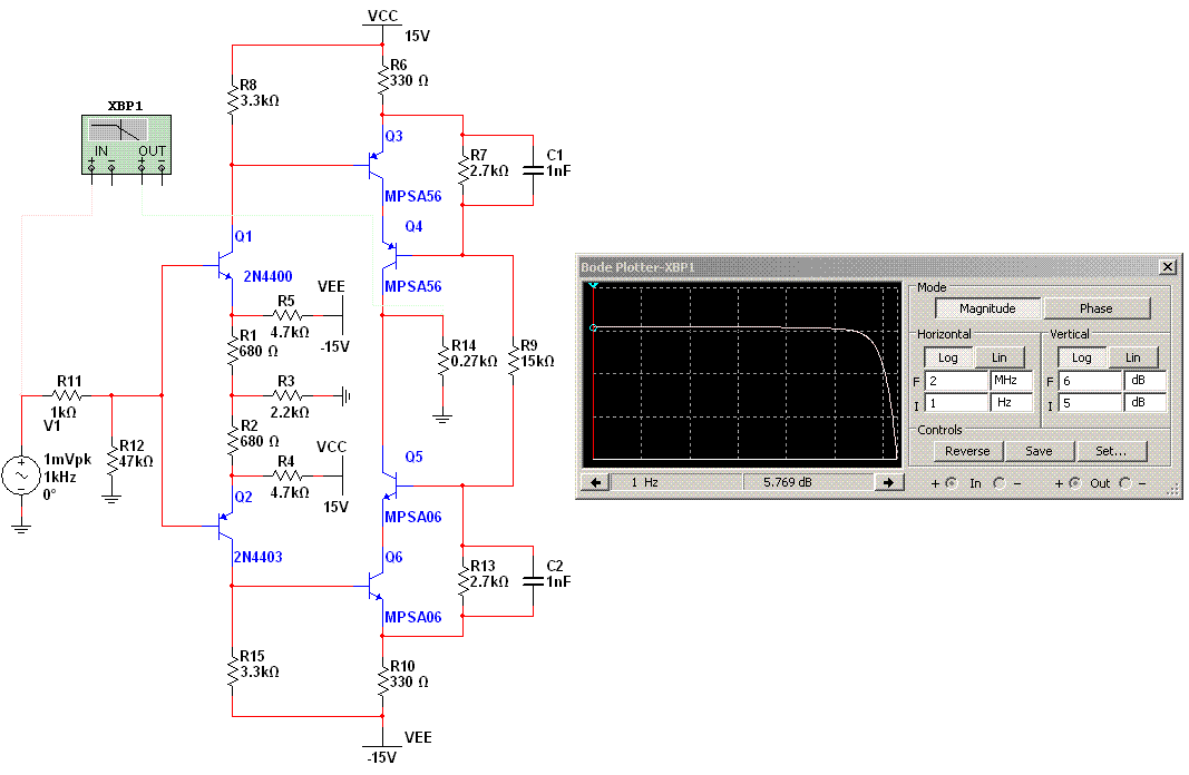

Now that we are starting to understand transimpedance concepts as use in phono stages we can also look at its use in linear amps. As i published before i am building the Buffalo Bill linestage for LÁrt du Son. It is set up in the following way : Transimpedance voltage gain, volume and balance control, buffer. That way i get the least amount of noise because there is no voltage gain after the volume control. In a conventional arrangement that gain after the volume control also amplifies the noise. The buffer is set up as a modified diamond buffer. For the basic circuit see my contribution on the Cascode Diamond Buffer thread. How i designed the voltage amp will be shown here in some detail.
It all started with a topology designed by Prof.Hawksford and Dr.Mills, people i worked intensively with in the 90th at the University of Essex. It is rather basic and can be improved but even this simple circuit is not bad at all in performance. Set up in this way the -3dB point is at 4.7MHz and the gain is ca.6dB. It is stable with little overshot and can reproduce a 100kHz square wave without much deformation. It can swing 5.72V in class A.

I have now put the circuit as is through the paces and have included it in my signal chain.
It worked right away with the exception that i put a PNP Transistor in one position of the left channel where an NPN should be. I am a bit handicapped with my eyes at the moment because i broke one glass of my spectacles and i am wearing 20 year old glasses now that show me only half what i can see usually. If i would criticize what i hear the circuit errs on the slightly warm side compared to the Buffalo Bill buffer alone. This in the best british tradition. Everything is there but slightly " under the hood ". I think this is an attractive detour from the ice cold and analytical sound i hear often from expensive IC stuffed commercial preamps. I drive this circuit from an unregulated supply that uses simple RC filtering so a better PSU can improve the sound much i think. Even with this primitive PSU the circuit is dead quiet. A good sign. On the other hand the circuit can be improved. First i will add constant current sources to the input pair. That gives better PSU rejection and allows me to trim DC offset at the output. At the moment offset is a bit under 1V negative in both channels without any matching or adjustment. I have an input cap on my power amp so it works in my system but may cause trouble in a fully DC coupled system. Watch this space.
Do you mean the Buffalo Bill is a buffer... no gain... What is the gain of the power amp that you are using ?
I wonder how CCS might modify your positive first impressions related with this last build.
IMO a good psu with the simplest amp is much better than a complex amp with very good PSRR, powered by an average PSU.

As i said, the Buffalo Bill is a buffer but that has an elaboration of the circuit here as voltage gain before the volume control when needed.

Here is how i developed the circuit further. It has now the CCS`s and the Hawksford cascode is clamped with Leds for more stability. Also shown is a Fet version that represents a considerable simplification if you have P-Channels. C1, C2 values come right out of my head. They have to be adjusted for best time ( squarewave ) response.
What can be improved over this ? Cacoding the input too comes to mind but on the other hand the gain of the input stage is very low so not much can be won at the cost of complication. I think i like it as is.
I particularly like the fet version.

I like the Fet version too.
Other Fets could be used with small modification to the resistor values.
The fet version is super clean.... might sound powerfull and spacious with a good PSU.
I believe it is DC coupled right ?

Yes, try it and give me your impression. It can be setup with conventional global feedback too. It should work with any low level transistors. I used 2SA1015 and 2SC1815. 4 cent a piece at Reichelt.
