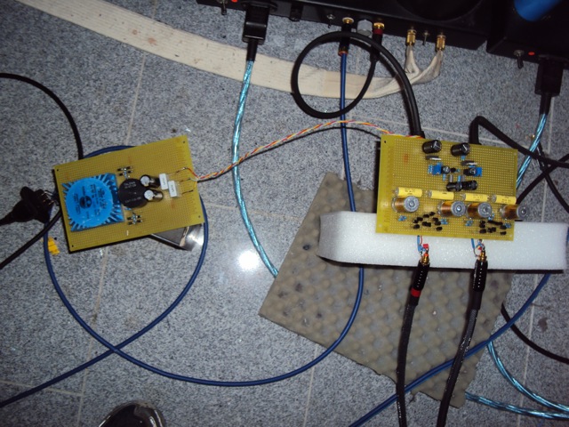

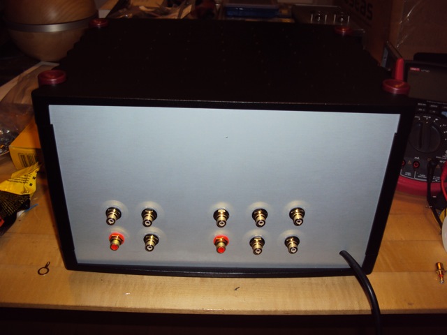

The Buffalo Bill Linestage prototype works. Now i am building the cabinet.

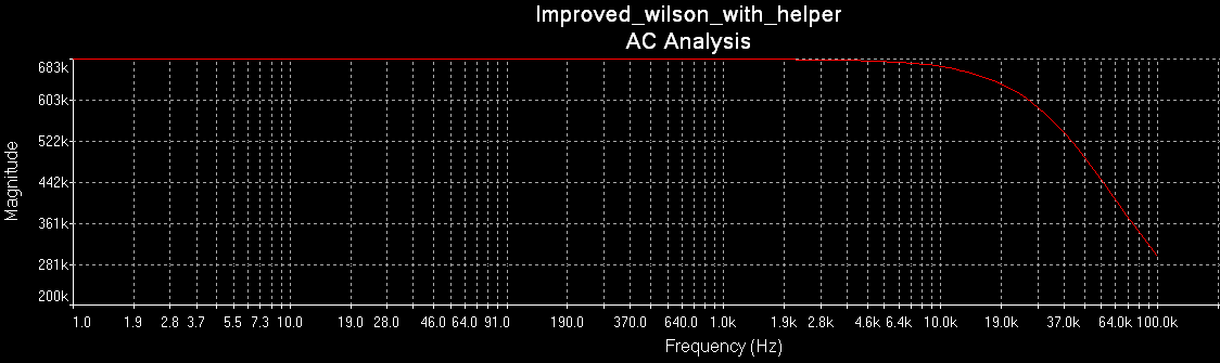

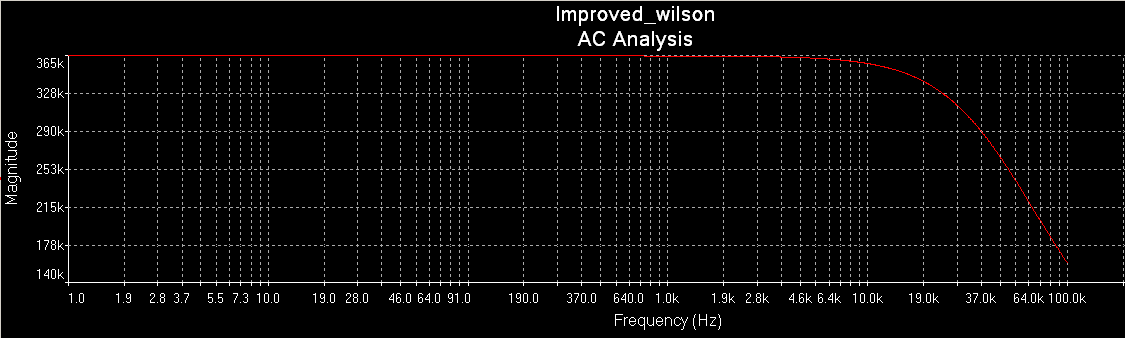

Yes Joachim, you were right, it works just fine. Here is output impedance plots of current mirrors with -+18V supply and 374 Ohm emitter resistors. I think it's really worth using helper transistors, as with higher output impedance you get better frequency response, for the same theoretical riaa values. So adding 500k to the ground already gives you almost straight impedance line to the 25k Hz and perfect riaa compliance.
