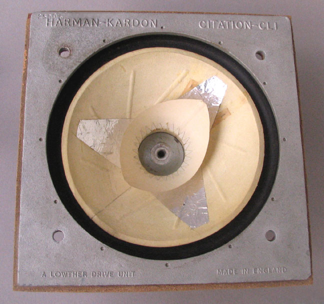

regarding resonant problems and in particular modes of the cone - what do You think of solutions like "differential wave impedance" cones or oblique cones - dispersing the resonance instead of taming it?
Have You ever tried anything like that? Would You try it now as You are now working with full/wide rangers?
below are: Lowther driver modified by Stewart Hegeman, conventional vs oblique aluminium cone response from JVC's brochure and Baker Reproducers 12 inches woofer (photo from Gramophone, March 1966, p. 110) - at Baker they coined the term "Differential Wave Impedance": "The patented cone construction has a central metallic ellipse and is said to give crisp response to transients with absence of coloration", "it has a special double ellipse of metal at the cone centre to eliminate cone break up."

Yes, that has all being done and more by me and others. We had luck to find a cone that is well behaved until 12kHz. Scanned with a vibrometer we could of cause find bending modes in that driver but coincident frequency is high enough to not cause distortion. Elastic flexing is simply too small in amplitude in that design to cause hystheresis. A driver that is linear to say 20kHz and has a very good off axis response has still to be invented. A friend of mine works on an electrostat that can do that and has up to 110dB clean soundpreasure but again this ain´t no cheep.
