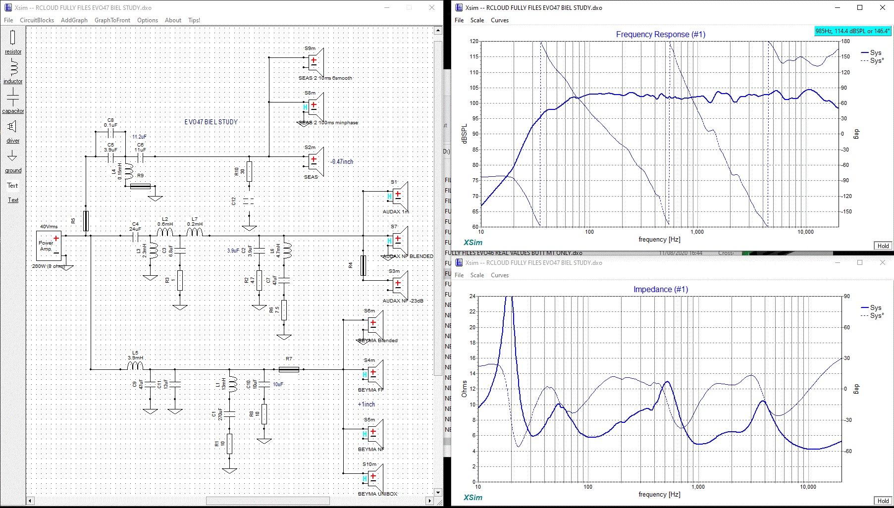

I am working on this speakers for the nearfield Situation.

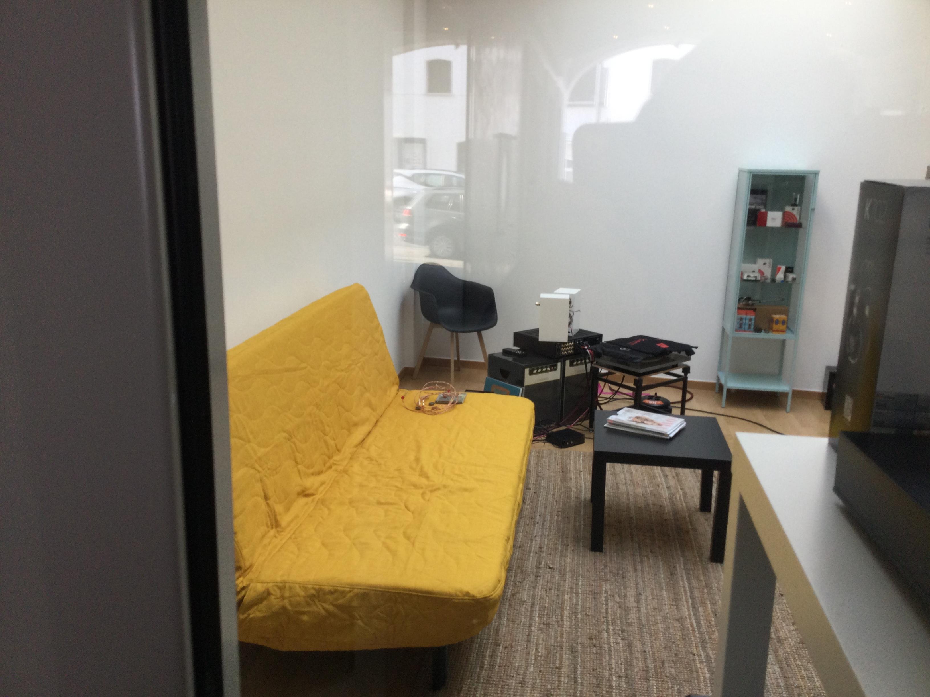

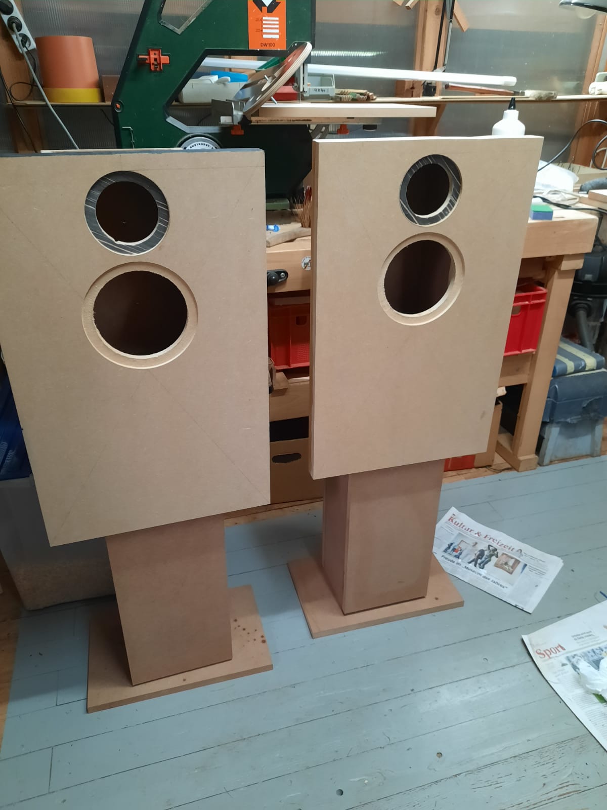

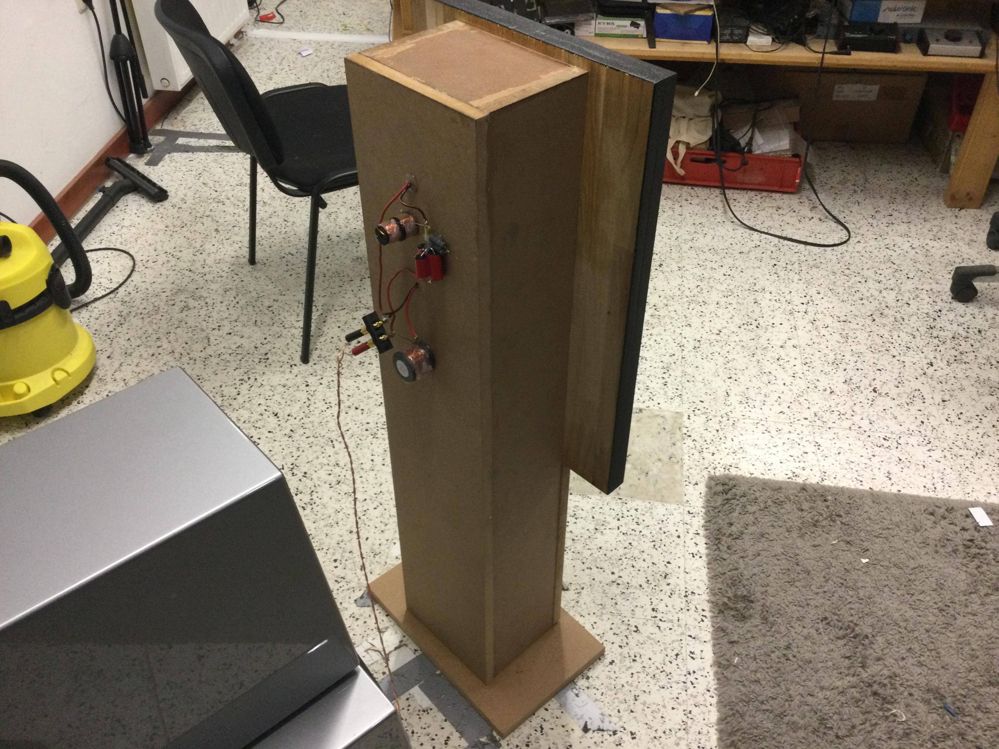

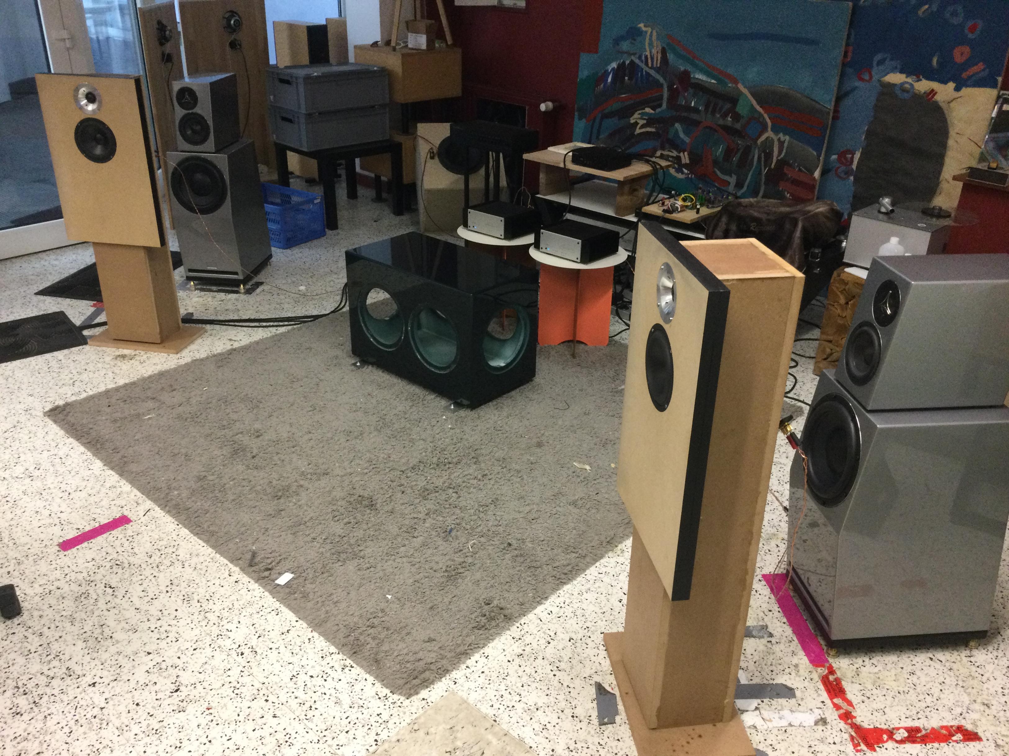

I finished now the speakers for the corner situation. I chose a closed box because sitting in the corner gives a tremendous bass boost.
So far I heard them only in a conventional setup and like what I heard. In my new studio I have a nice corner Situation so I plan to give them a listen there over the weekend.
