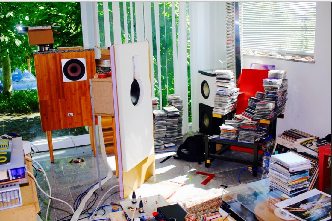

Here is a fairly recent picture of my listening room.
I play around much with different materials, for the baffle and also for isolation.
Neat idea... Using stacks of CD cases as diffusers.
