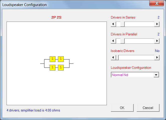

I am modifying a big speaker that uses four big woofers each 4ohm nominal impedance.
I need resulting impedance to be 4ohm..... what would be the best wiring:

2 in parallel for 2 Ohm each group of two. Then each group in series for 4 Ohm.
2 Ohm plus 2 Ohm = 4 Ohm

I am modifying a big speaker that uses four big woofers each 4ohm nominal impedance. I need resulting impedance to be 4ohm..... what would be the best wiring
Just to clarify, there is actually no difference electrically between your two options - you could use either one, and obtain the same results, assuming the four drivers are identical. The second option is in effect just the first option, but with the mid points of each A block connected together. Because the system is balanced the voltages at the mid points of each A block are the same, and no current would flow from one block to the other anyway. I prefer the configuration I posted simply because it has the most straight-forward wiring.

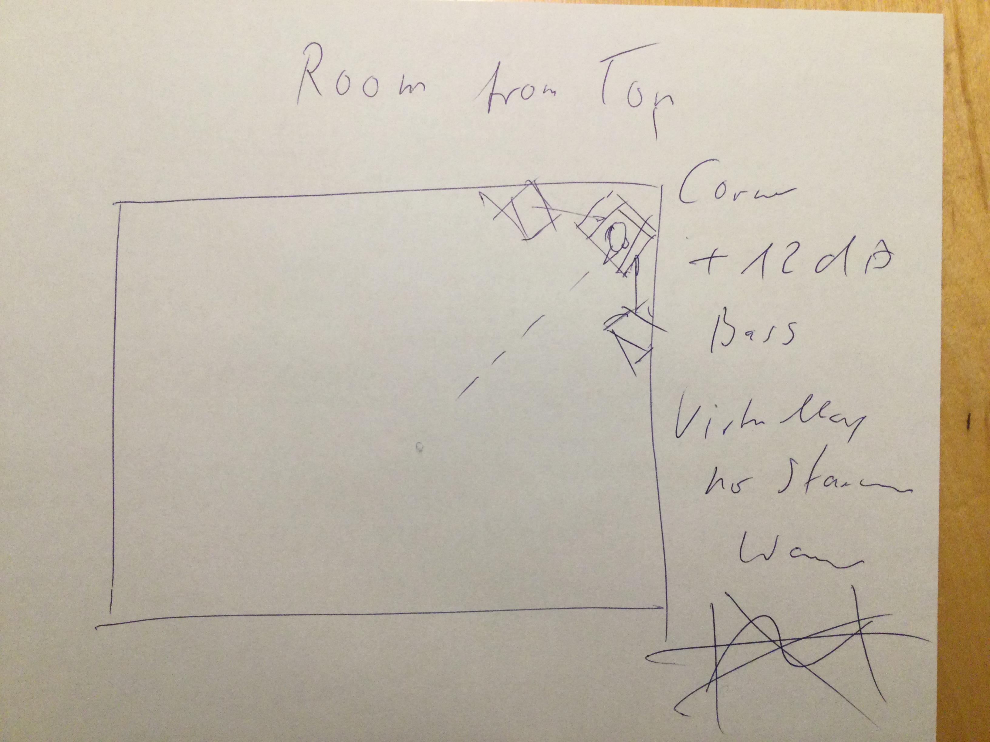

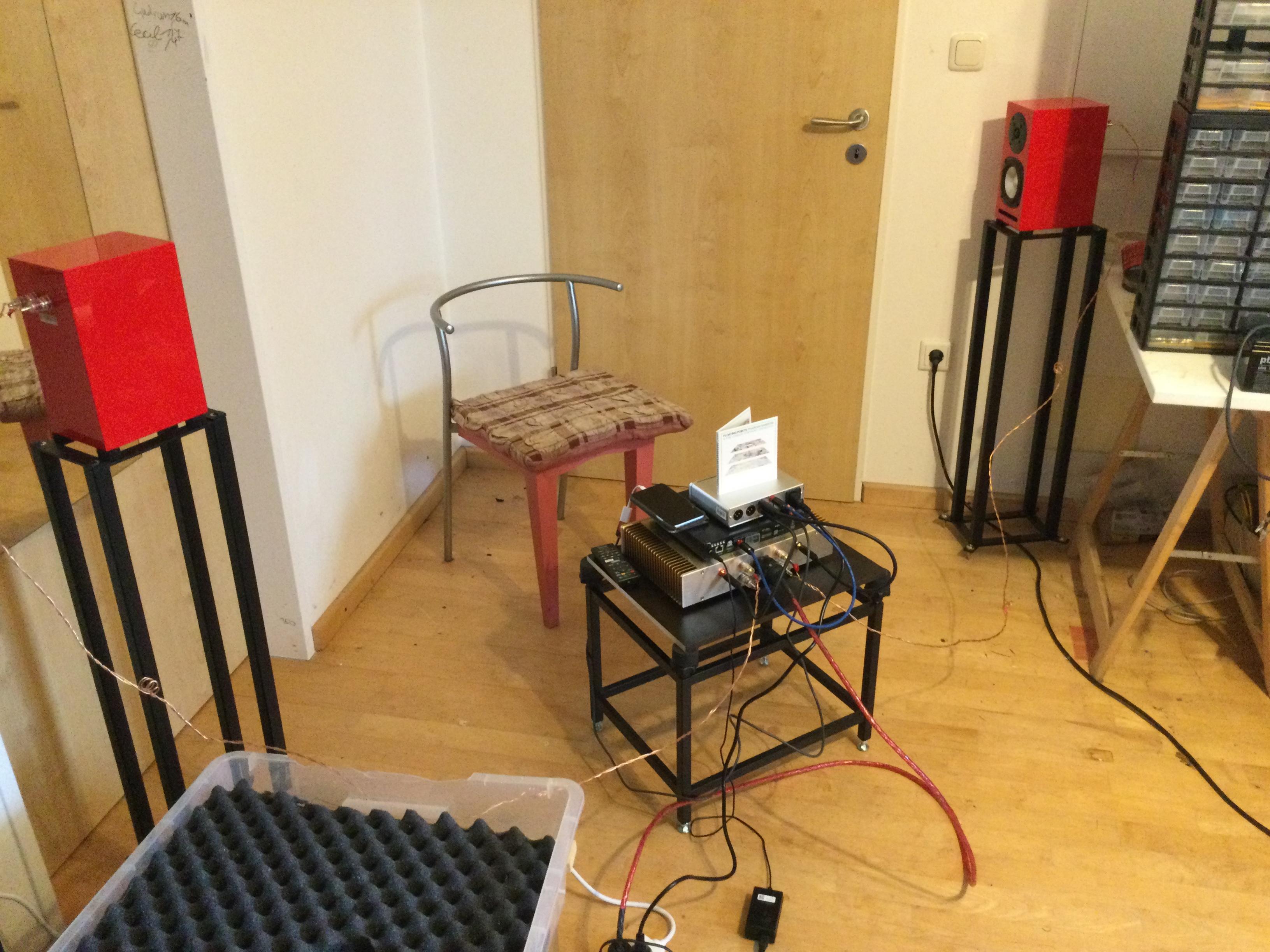

I see what you mean now.
A picture is worth a thousand words.
I have your papers related with speaker placement but did not find anything related to this method.
I will try it asap.
I will try it asap.
It is a new idea. I am working on an addendum to my setup paper where I also try to cover vertical imaging and Blauert Bands.
