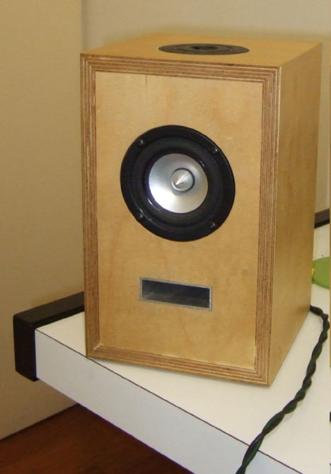

of course You are right in case of conventional front firing speakers BUT my idea is something different, something aptly called "ceiling flooder" and which is a kind of Sonab V1 turned to serious speaker project 🙂
essentially a short speaker with 8 inches full ranger on top firing up towards the ceiling, for such speaker I propose Beverigde or near-corner placement
my idea behind this project is of high fidelity that is available for any interested music lover, that is just like any other "room service", genuine a Hartley's ideal, not jewel-like boutique gadgetry, not big ugly technical things almost in the middle of the room, but something that is quite inobtrusive, that would work properly in a typical living room, that takes minimal space close to walls and requires no decor-destroying "acoustical adaptations"
in case of such "ceiling flooders" high directivity or even frequency dependent "discontinuities in angular dispersion" are not of critical importance because:
1) the diffuse sound field they create in a typical room is dominated by reflections from the "flooded" ceiling which is the largest reflective surface in the room (thus contributing mostly to the created sound field) and
2) those reflections are quite uniform spectrally because the speakers typically are "flashing" at the ceiling from considerable distance of 2.5 m or more (speaker drivers are just 20 cm above the floor) so not at particularly acute angles where one can find those "frequency dependent discontinuities"
what I need is good 8 inches full ranger, without shouts and able to produce real bass in a small "acoustic suspension" with help of "boundary room augmentation", I see it as continuation of Villchur-Allison line of thinking
Problem is that I cannot see any such driver on the market and therefore I am so interested in this thread 🙂

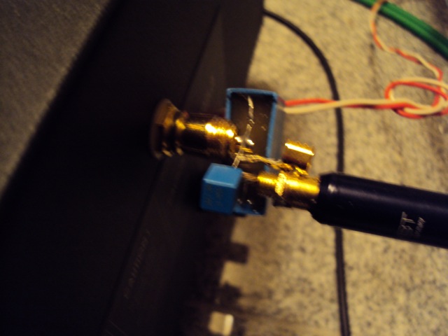

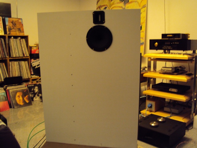

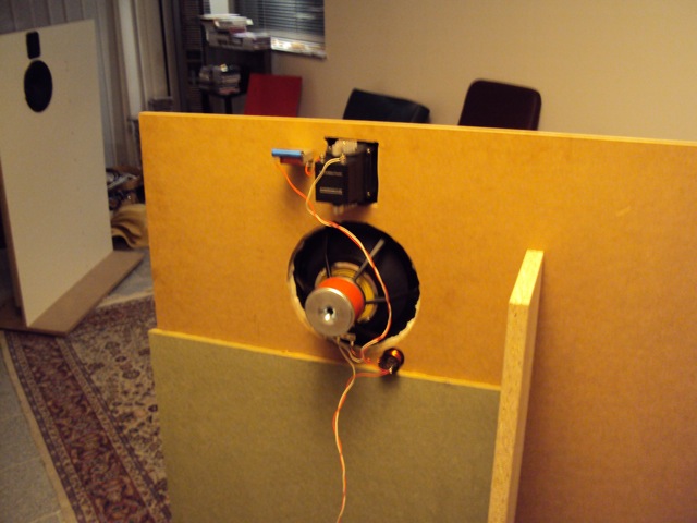

Some days ago i got the fitting tweeters for my "Extended Midrange Drivers" as i will call them. They can be made to go to 12kHz but higher then that you need a wizzer cone and the designer whanted to avoid that. Wizzers cause a lot of trouble in the frequency and time domain so i decided on an "Overtone" tweeter that comes in slowly over 7kHz.
The tweeter i choose is a ribbon with horn made by Fountek. In Germany they are sold under the Audaphon and Dynavox brand with wildly varying price and image.
i do not care about that and the tweeter is actually very good and has the ideal radiation pattern and sensitivity. I made a simple and fast 6dB crossover that worked surprising well also in the time domain. I will show measurements later when the tread develops because i found that publishing preliminary data here causes a lot of confusion. People take that simply much to serious and the driver is still under development although the path where to go is cast.

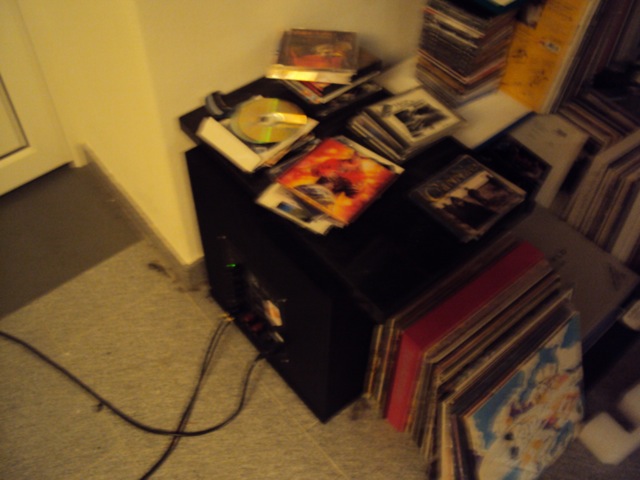

My setup now is the JG Self Preamp with two cables, one goes to the active subwoofer and one goes to my main amp where i filter the MPL with a cap in series with the input impedance of the amp. It´s a kind of semi active setup that i use ones in a while since the early 80th. Actually i find it more transparent souding then most fully active solutions i tried. Lots of extra electronics and cables must not automatically guarantee better sound.
Bargainers will love the 0.6mm twisted solid core cables. Yes, i think for a dipole with 95 - 96dB sensitivity and 8 Ohm it is adequate when it is not too long.
Nicer cabinets will be build and i also build two different dipole woofers that will complement the MPL better then the closed monopole so this setup is really an early bird. Sounds very nice though. Lots of resolution and dynamics that are simply swallowed in spaekers with more damping.
