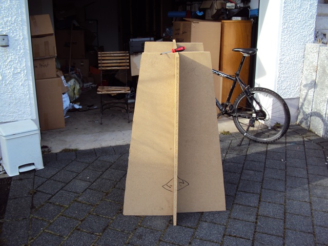

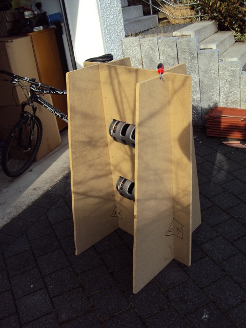

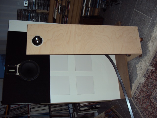

I build a fitting dipole subwoofer for the MPL. It has 2 LAT modules, horizontally arranged to avoid assymetric gravitation load.
I call it an X - Baffle and it looks a bit like a truncated pyramide.
Textile cloth could be put over it and a lamp inside.
It will be actively steered with two amps. one each for one LAT.
The LAT is well suited for this aproach but sadly seems to be discontinued.
I found only some white papers on the Tymphany site and no other information.
That is a pitty because the push-pull operation makes them low in second harmonic distortion and as far as i remember the Q was quite high, also good for dipole operation.
I had successfully made an H - Dipole with one Lat some time ago so i know it will work well. Sound was fast and clean amd this X - Baffle design should do even better.

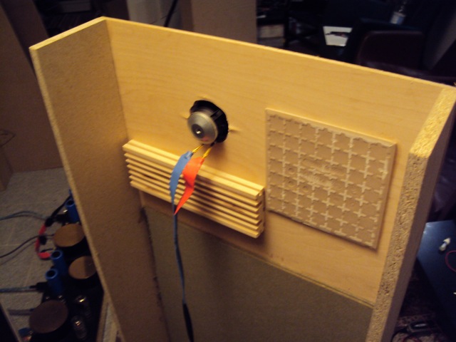

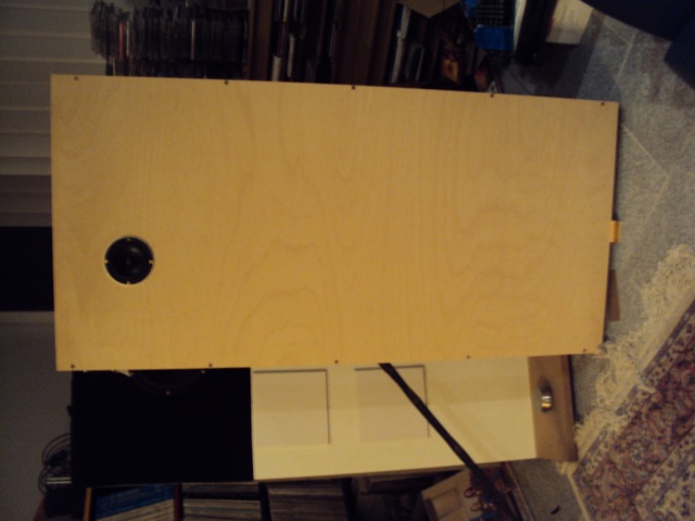

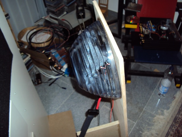

Today we had exeptionally nice weather after two weeks of cold and rain so i could build something outside. My son likes my MPL very much so i build him a pair of MPL light. I took the ScanSpeak 10F/4424G00 in 4 Ohm and build it in an open baffle of 60cm x 125cm. It has 15cm wings on each side so in total it amounts to 90cm. I had experimented with 90° wings that where much longer but the sound gets very hollow, so this is a compromise between size and sound. When i measured the completed speaker is was pleasantly surprised. No crossover is necessary this time exept the line level cap i use that roles off my tube amps under 100Hz. The result is a classical difuse field response with some lift over 10kHz. 15% off axis the response is very flat so i setup the MLP Light in the nearfield, speakers crossed around 30cms before my ears. I used my X-Baffle dipole bass and set the crossover around 150Hz. The sound is exeptional considering the very small driver and playes loud too. The midrange and soundstage is something to behold. Treble resolution is fine too. I had build a similar system with the Jordan 13cm driver in a wide and narrow transmission line some years ago but as good as the sound was, the treble was a bit metallic and not very detailed.
Not so this time. It does not have the estreme micro detail of the horn ribbon in the big MPL but this is the best treble i heard from a wideband except the amasing Manger Wandler. The advantage this system has even over the MPL is a totally seamless sound. The step response showed a time coherent result so this works a a bending wave transducer. The higher the frequency goes, the smaller is the aerea that radiates so off axis extention is very good. Here are some pictures and then come some measurements.

Second and third harmonic distortion, psycho acoustic weighted frequency response, group delay measured indoors.
Sensitivity is good at 92dB but this is a 4 Ohm design. The pair of dipoles though sound louder then a closed box or reflex design.

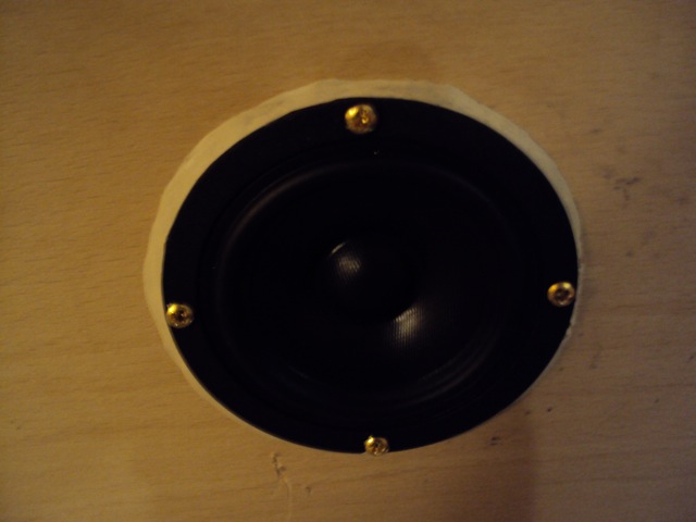

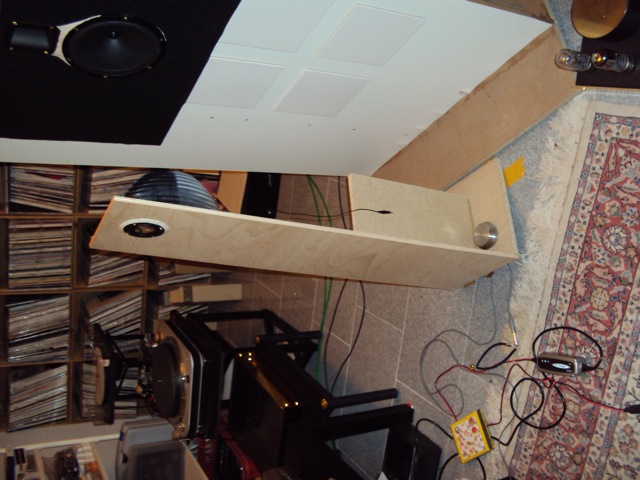

Recently i got a visit from a friend. Actually she is a she and plays the Flugelhorn and also conducts a little orchestra. As small and affordable the Mini MPL is, for her it was even too big and expensive. So i made a sugestion to build an even smaller MPL. I call it the Baby MPL. It is a 28cm x 105cm baffle and this time the driver is in a glass pot, so this is a closed box system in a baffle. I used the Fountek, Dynavox FR88EX this time.
This system can be build for less then 60,-€ a pair. I am still using my X.Baffle woofer but it is now time to construct something smaller. The FR88EX does not play as loud and clean as the Scan Speak but for my friend it is more then loud enough. I am often surprised at how soft levels "normal" people listen. This time i present the measurements first and will post some photos tomorrow. The treble of this unit is a little ragged but i found that under 15° it´s ok, I also did a nearfield measurement where you can see the behaviour of the membrane. Up to quite high frequencies this driver works as a piston, then you see the usual edge resonance that is well controlled this time and then the driver breaks up in bending waves. Again, sound is surprisingly 3 dimesional and open, in a way more natural then many expensive a speaker provided the volume is moderate. Again i use no crossover, only a 10nF cap in front of my driving amp with 330kOhm input impedance.
