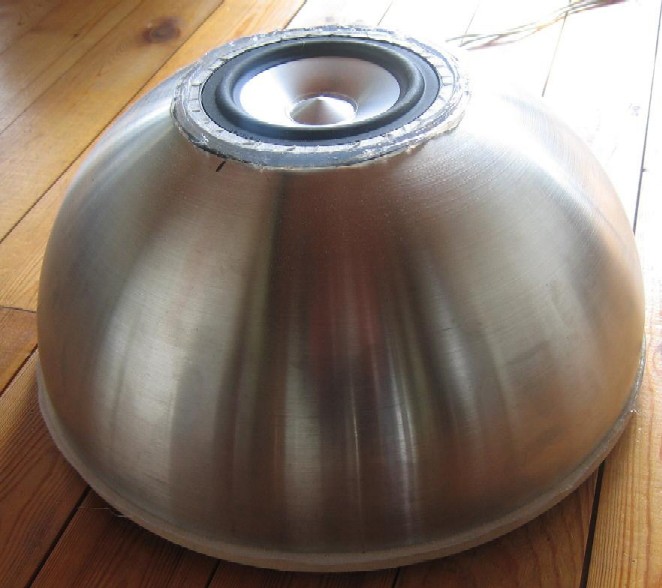

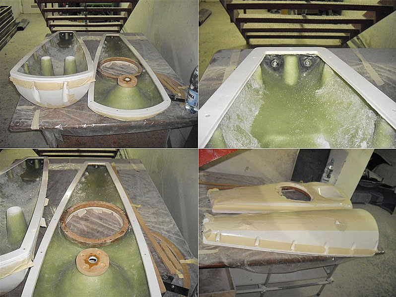

Here is my cabinet prototype that could be modified in future to controlled pattern bipolar speaker.

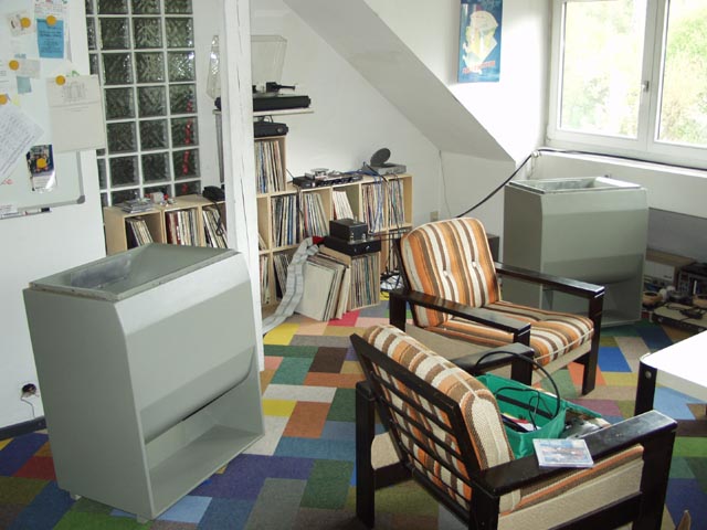

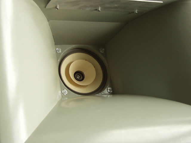

I've found that website too and there is written that:
"Audiovector was designed by British sloping ceilings, with the expectation that the sound of the horn, the striker up, will affect the listener. Just a Guido, the system is on the attic floor with the ceiling. But now it is perpendicular to the slope. According to Oleg, earlier, when the system was placed parallel to the slope of the ceiling, it sounded better.

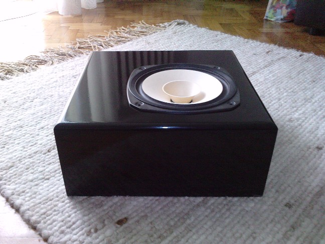

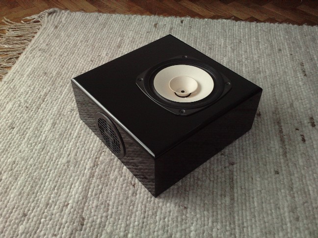

my main system is now disassembled after moving into a new apartment and the original flooders with cyanoacrylate modified FE206E had been destroyed even earlier by a small kitten, you can imagine what he did with them 😉
now I listen to music mainly casually with flooded KEF UniQ bookshelf speaker
the flooder is now out of use because of 2-year boy in the house, as it is known that such a boy is even more destructive being than small kitten 😉
the UniQ is relatively safe as it has grille and looks sufficiently uninteresting 😉
so I had just put new, yet untreated FE206E into flooder cabinet to take the photos below

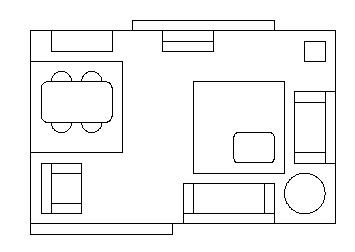

now I listen to just one UniQ in mono, it is positioned near the wall (the three distances to boundaries according to golden section)
below is also schematic of my living room
the slim rectangle up means windows and similar one down means open passage to another room
on the right: two sofas and a coffee table, the circle in the corner means big plant
on the left: a table with chairs, and a cupboard
up in the center a chest of drawers with TV on it
the flooded KEF (with bass reflex port blocked) is near right corner up and my armchair is near left corner down
there are two carpets - one below the coffee table and the other one below the table
the room is circa 570x360 cm, 300 cm height
the sound is totally detached from the speaker, the sound scene is 3D, it takes up a kind of spherical form (the size of it depends on SPL) and in it the specific sound sources are separated from each other, there is strong sensation of virtual space, sound sources are surrounded by ambient, there is depth and planes within it
perceived acoustics depends on the recording - jazz club recording sounds like jazz club and church recording like church and so on
what is lacking is horizontal stereophonic left-right spread of the soundstage, there is a spread - vertical and also horizontal - but unlike stereophonic

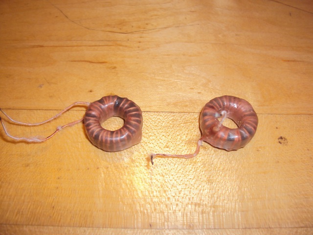

HF coils
Today i made some coils for the Ribbon Horntweeters in my big MPL baffle. So far i am using wax dipped air cores and everything is fine. This time i try coils that are made like HF coils. I used a ferite ring and silk isolated litz wire. I wound by hand and ca.30 windings proved to be enough for the value i need. The cable is not very thick but because it is only less then half a meter long the DC Ohmic value ended up under 0.1 Ohm. I dipped the coils 3 times in wax to stabilise them mechanically. I do not know if the ferrite ring is any good for Audio. I had it lying around for another purpose. I had tryed toroids for bass work in speakers successfully but i never tryed a construction like that in the treble. Tomorrow when i build it in i know more.
