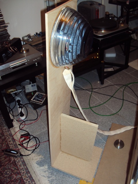

Some Photos
the idea of glass bowl enclosure is really nice! 🙂

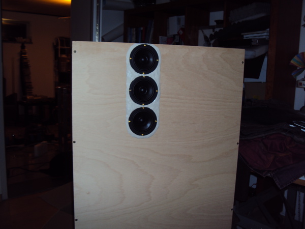

Today i rebuild the Mini MPL. I was very happy with the sound but had an idea hpw i can increase power handling and bass extention. I am using now 3 drivers in a vertical row.
One widerange in inbetween two drivers that are smoothly blended over in the bass. I call that BWB for bass, wideband, bass. I works very well. I have now 3 times as much aerea in the bass and extention in my small baffle is -3dB at 100 Hz. Sensitivity is 87dB, impedance is 4 Ohm. I show some measurements and a picture. This is a phase coherent speaker and step response and squarewave reproduction is exeptional.

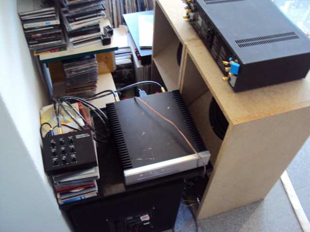

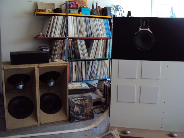

I have build an alternative woofer system to my big MPL system. The LAT woofers in my X - Dipole are not made any more so an alternative is needed. I use 2 M - Dipols now with 4 x 30cm Peerless SLS woofers. I use equalisation to extend the response to 20Hz.

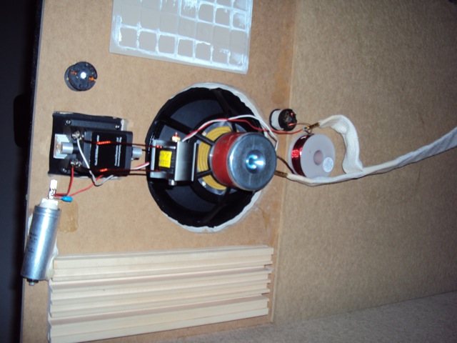

I made some parts upgrades to the MPL. As tweeter cap i use now a combination of 3 different caps of different sizes in parallel. I arived at the values and types after month of listening.No computer simulation for the MPL, just intuition and experience. Of cause i measure in the end but i am surprised how well i can pull the old tricks before we had computer based measurements. Usually my estimates corelate very well with my measurements. This reduces compression in the treble much and the sound is silky smooth with still a lot of energy. I upgraded the little ferite powder coil in front of the wideband driver that had worked admirably to a big air coil with baked litz wire. I think it sounds more detailed without artificial edge. The biggest improvement is the new coil parallel to the tweeter. I had used a normal sized air coil that i had damped with putty. The new coil designed and hand made by Jürgen Hensler ( the guy that makes the incredibe JH88 cables ) has a DC impedance of only 0.0064 Ohms. He aceaved that by using a very expensive core material that has an AL value of 7000 and is optimised for the audio range until 100kHz. That material is nearly imposible to get and very expensive nowerdays because most ferite materials are optimised for frequencies over 100kHz for switch mode PSU´s and have virtually no magnetisaton in the audio range. The wire is also Litzwire of high diameter wound in a snail pattern and rigidly fixed to the core.
I think the low loss in that coil is pivotal for good sound of real ribbon tweeters. At lower frequencies they are nearly a short and a coil with a conventinal DC value of say 0.5 Ohm does not maintain the theoretical shape of the desired rolloff.
