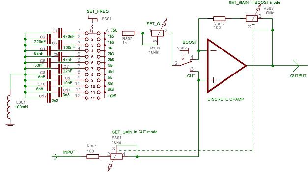

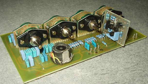

Hi all,
This is a simple parametric equalizer made with an inductor and a set of capacitors. It is a simplified version of a more complex parametric equalizer shown below...
MOX_EQ

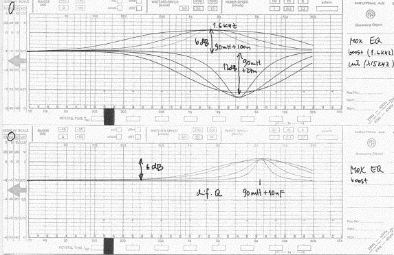

The simplified equalizer uses standard parts, which are easily available. Certain characteristics of the simplified version are slightly worse in comparison with the characteristics of the complex one, but this does not adversely affect performance of the equalizer in an active crossover (for which it has been designed).
The filter has been tested and works satisfactorily.

Good job, Jens!
I've seen that your layout uses dual in line sockets (single opamp?) instead of moamps' SIL for the discrete opamp.
This gives the opportunity to use standard opamps, but is left unclear if those who still want to use discrete opamps will have to make their own adapters or if you or tiroth are going to make a suitable layout in order to produce such pcbs also while we are at it.
In the wiki there was also a mention to regulators (Jung type): are you planning to make boards for them also or should we go with the group buys currently in progress?
