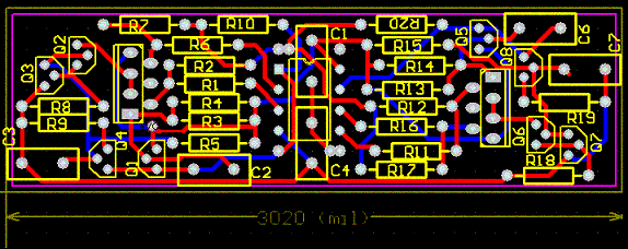

Thanks for pointing that out. The cost of a set of scored boards is less than I anticipated; it looks like a set of opamp boards (4)would be approximately half the cost of a MOX board.
I'll post a layout this weekend. If we can get >150 sign ups, I will order the opa boards too.

I just meant the relative cost. I'll post the actual number once the board is finalized and I have a (final) quote from the manufacturer. I expect this to be a two step process like other recent PCB group buys; #1 a request for sign-ups at an estimated price, and #2 payment after price is confirmed. (I hope the price goes down from the initial estimate--this hinges on the level of interest)
Andypairo said:My idea was that it can be nice to have the discrete opamps with PCBs of the same quality of the main PCB, but only if it can be done at a "right" price.
Andrea
Andrea,
I've completed a layout and created a thread to discuss. I would welcome your comments.
http://www.diyaudio.com/forums/showthread.php?postid=369407
Thanks!

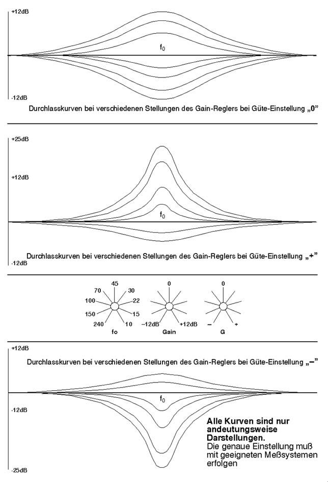

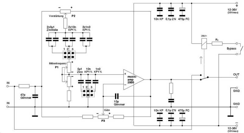

Hello,
I just found this parametric equalizer from THEL in Germany.
www.thel.de
It has no coils so this makes it very simple.
P1 adjusts fo with 3 different ranges with the jumpers there.
P2 adjusts the amplitude
P3 is the Q
Tell me what you think.

I have made a compressed file of the opamp showing Parts list in Word , Solderside in PDF , Component Side in PDF , Serigraphy in PDF so that everything is always at the good scale ( for DIYers 🙂 )I made all stuff with TCI so I have also .tci files 😉
The layout is made by *6 to engrave several ops at the same time so you can cut afterwards or save money on fabrication costs
Unfortunately the zip file seems too big to be posted here as an attachement...
I'll try , but if doesn't work mail me if you want to look at the files (if you want to build those nice opamps !!! Very nice ...)
