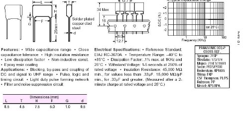

I am looking around for suitable Polypropylene or polystyrene capacitors for use in a customised version of the Mox.
Has anyone had any experience with the Panasonic P Series Polypropolene capcitors DigiKey Capacitors Part no P3103-ND used in active crossovers?
They are rated @ 50 volts and measure 8x4x7 mm, idea for pcb mounting.
The size and quality appear to attractive compared to large exotic capacitors. Altuallly I recall these are used in the Pearl RIAA Phono stage..
macka
macka
macka said:Has anyone had any experience with the Panasonic P Series Polypropolene capcitors DigiKey Capacitors Part no P3103-ND used in active crossovers?
macka
I used them as bypass caps/ input caps in amps and I love them. They all measured the constant same values within 3% of stated spec. Good external quality look and feel. Highly recommended
Chris
