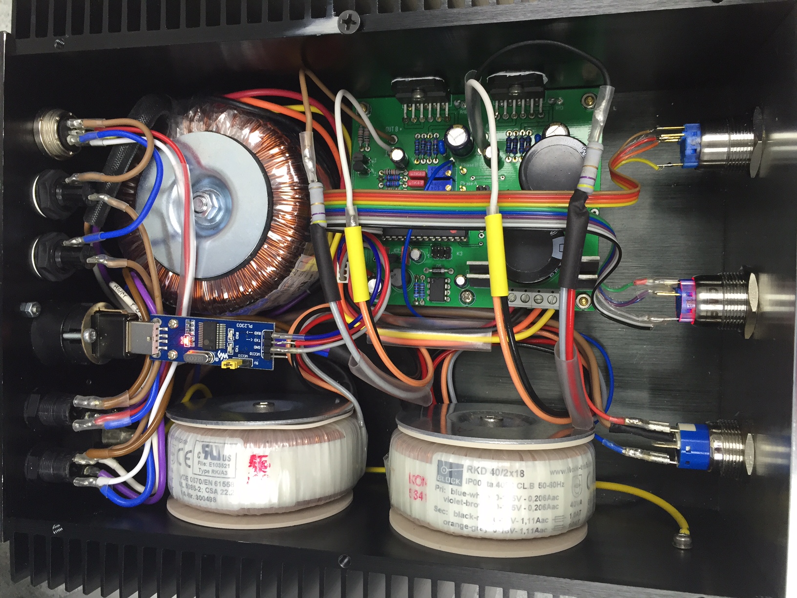

I've just completed my build based on Meldano's board. I used a transformer with two 25vac windings which proved perfect to drive a Rega 24v motor.
I'm really impressed with Meldano's software design and implementation. My Rega performs better and sounds better than the stock 24vac walwart. Top stuff... 🙂

Hi Andrew,
Whats the minimum and maximum voltage you can get out of the PSU.
I'm asking because I'm trying to figure what transformers I'll need to output 110V.
Does anyone know if 30VA be enough to handle the standard 250rpm premotec motors.
Thanks,
kffern
Hi Kffern,
The output voltage is influenced by the main psu transformer you choose. I used a 25v 25v transformer which allows two 24v ac outputs. From memory, there is only about 2 volts ac headroom if I crank the output to its maximum.
I was going to implement the controller with my original 110v motor but I read about problems in this forum when driving step up transformers with the chip amp. In the end I upgraded the motor to 24v which saved a lot size,weight and coat for the controller.
Kind regards
Andrew

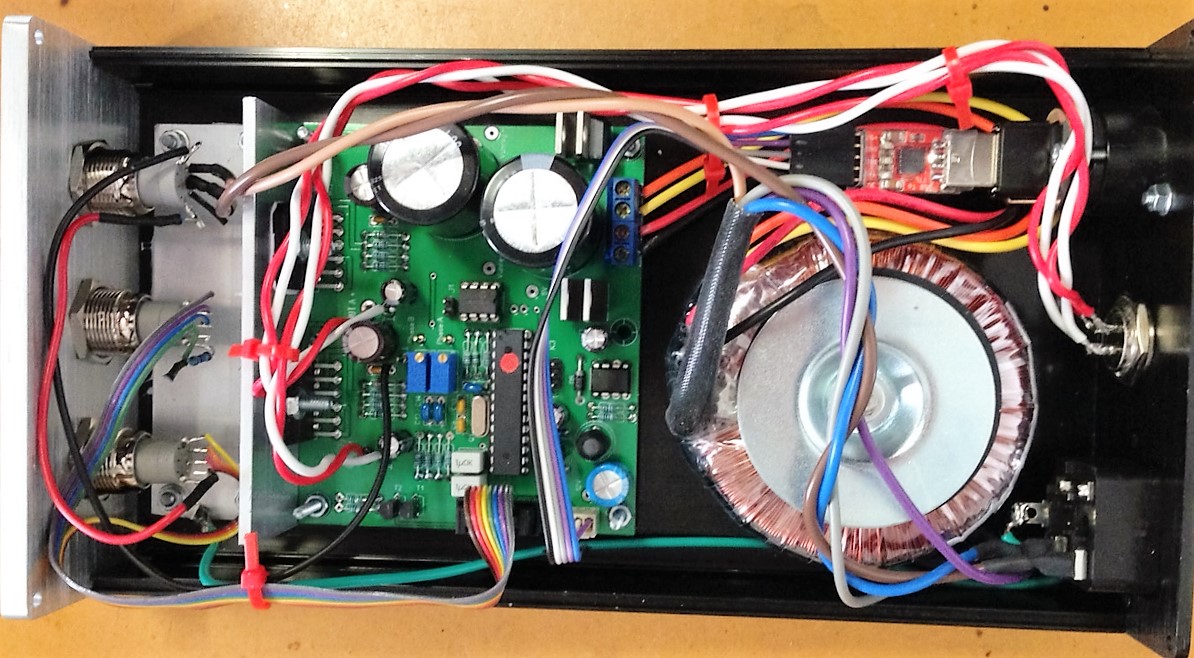

Finished building dual phase to drive 110V Basis motor
I just finished Daniel's dual phase controller and used step up transformers to run at 110V driving a Basis Audio belt drive motor.
Works really well and with Daniel's help I managed to transformers to get 110V contrary to what others have experienced.
