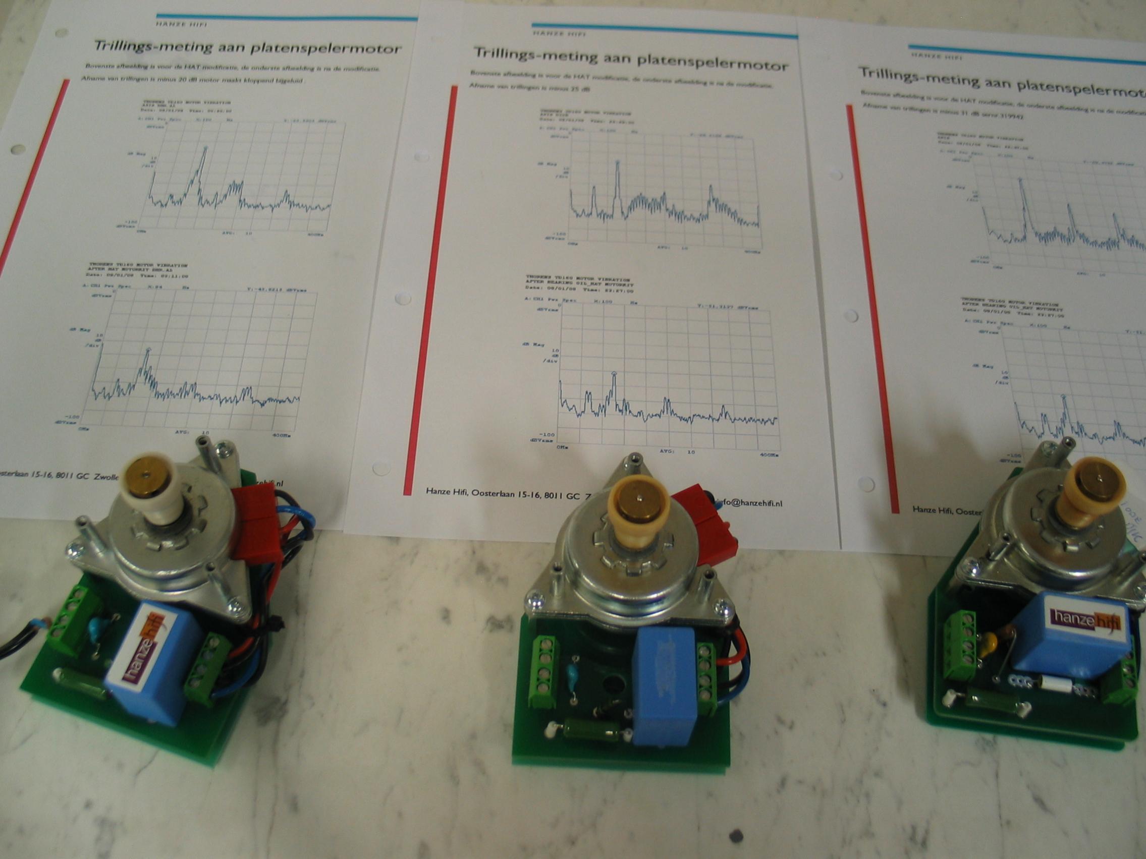

Yes all these motors are different I have done more then 250 Thorens TD160 motors for tuning on min.vibration some are the same but most times the phase cap need individual tuning. A two phase supply is the best solution.
