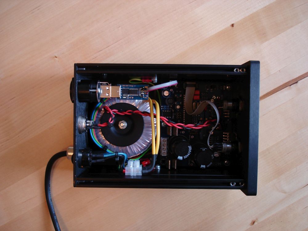

Yes I completed the chip amps for your dual phase almost at the same time. It works superbly although I have not had the chance to use it on the Basis turntable yet. Thus far I have only tested it driving the motor only and not the platter. What I love about it is that it uses DDS and I can use the Roadrunner to apply speed correction. Still have to find time to set this up.
I wired up my Basis Audio turntable motor with a switch so that I could flip from mains voltage to dual phase. There is a marked improvement in reduction of vibration with dual phase. Everything works perfectly although I have not played around with it that much.

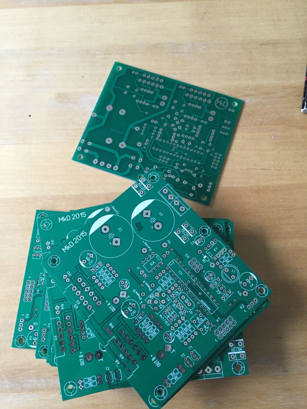

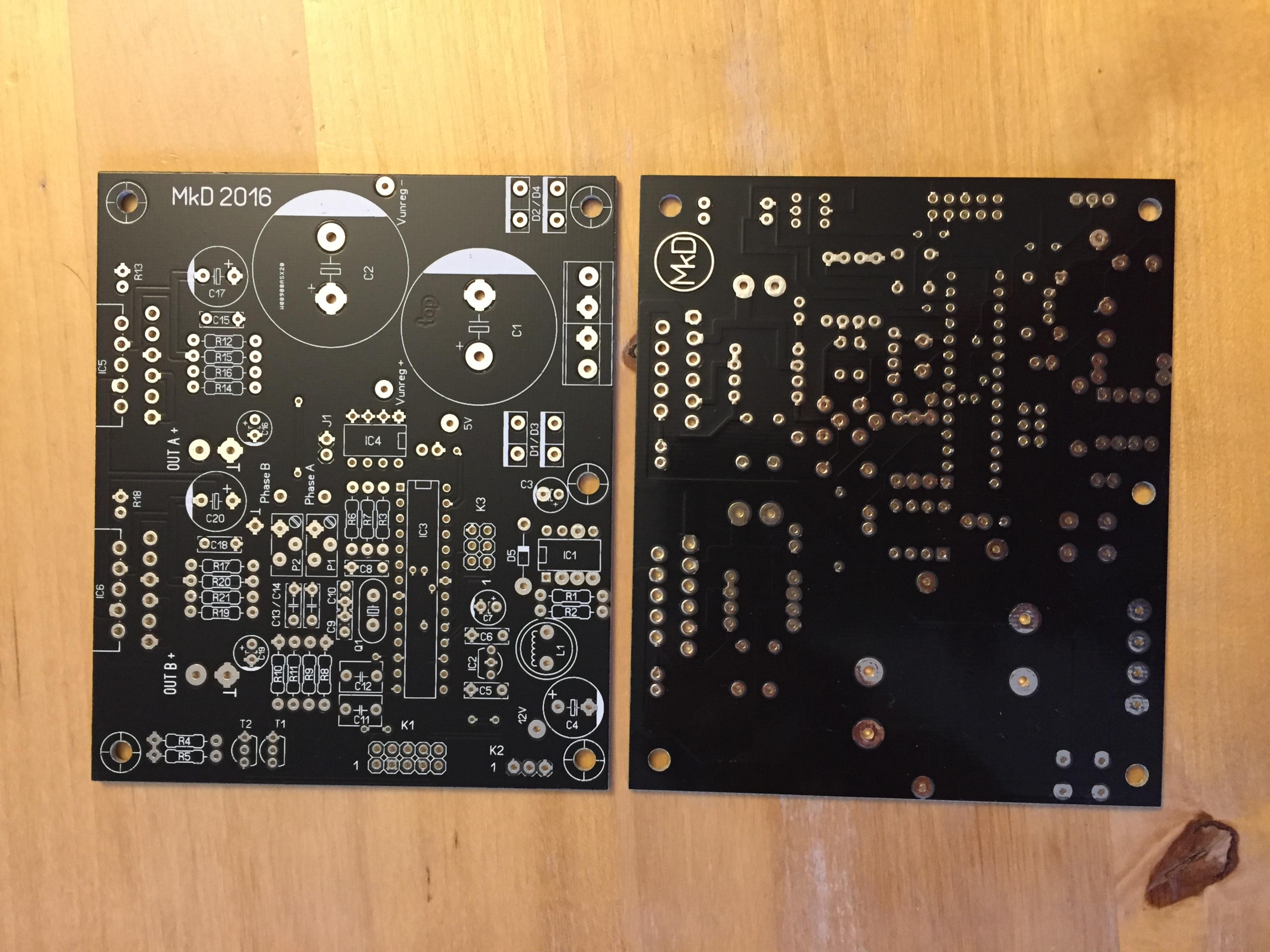

I have some boards and controllers left 😉
Send me a Message!

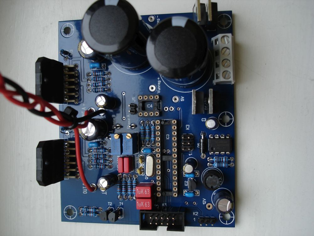

I just fitted a brand new rega 24v motor to my deck yesterday to use with one of your boards Daniel. Sounds very good- much quieter than the Project 18v motor was.
Could you drop me a link to the BOM, i can't find it anywhere and I have two boards to complete for friends next week.

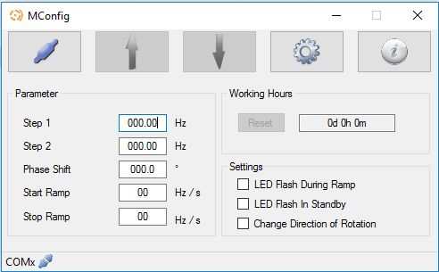

Highlights:
- Sinus and Cosinus Output
- Output xx-22V (adjustable with pot) with standard transformer and high voltage (115/230) with step up
- High Power Output with LM3886
- Adjustable phase shift between the two output phases
- Adjustable speed up ramp
- Adjustable frequence for two steps
- USB Configuration with PC Application (English or German)
- working hour timer
